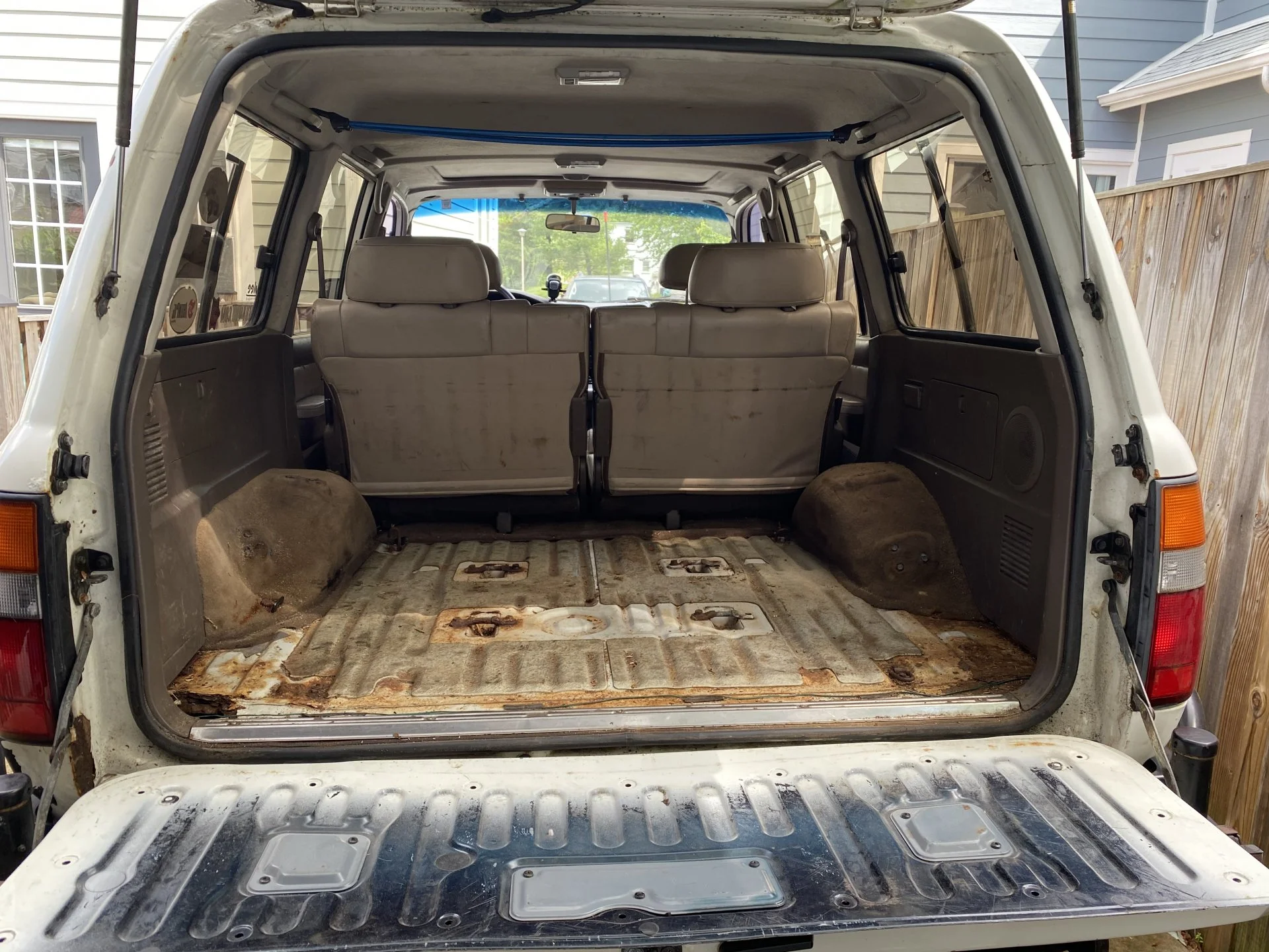

I am the proud new owner of a 1994 and it is my daily driver. This is my first official post to the forum.
I was wondering if anyone knows how to install a toddler and/or newborn car seat in a JDM 80 series. One is forward facing and one is rear facing.
I have these hooks on the end of a small strap attached to the bases of the rear seats (on both driver and passenger side) that look like they came standard but I can’t figure out how they would attach to or secure a car seat.

Your old ass rig was designed long before the modern child seat. If you have 3rd row seats and have no use for them use the anchor points in the cargo area for those straps. From this picture use the anchor points closest to the 2nd row.
seat-belts are stronger then the latch system anyway, they are now recommending to NOT use the latch system above 40 lb kids. the forward facing seat should have a top tether point attachment also though. either use the 3rd row attachment or get creative and make something to attach it to.
