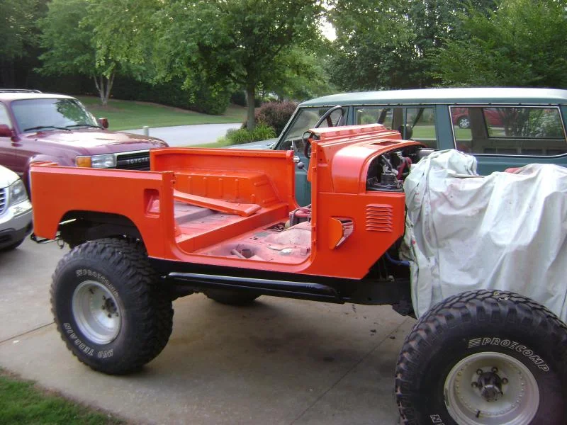

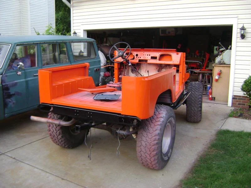

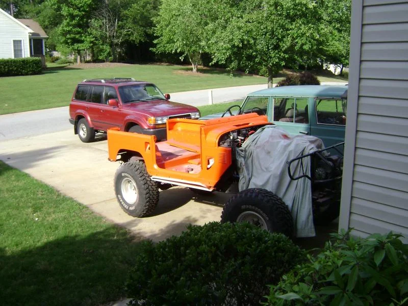

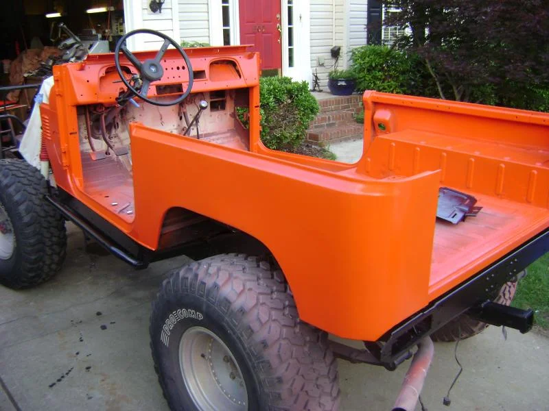

I got tired of the mold
Have you been happy with the way the dupli-color has been laying down?
I know at the price you have in it, it is awesome, just wondering if it is good or not?
thx, oh and awesome progress.... although I worry about your lungs.
X2, I am considering the paint shop white for mine since the original cygnus white has been covered with rustoleum white to cover repairs/trail damage. Did you just dump it straight into the gun? what psi are you shooting it at? How much as needed to shoot the whole tub (color and clear)?
It's okay. It's not the best. Better than rustoleum. It sprays like any other auto paint I've used. (which isn't much) I would say yes for the person not looking for a perfect paint job but wants something easy and that can be easily fixed later on.
