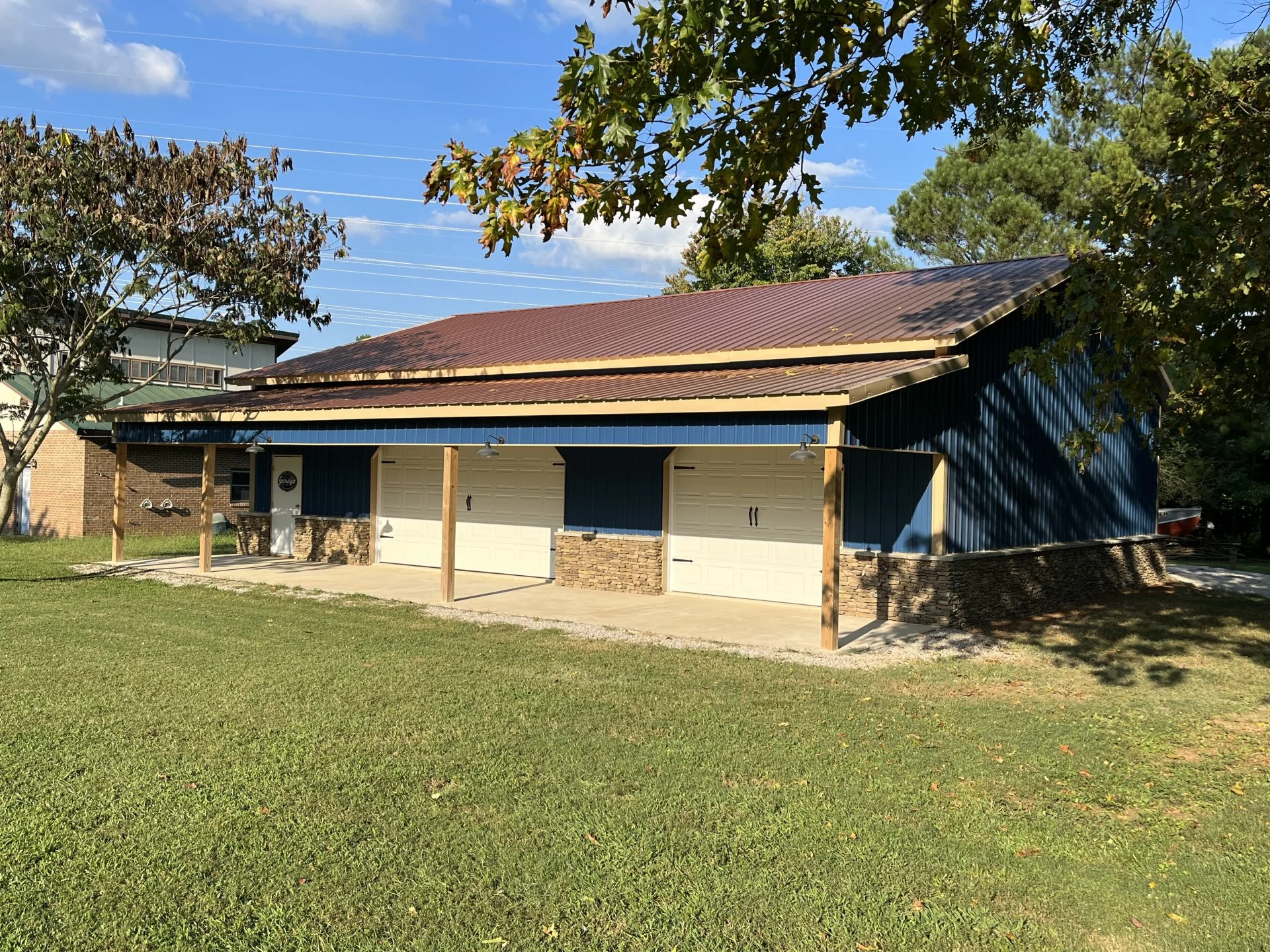

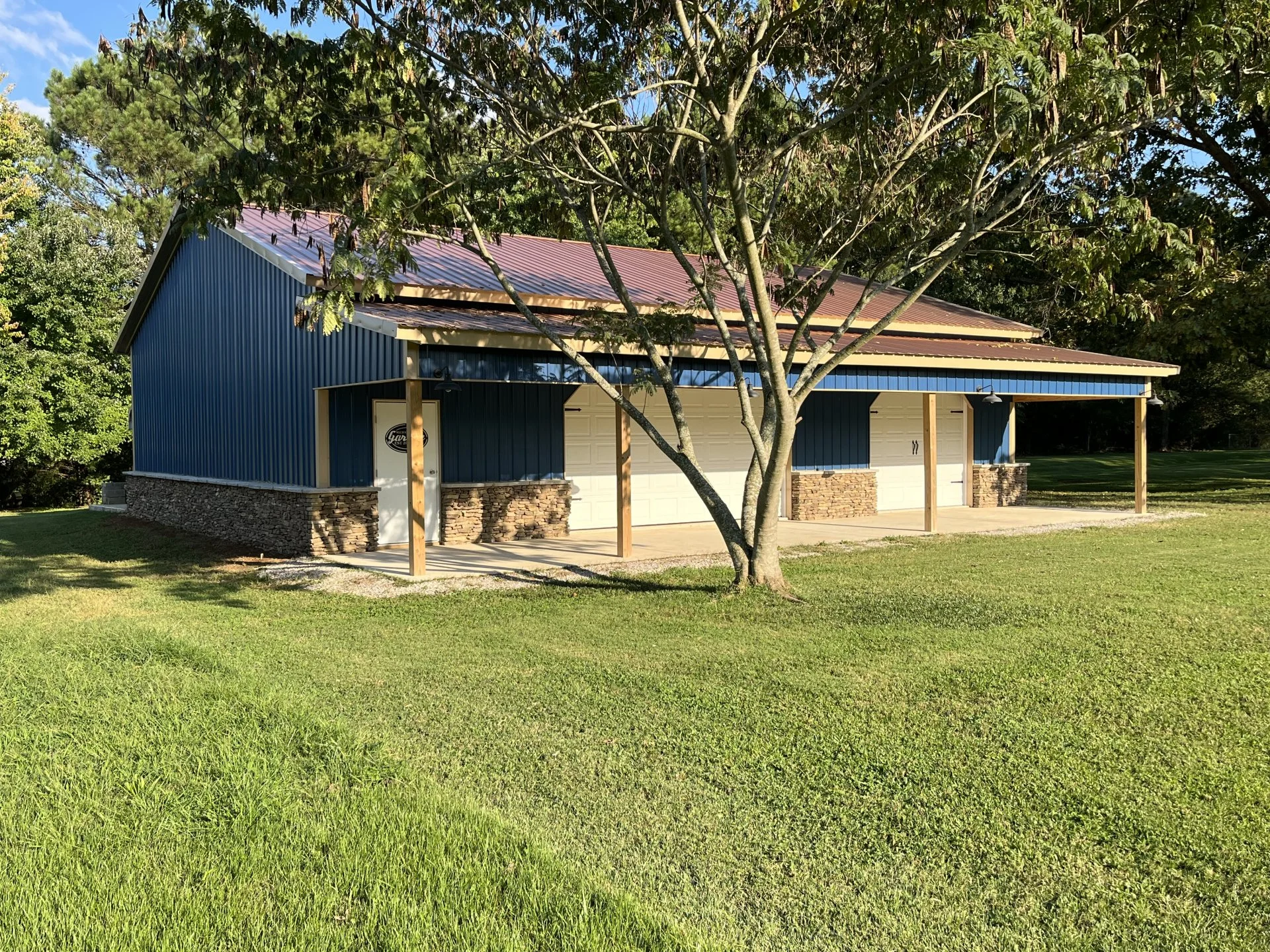

I finally get the shop I have wanted for too long
Always liked the stacked stone look. Given wheelbarrow and what looks like mortar on a board I'm guessing this is all mortared in and pretty solid when done.?
Thanks! Yes, they mortar the back edge.
I don’t even know what day we are on 🤷🏻‍♂️ I was out of town last week so there were at least two days the crew didn’t show up. Yesterday they knew I was coming home so they almost worked a full day and finished the job. I pleased with the end product.

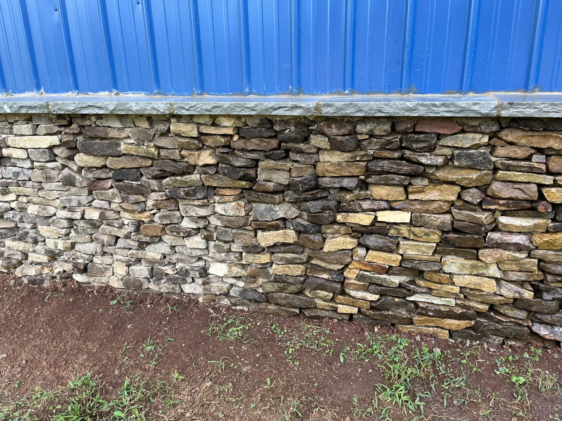

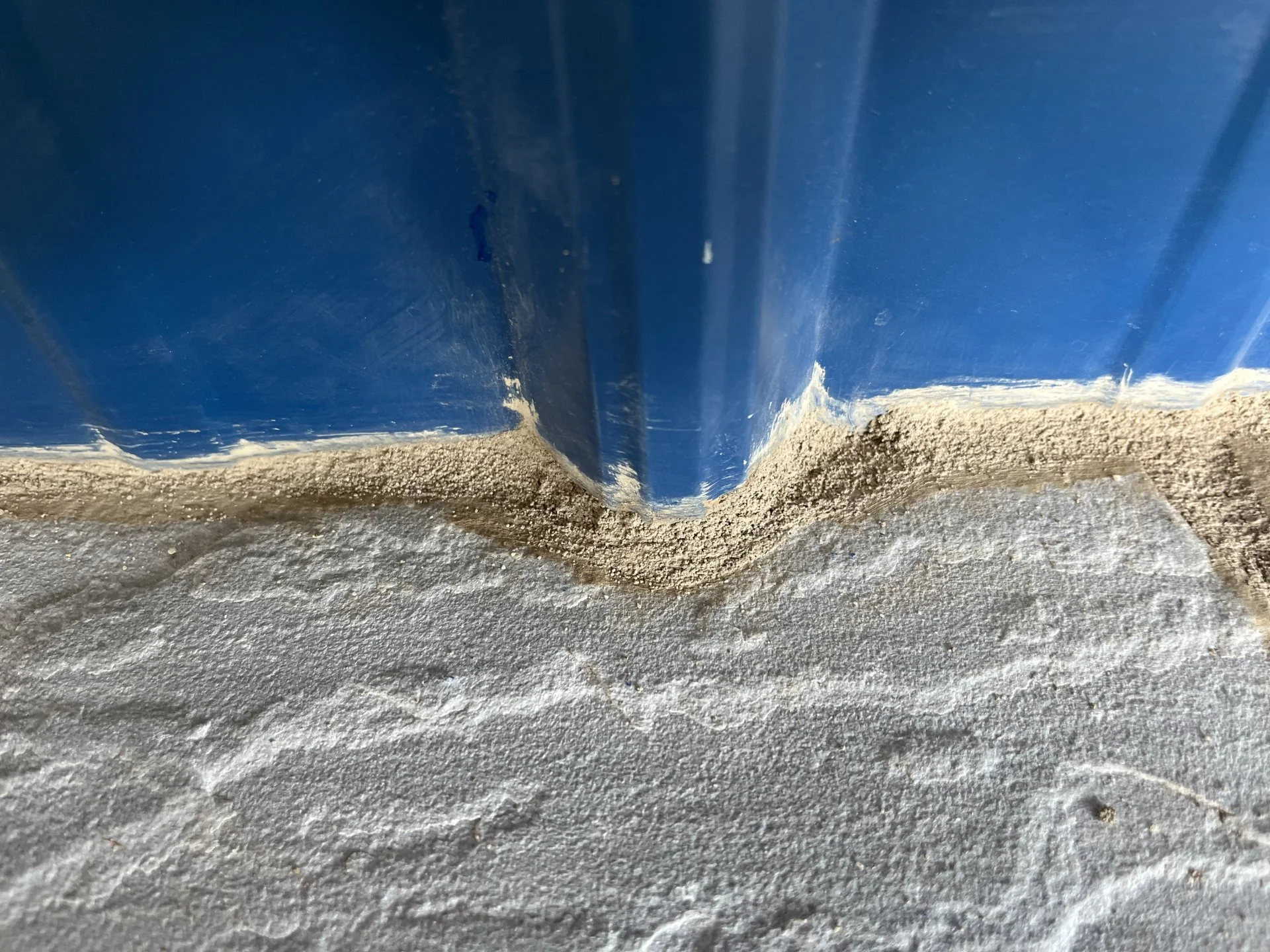

@Michael B looks TERRIFIC!….Congratulations on having the shop you have always wanted…. I feel the same way 1800 miles away. The stone is so sharp looking and adds a layer of style well above a work building. So my wrap-up question is….. did the cap stone get laid flat against the corrugated shape of the steel or get shaped accordingly?

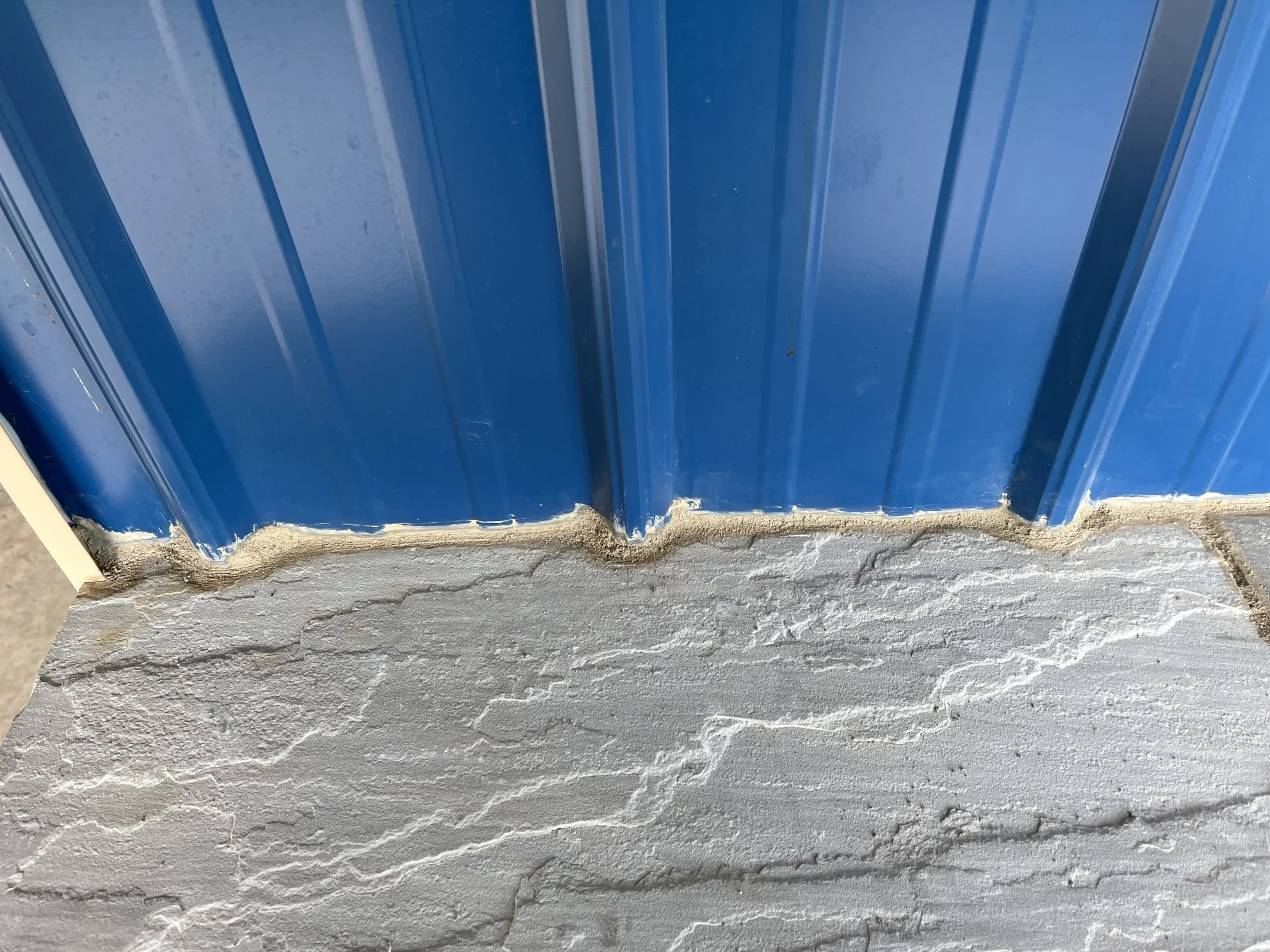

Thank you! I’m very pleased with the end result. He did notch the cap stone. I will get you a picture of that this afternoon.

Oh boy that looks great. Thank you for sending this…. They are obviously pros cutting these stone caps… if I do this…. I’m am happy that the 9 foot wide door trims the total length to a bit over 17’ only. I will be a few days away from starting this

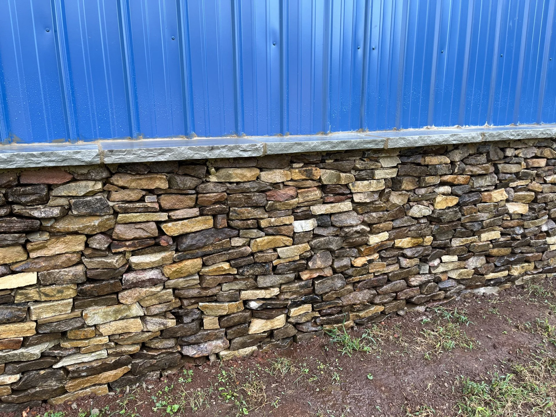

The stone mason recommended that a sealer be applied after about a week. We discussed different brands and I think I have decided which one I will use. So I decided to rinse the stone off since it was dirty when it arrived and there was dust from cutting the top cap on a portion of one wall. Wow! What a difference a fresh water rinse made!! The stone colors are very visible. It looks like a completely different wall. In these pictures the stone is still wet. But even when it dries there is a huge difference.

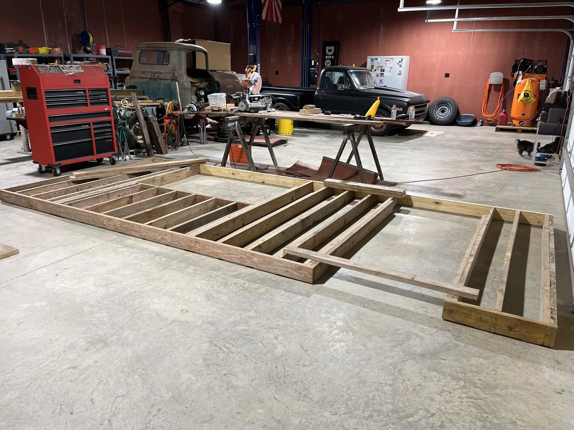

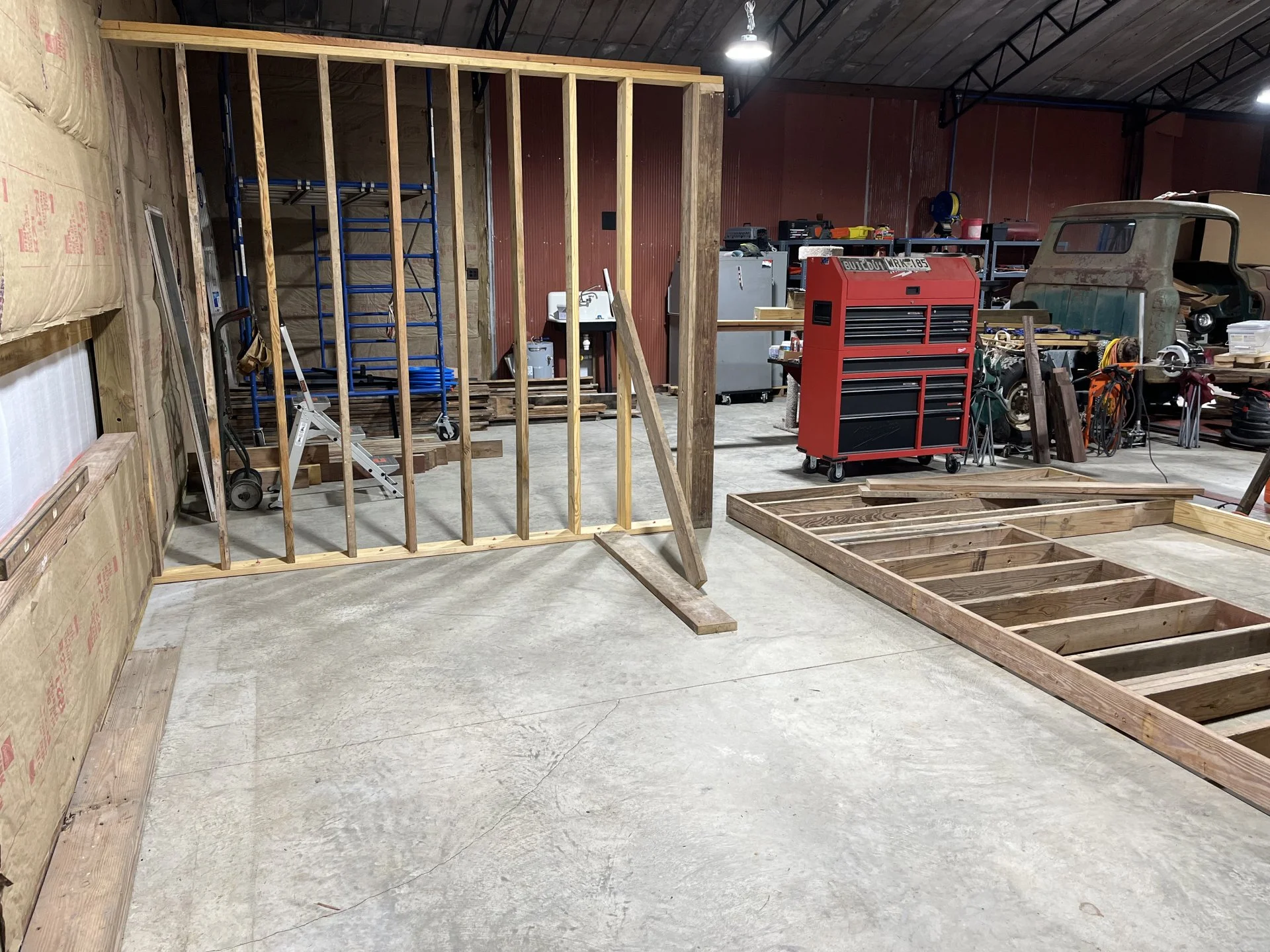

I had a few minutes this evening after supper so I assembled the short wall. After I drill 4 more holes I will be ready to stand it up. Of course my handy work has to be properly inspected.

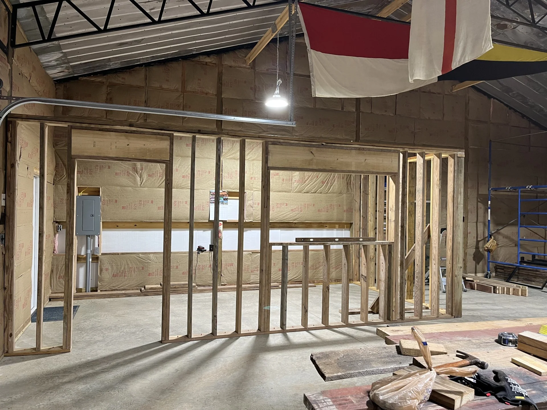

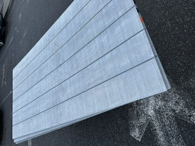

@Michael B any reason the stud are closer than 16” on center? i am doing something to cover the foam spray using these T-111 horizontally and peg board in some areas above
@Michael B any reason the stud are closer than 16” on center? i am doing something to cover the foam spray using these T-111 horizontally and peg board in some areas aboveView attachment 3122561
I went with 12” OC because of the mezzanine I’m building overhead. There will be no failure due to supporting structure. 🤓

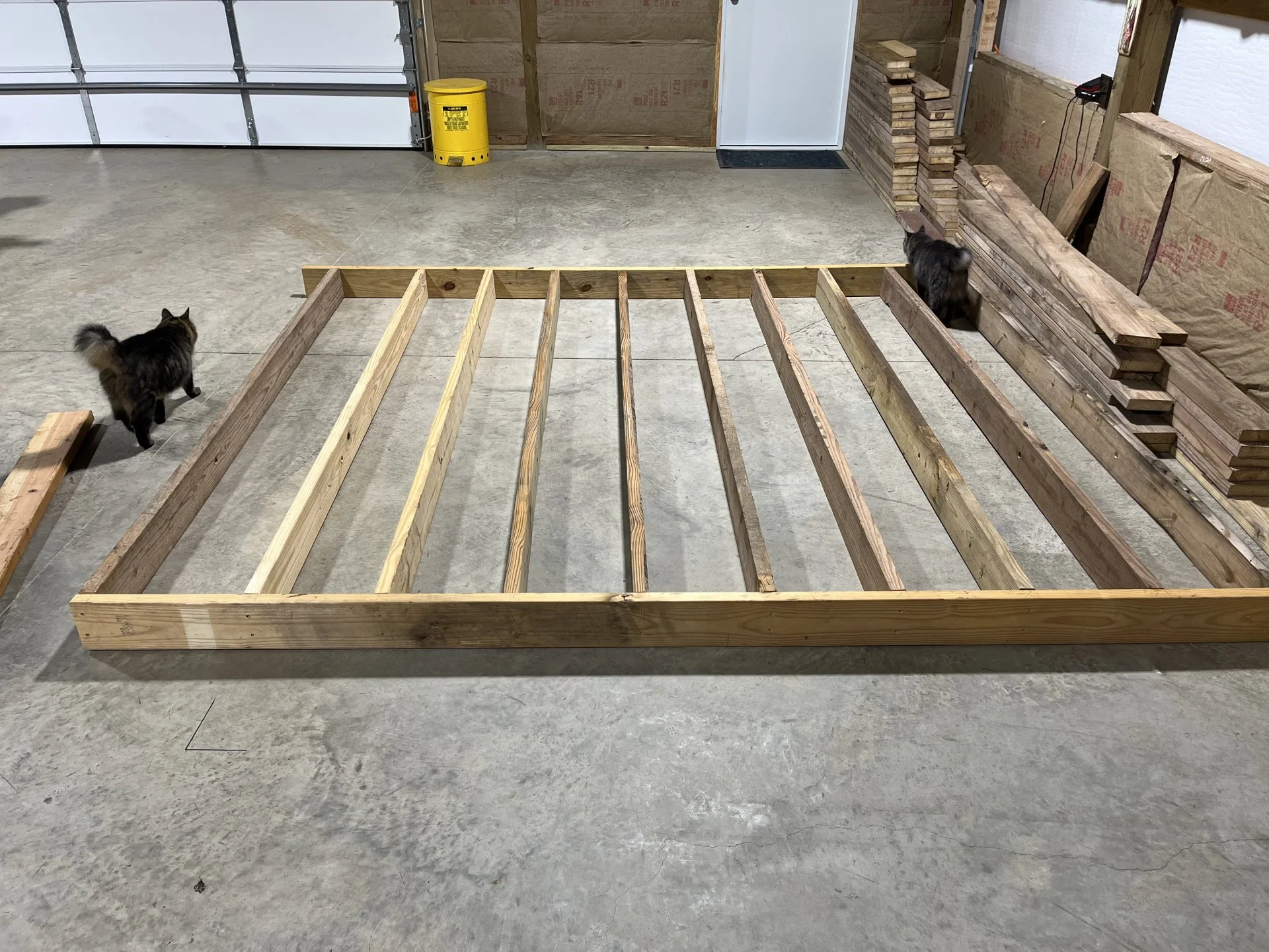

I had a rather productive weekend in the shop. If I had some 2”x12” material on hand I could have stood the second wall up. BTW I bought 1-2”x6”x20’ for this section of the project. Everything else was either leftover from the initial shop build or salvaged materials. There are 24-2”x6” studs in the two walls. Plus the jack and cripple studs. I’m also at the end of the 25 lbs bucket of 3” screws that I bought in January.

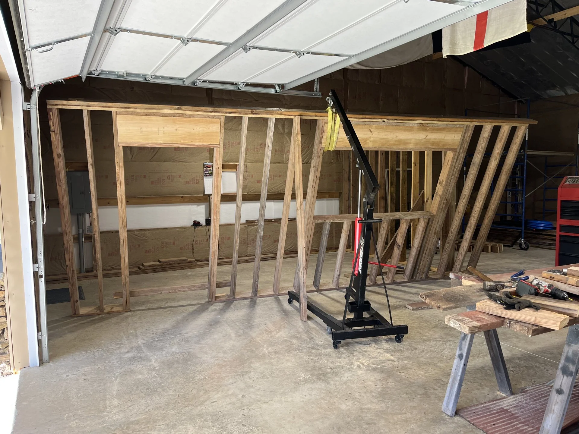

I had a productive day. First I applied a sealer to the stone. Then I installed the headers and top plate. It took about 2 hours to stand the wall up and move it into place.
