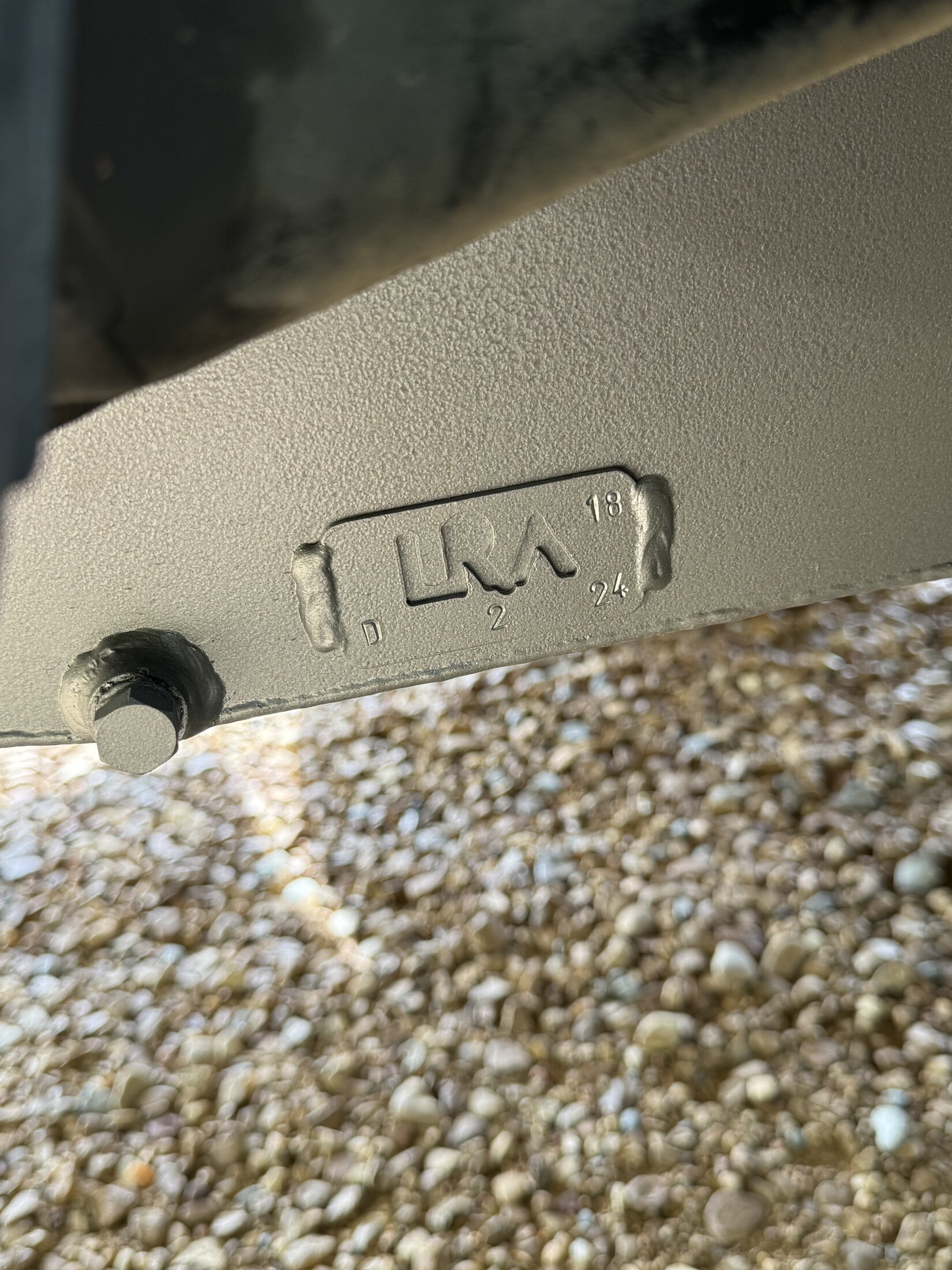

Also looks like @Ozark cruiser coated your LRA tank? Anything special he used on that?
Sorry. Yeah it seems like that guy uses the same stuff.
It’s not on mine I don’t think.
Oh I meant the black finish on yours. Mine came from LRA silver. Was just curious if Jason re-coated yours with something. Maybe they come from LRA black now.
It be silver

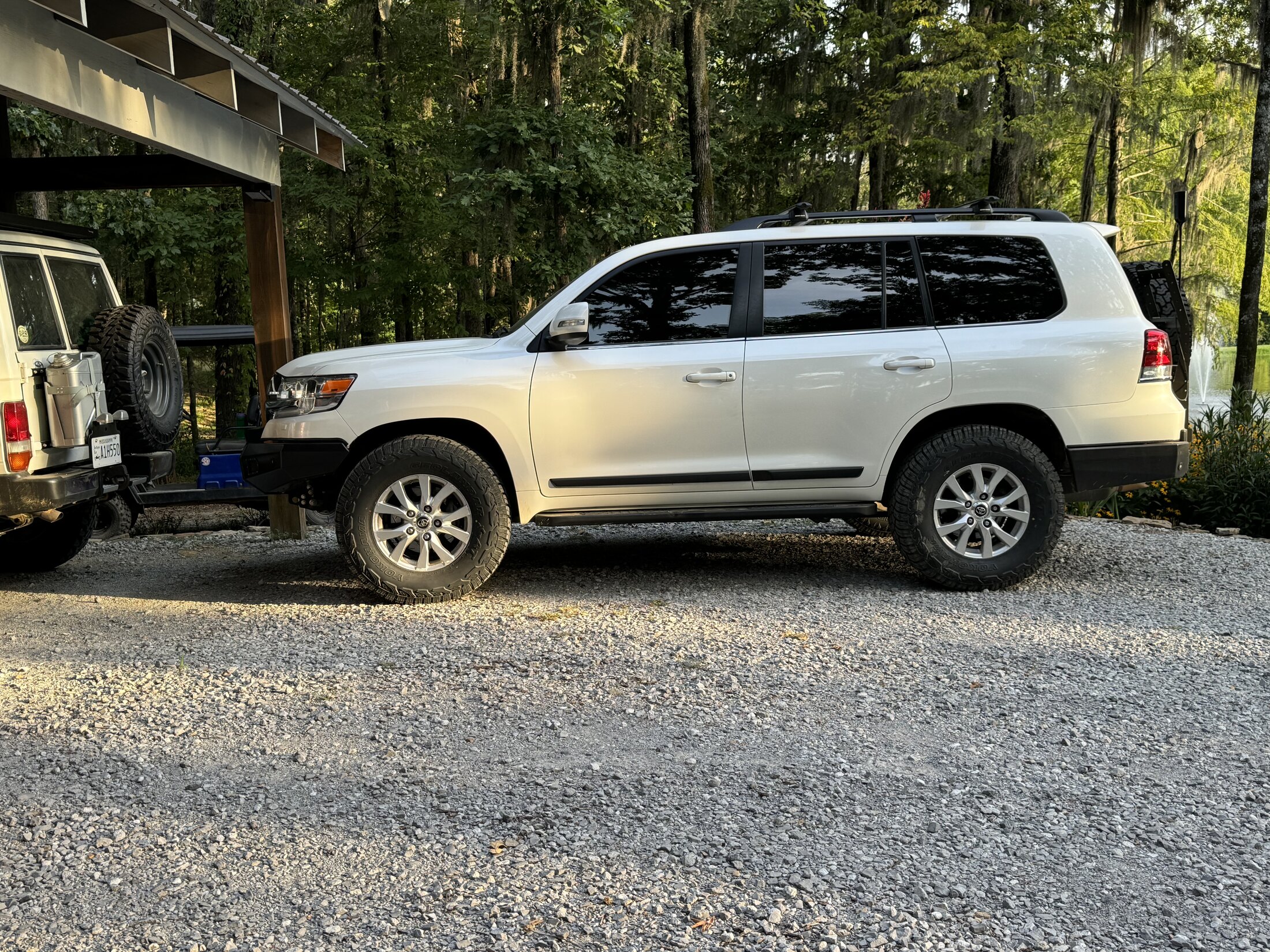

So I figured while I was doing all of this baseline work to my 200 is go ahead and replace my tires.
I’ve been running 285/70-18 Recon Grapplers. They are super quiet, work good off road but they don’t do much for me in the looks department.

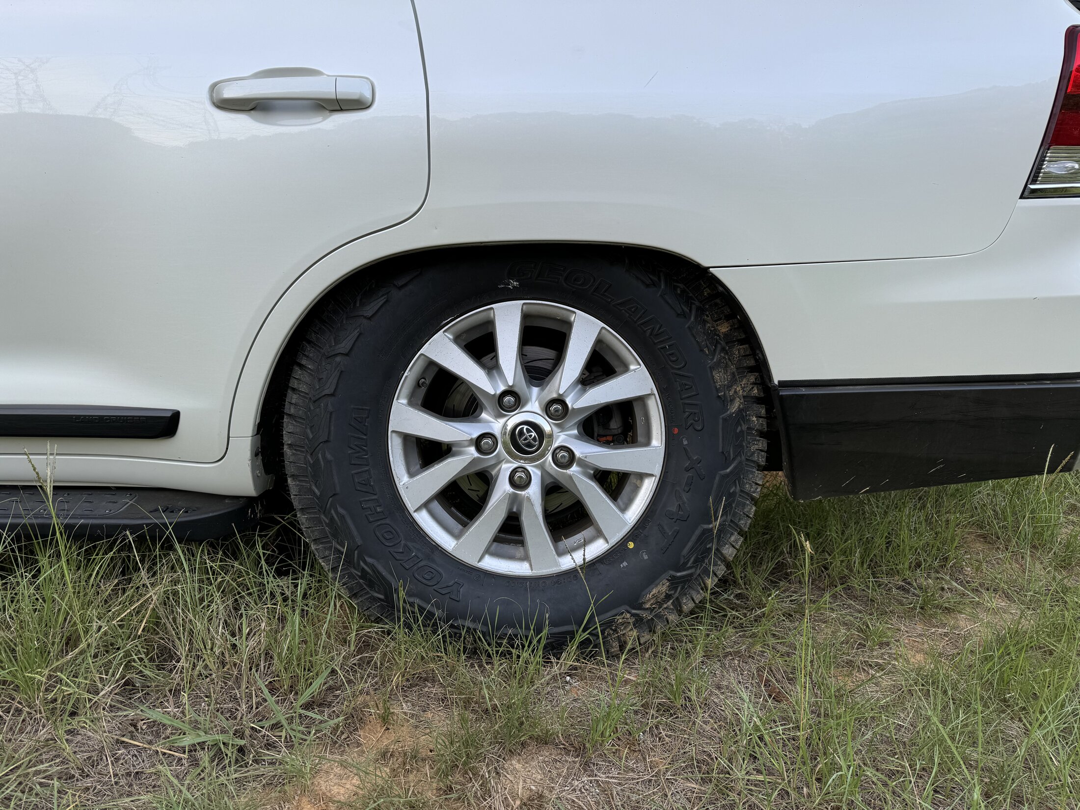

I decided to get a set of Yokohama X-ATs but I upped it one size to 295/70-18.
Well, true to Yokohama these things are way bigger than the ones they replaced. The specs said they would be .4 taller and wider but I think it’s more a full inch bigger.
They rubbed everything with no spacers.
Fast forward a week and the 1.5” Spidertrax spacers hit from Slee.
I tried them on today and the rubbing was worse. Mainly all in the front mud flap area.
I took them off and did some high speed driving over the rough powerline on my property and then twisted it up on my suspension spot.
I still have a tiny bit of rubbing at the bolts that used to hold the mudflaps. These things are big.
They look great. Hopefully I did not mess up with these. It’s wild because the 285s only rubbed a tiny bit on the front left backing up before.

How do your brand 35’s measure out? These being 34” true is about the size of most 35s I’ve seen.
Do yours rub?
Stick with em! You might try a 1” or 1.25” spacer. 1.5” is like 20mm effective offset. You’ll just have to see how close you get to the KDSS ram.
I put Spidertrax 1.25” spacers on. It is not hitting the KDSS
It did before in reverse with the 285s.
Do yours rub?
I haven’t measured my 35s loaded on the 200, but Mickey runs full size. Mickey lists them at 34.5 actual and 12.8 wide.
Mine will rub if your try hard enough, never enough to worry about though and it just polishes the KDSS. I’m on a wide wheel with bigger offset though. I cut my body Mount and trimmed the fenders nicely.
