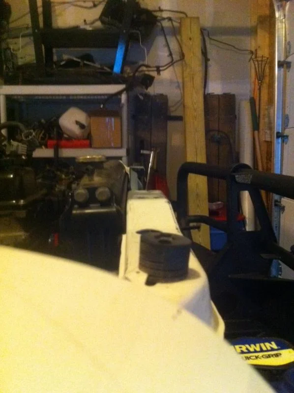

Thanks for the added info on the radiator. How much "Too Tall" is the 80's radiator? I guess I just need to put the hood on and see.
It looks like about 1" too tall? Would the hood clearance issue be solved by raising the body 1 1/2" or maybe even as much a 2"? Easy to do where I'm fabricating new frame brackets anyway. The downside to this would be how much of the 80's frame would be exposed under the already high sitting appearance of a 79 series bed. Which looks even higher on an 80's frame. The added clearance would make tucking the cats up higher easier, more room for an over the frame exhaust and more room for sliders.
This "maybe" would allow me to keep a radiator that I know is designed to cool the 1FZ. Raising the body would move any mechanical fan lower from where it should be, which would not be an issue if I did run the Mark VIII electric fan. Just thinking of options. If a new radiator does need to be made mine will have to account for the transmission cooling lines that run into and out of it as I am keeping the stock 80 series engine and auto transmission. I am not opposed to a custom radiator, I just want one that will cool the 1FZ and have the transmission cooler built in.

I'll work on putting the rest of the front clip and hood on before I make a final decision on the new frame mounts. And see just how much higher I have to go to clear the radiator.
I think it was about an inch that it misses by. Stick the other fender and front clip on. I'd like to see what how it looks with the 80 series arb bumper. Still tryin to decide what route i'm going with the front bumper.

I was able to get the other fender on today as well as the hood and check the clearance on the radiator. The radiator fill neck does hit, but not by much. I'm thinking a 1" body lift will give me enough clearance, but will go with 1.5" to account for any body/frame flex.

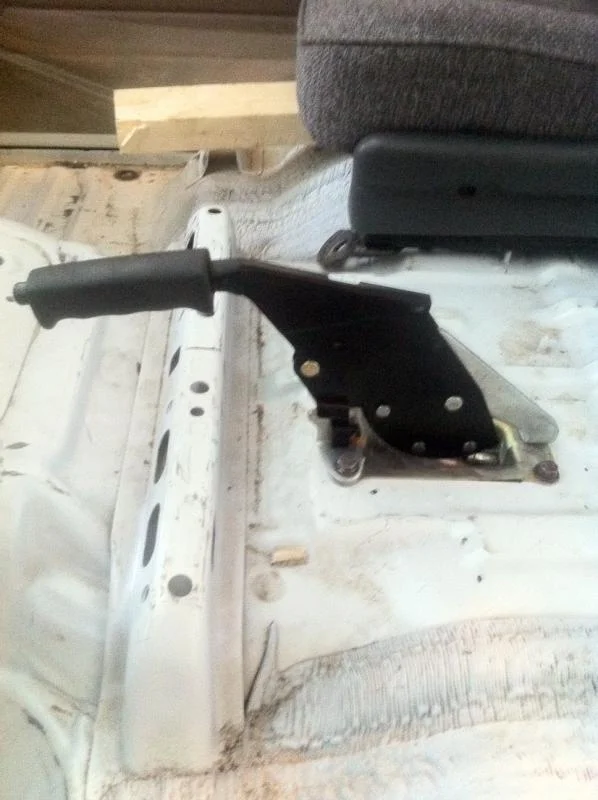

80 Series parking brake is a direct bolt in.

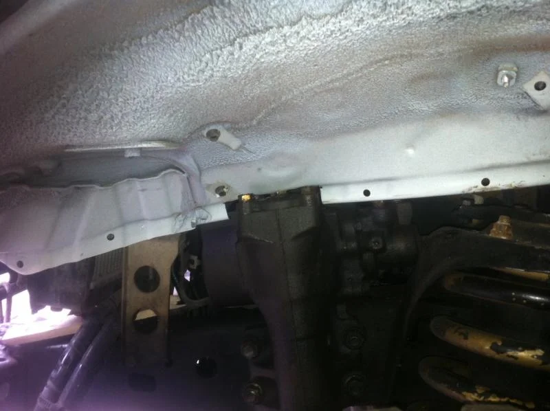

Pics of where I had to clearance the inner fender.

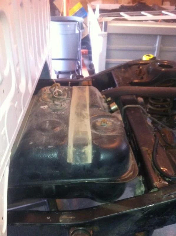

Still not sure on what I'm going to do for a fuel tank. The OEM tank rotated 180 degrees looks like it might just work.

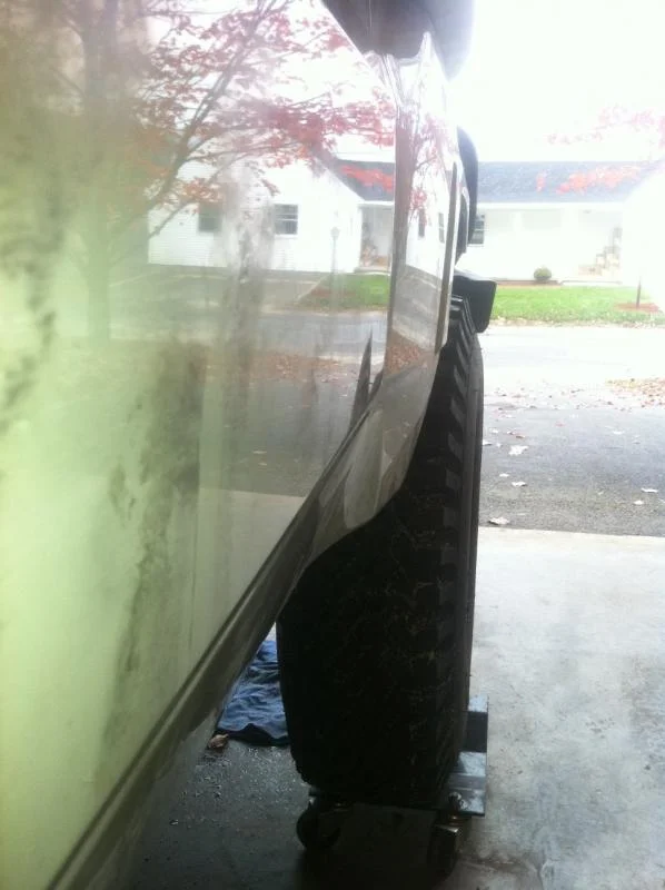

The skinny 9.00x16 STA's tuck in under the front fenders nicely.

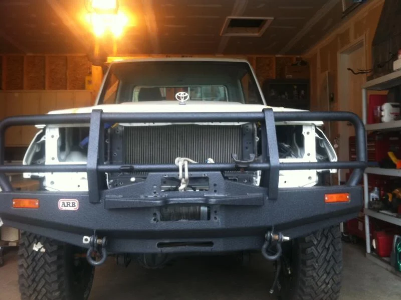

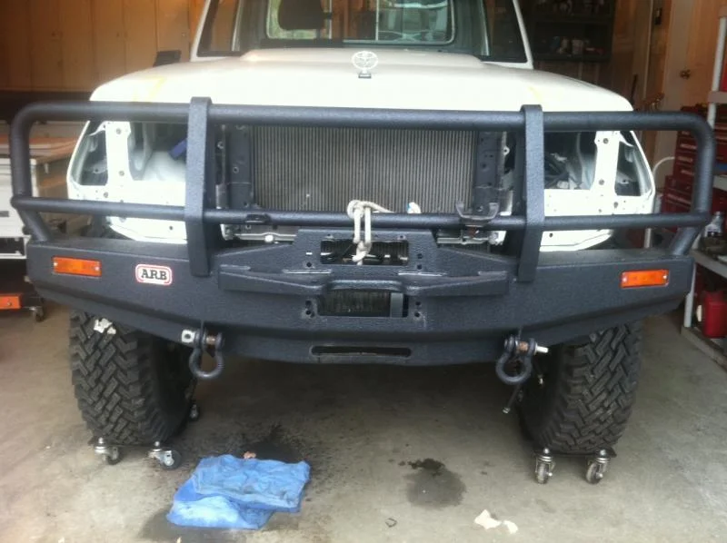

And what an 80 series ARB looks like on an 80 series frame with the 79 body on top of it.
No wide tires. I like tall and skinny.

The 80 tank looks great from the top view ,
how is the tailshaft clearance with the tank
