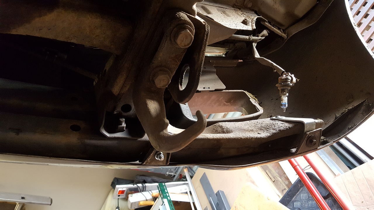

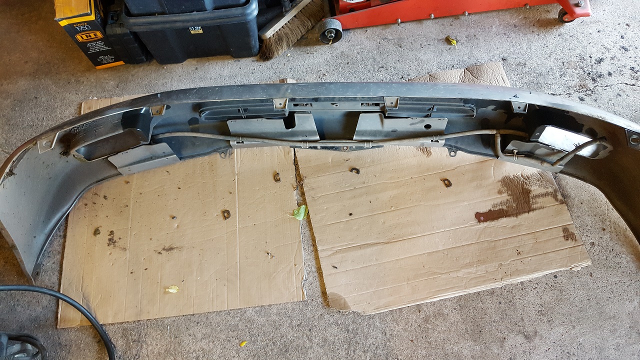

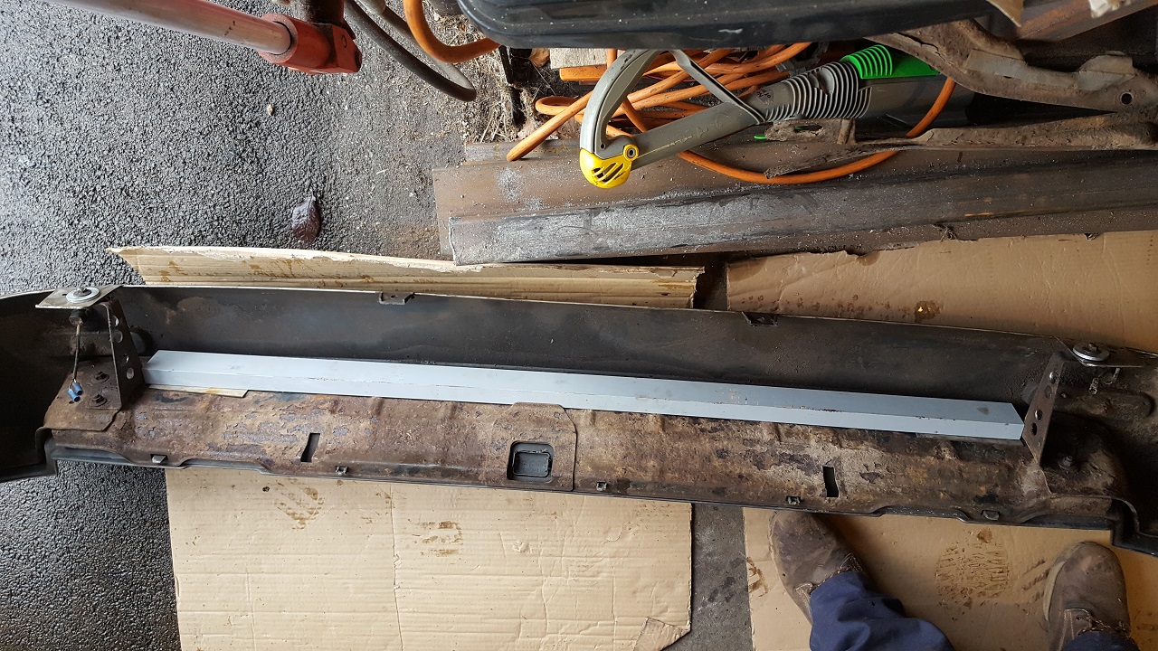

I installed another 25mm body lift recently and was able to modify front and rear OEM bumpers to fit in the new position.
For the rear I drilled new holes in the main brackets 25mm lower, removed the metal section that runs along the bottom of the bumper and riveted some 25x50mm aluminium box section on to support the step part of the bumper. For the front I removed the metal section that runs along the bottom of the bumper, trimmed the mounting tabs and used strips of stainless steel to bridge from the tabs to the original mounting holes.
