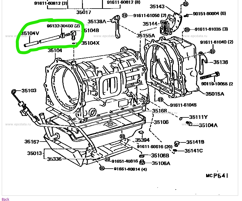

There is a drain plug to remove the transmission fluid. New fluid is added through the dip stick tube. I'm not sure why it won't go in. I suppose the tube could be bent or crushed, but then I would expect that to also interfer with the dip stick itself. The diagram below shows the location of the dipstick tube. Maybe you can do a visual inspection.
There is also a breather on the top of transmission near the front. I suppose if this is blocked then that could effect putting more fluid in. The breather plug (35140B) will probably be hard to access with the transmission installed. I don't know where the loose end of the breather tube would be, but you might be able to find it.

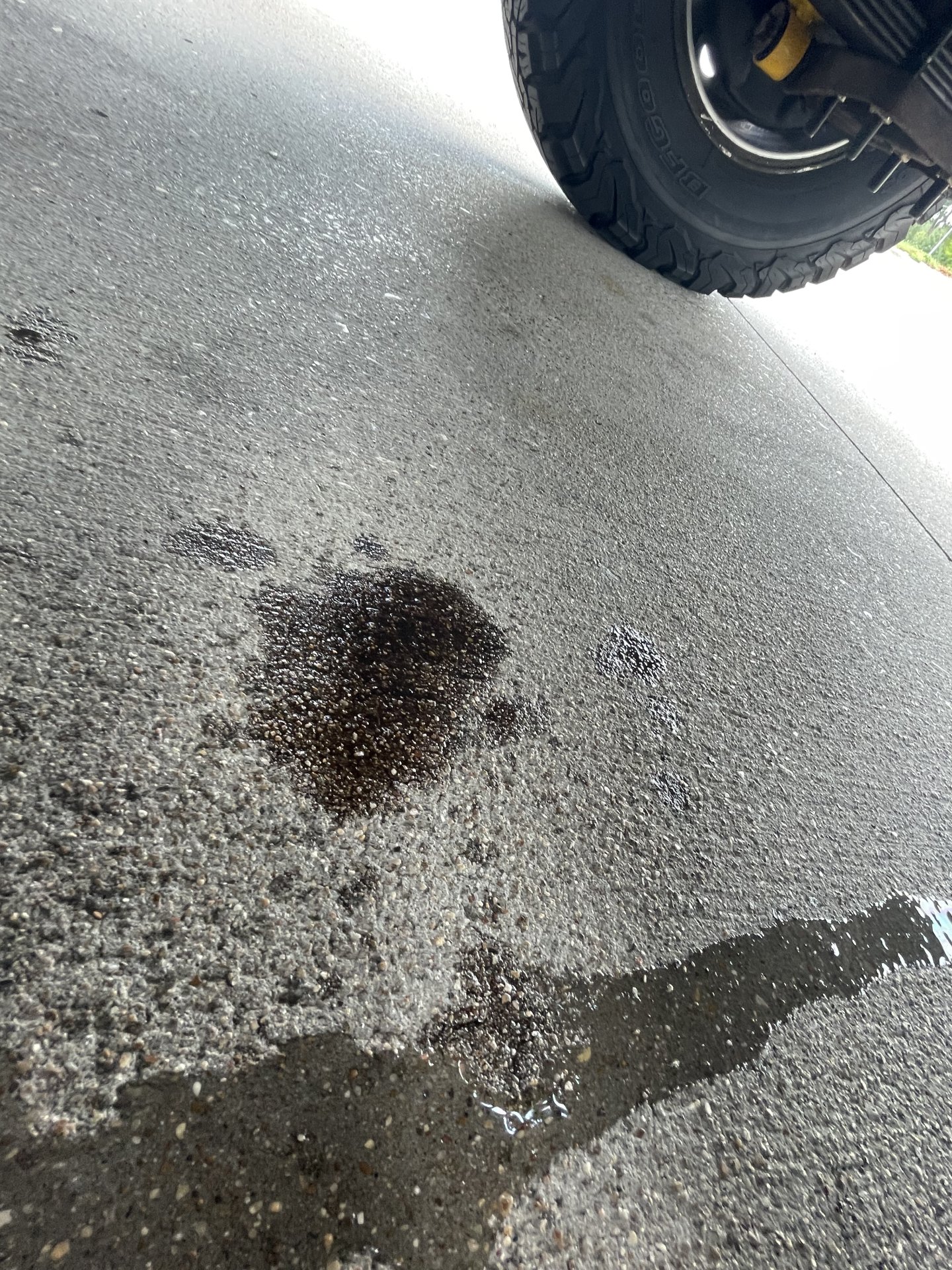

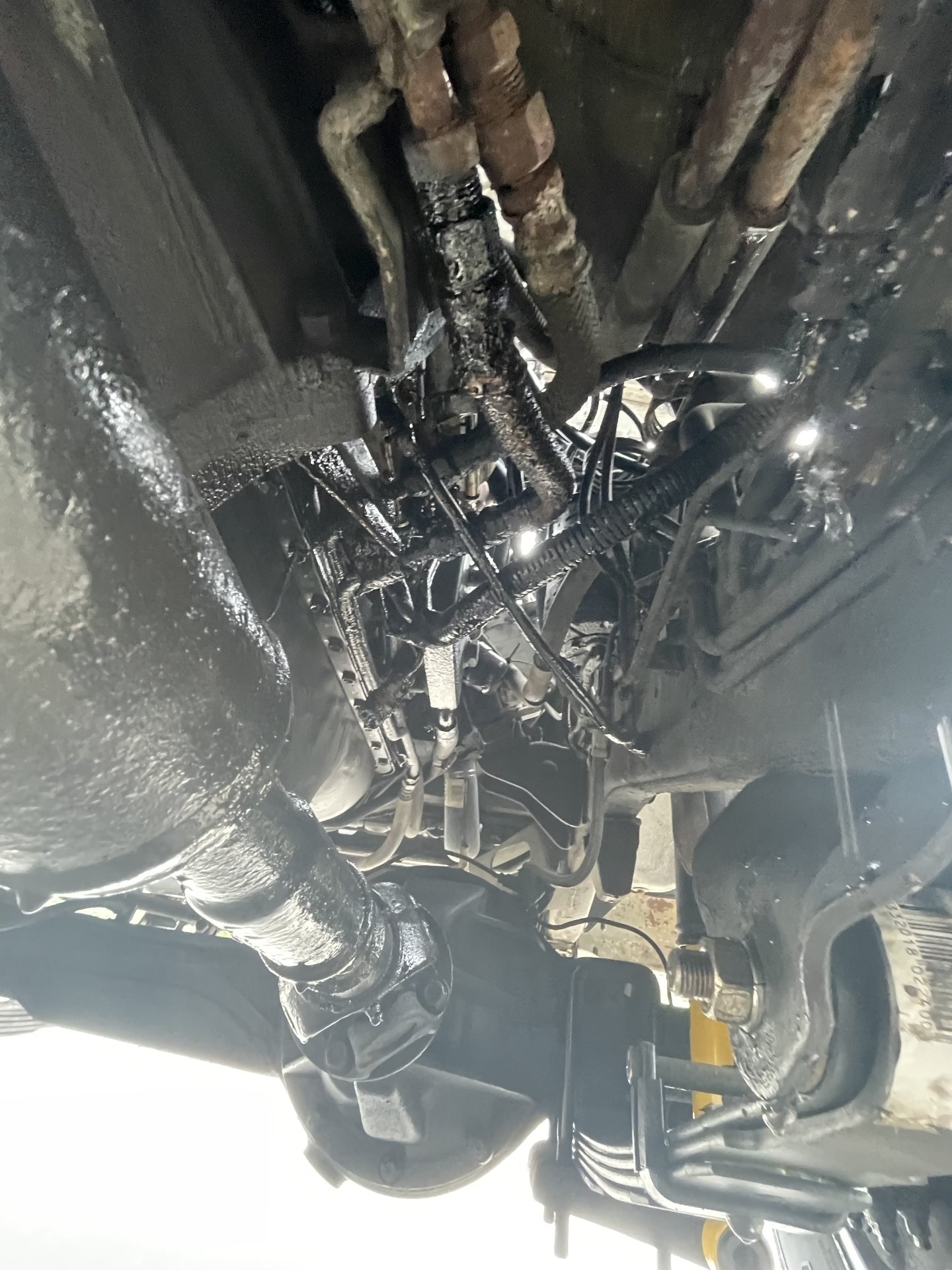

I noticed a lot of lines below the dipstick were super wet so definitely a leak. I think I am going to try to add some fluid a little later. It should be noted, as I drove it today, it had zero issues in shifting like it did a couple weeks ago. Idk what’s going on with it

Yea some front seal for the transmission I believe. The undercarriage is super gunked up and a lot of it is fresh.
Decrease everything for a better look. Definitely leaking but from where?
