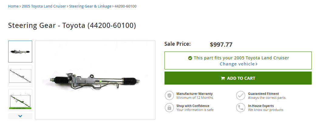

See post directly above. It looks to me like that's not their online store, and it looks like that part number is superceded. It doesn't matter at all to me, but I'm trying to help someone save a few hundred bucks.
OP, cancel your order and look at the post above.
Just wanted to show where I got the number. I didn't want you to think I made that up.
Oh, haha. Fair enough. Sorry for being grumpy!
I know my local car dealers seem to have outward facing websites with cheeper prices, but I can't order from them and pick it up there. It seems like they firewall the inward and outward facing prices so people can't get a discount when they're buying parts in the service department, but they can still get a slice of the online market.
When I bought my cooling hoses and Tee last month, they were running Free Shipping over $75--- checked their website today to buy my rack and the free shipping was gone. Timing is everything.
Make sure you're on the parts.salinastoyoya.com site. That's what I see right now when I look at it
