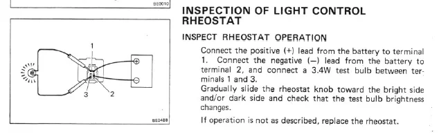

Checked all the fuses, they are good
Thats odd, the lighting comes out of the rheostat for all of those bulbs.
This is kinda the only thing in the FSM i can find on testing the rheostat

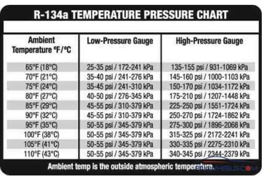

Looked through the AC section but didn’t see. How much r134 did you put in? I got two cans but not sure how much to add
When i charged the A/C on my stock 60 it took a little over 2 cans. I think 2 is a fine starting point.
Mine took a little under 2 cans with stock everything (except the compressor, obviously. And my lines are pretty short compared to what I have seen other folks do). Low side pressure was good, so I called it. Been working fine since.
What’s your metric for enough? Just won’t take more or a particular pressure?
Well I filled it with about 2 😆, low was around 55 and high was 200 ish.
It’s 95 out and it blows 48 out of the vents, good enough for an old truck!
Told ya lol not saying that the chart isn't right just more of a guide. I've been doing home and car hvac for 20 years off and on. You can make it as complicated as it can get. Trouble shooting is problems can get more in depth. Me I pressure test with nitrogen and a spray bottle with a little dawn and watch for bubbles I don't add die or sealant crap into the system. Pull vacuum then add factory charge back I've seen lower numbers than what you have that being said all the ac components were brand new.
All my stuff is brand new. I’ve never really got a true temp reading but I’m all ears for lower temps. Did you basically do it just like a fj62?
Replaced evaporator coil condenser coil pressure switch the valve in the evaporator coil air box new accumulator all new duct seals basically rebuilt the whole system mechanical fan with fan shroud I'd have to go back in my ig to see the temperature I had but it was cold fogging front and rear door windows. Oh also the ac Amp mod
