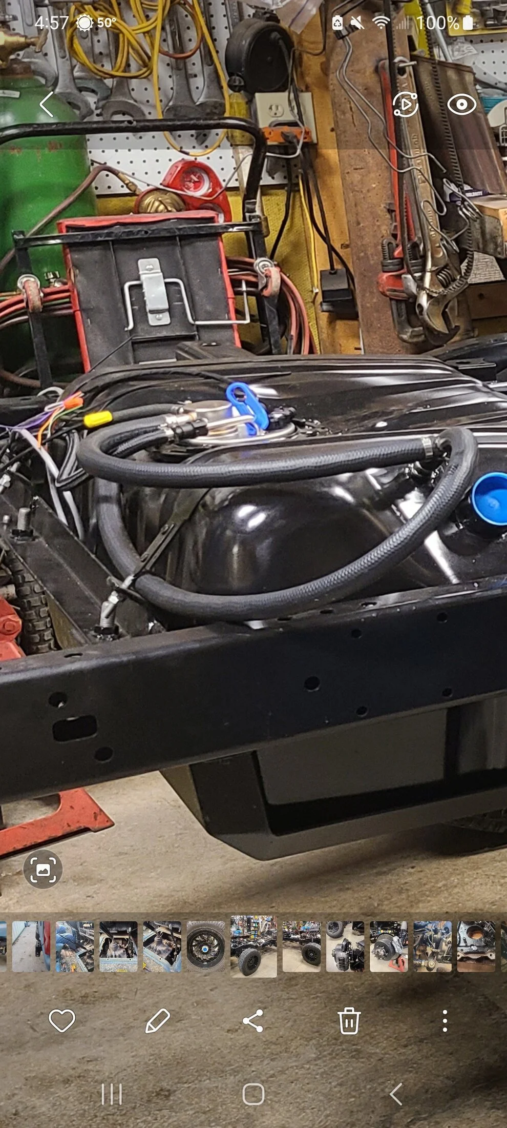

Here are some pictures from my setup.
Fuel rail. Notice the gen 3 fuel filter regulator on the fuel rail. Also the lower return line is the stock fuel hose modified and the upper is a -6 line with 2 AN fittings.
Once your hose is built and your filter and pump are mounted you can tighten all of your AN fittings, and reuse the threaded holes in the frame to secure the fuel line with Adel clamps to the frame. You might have to share a bolt with some brake line for some of the brackets. There are plenty of threaded holes under there.

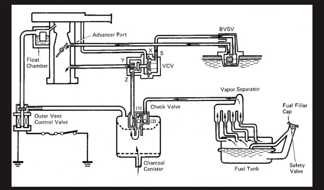

What's a method or device to take the place of it? I have used an alternate method of storing and delivering fuel. 🤪
I do still have the oem whatchocallit , but I don't remember how to plumb it. And had forgotten about it, actually. If I remember, there was a hard line that went over to the left wheel area and back.
Would that be something that would work with a chevy fuel pump setup?
You can see the vent on this tank, but it's huge compared with the cinnections on the oem toyota device
Vapor separator. See pic of how it is plumbed.
There is a short section of fuel hose in between the hard line that runs up to the vapor separator and the hard line that runs up the fuel rail to the engine. Its about 4 or so inches long. That is where i am going to plumb in my charcoal canister @ceylonfj40nut. just make a bracket to attach it somewhere back there and you wont have to see it in the engine bay
