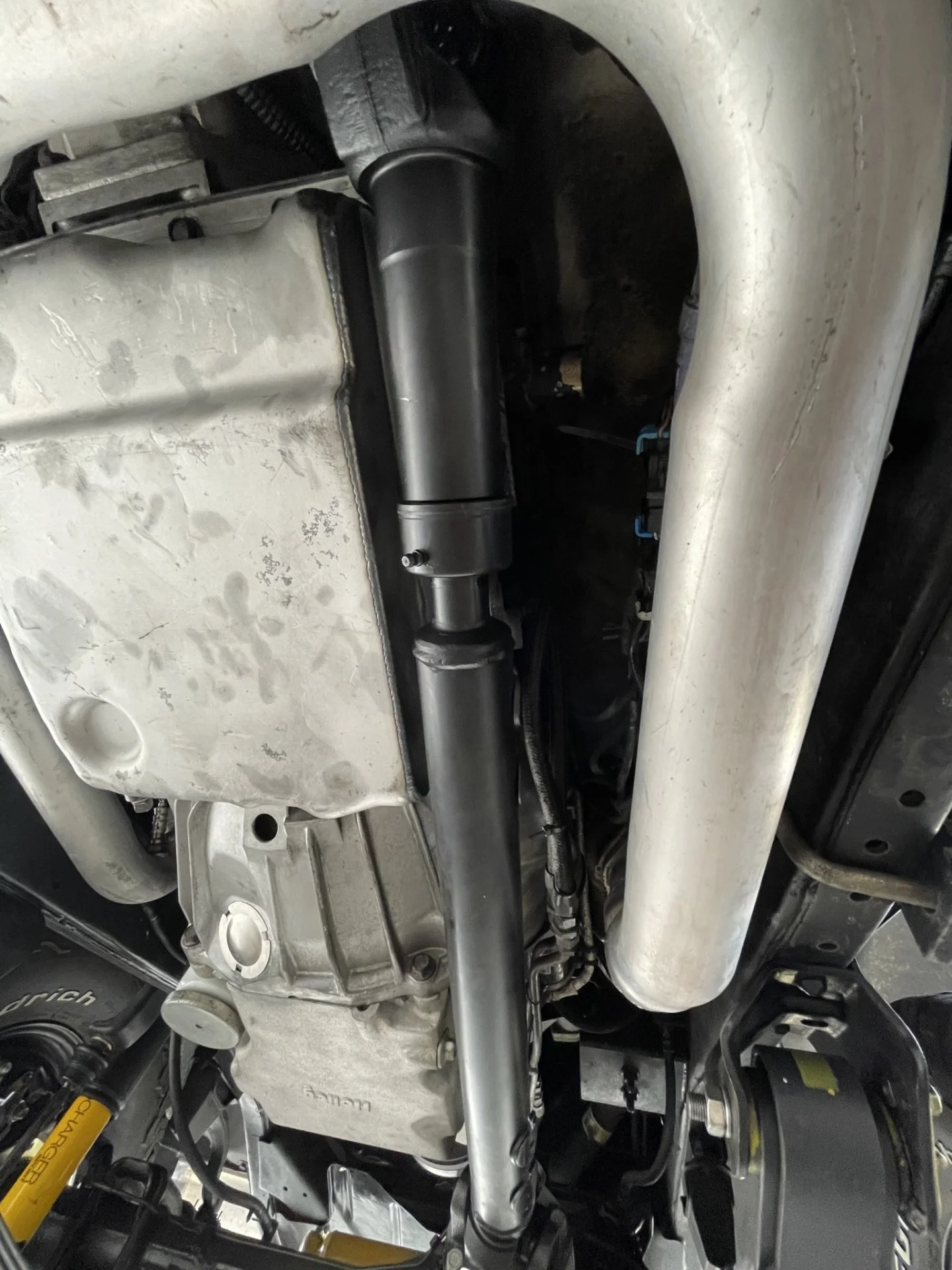

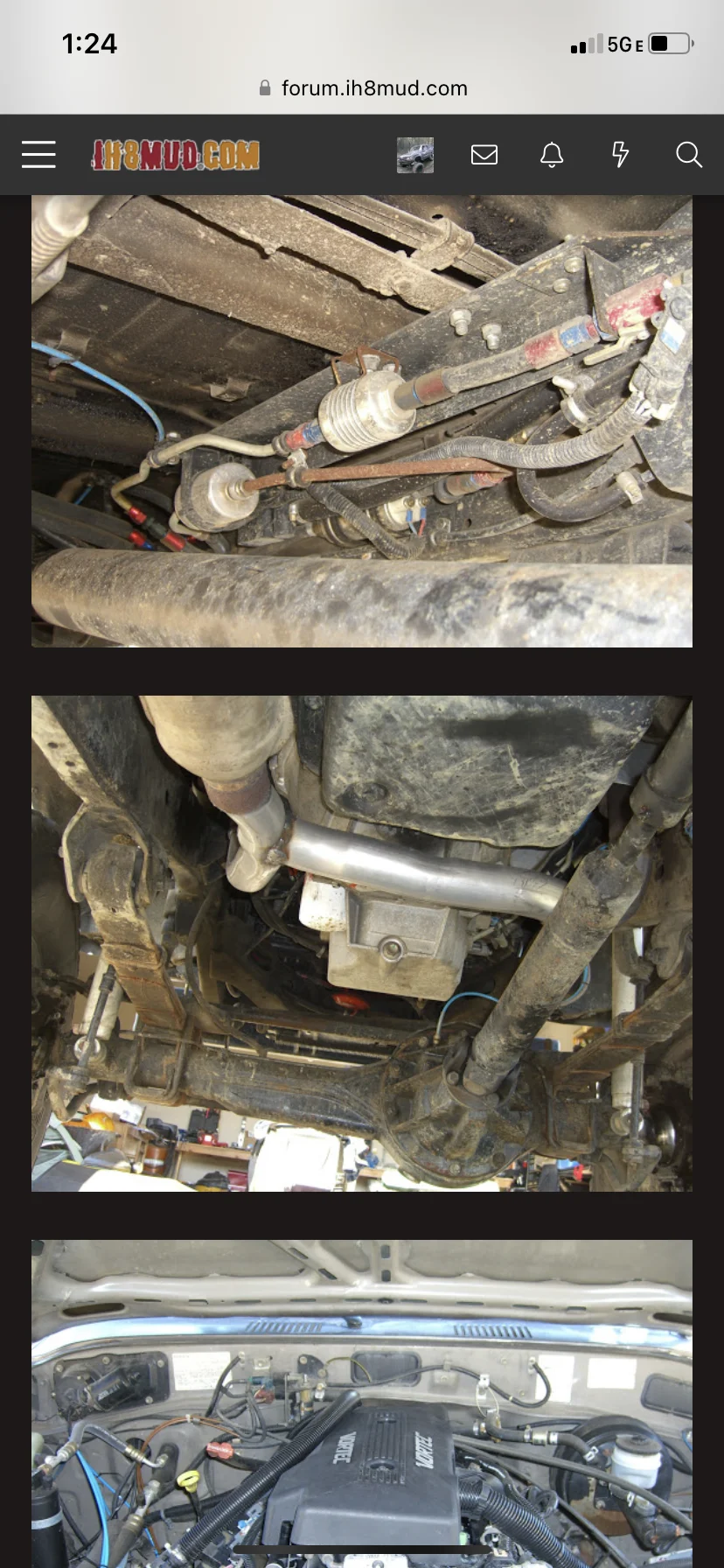

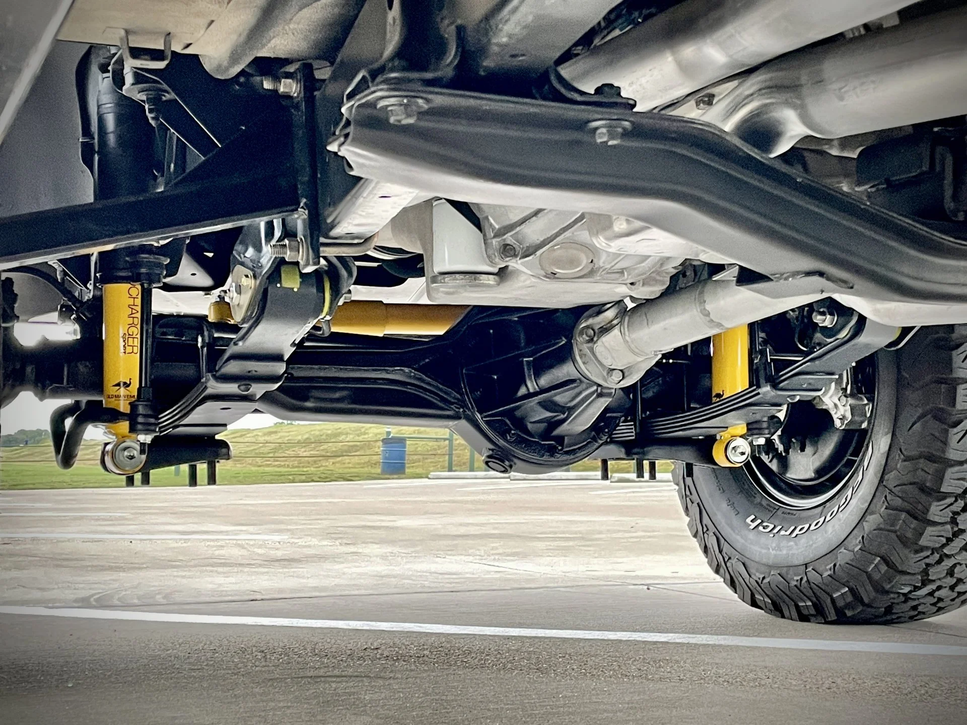

Can a truck oil pan be run on a SOA setup? Searched and found some pics but can’t tell if there will be interference at extreme flex.
Is that a truck pan in those photos? Im unsure on SOA, but id assume youd have more room. Maybe someone else can chime in if they used the truck pan. Generally most people end up using the H3 "hot rod" pan or whatever. Holley makes a few too that are similar.

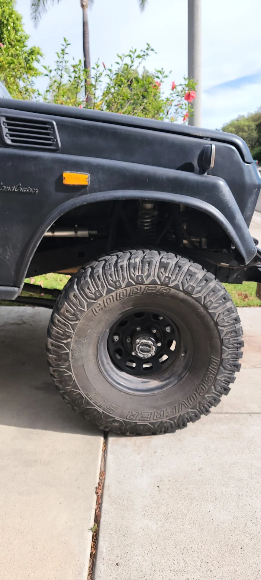

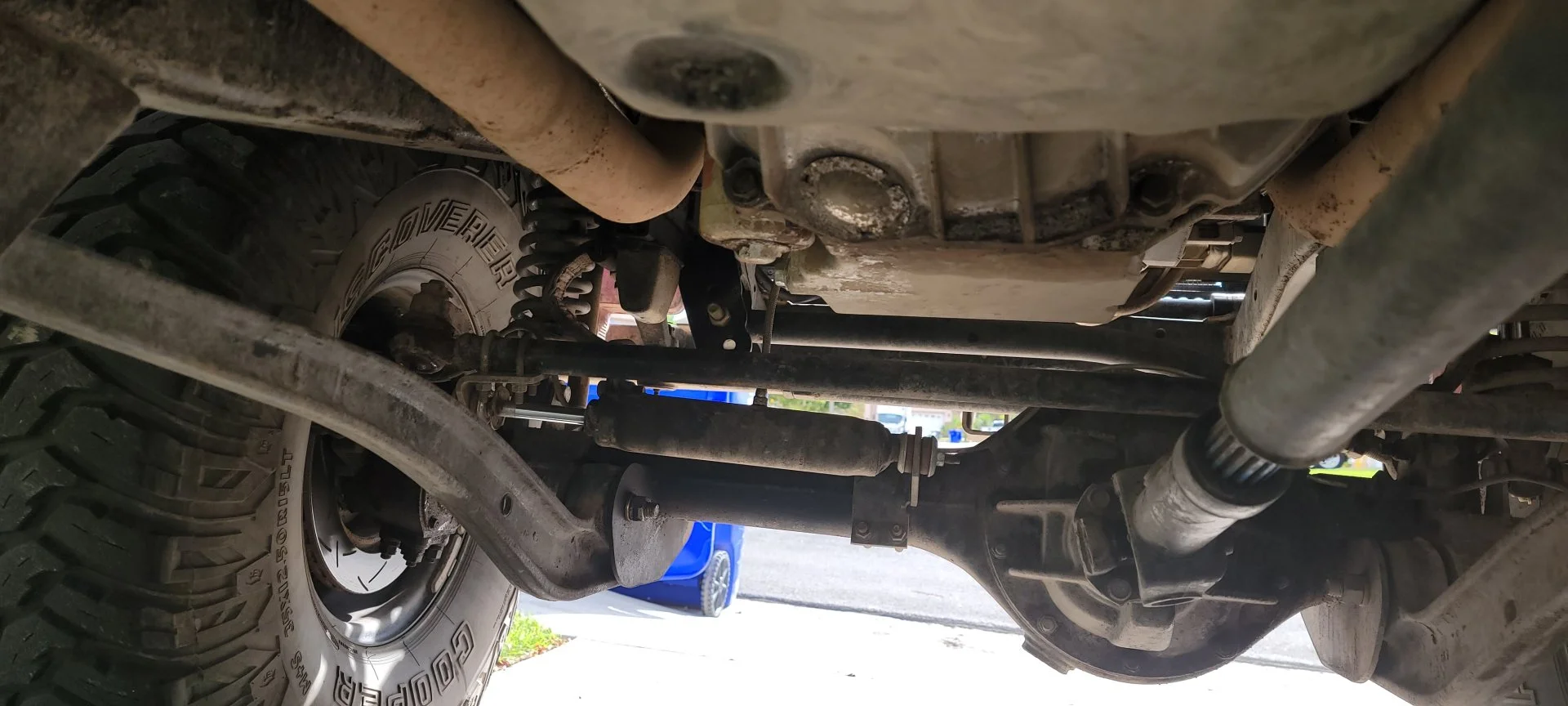

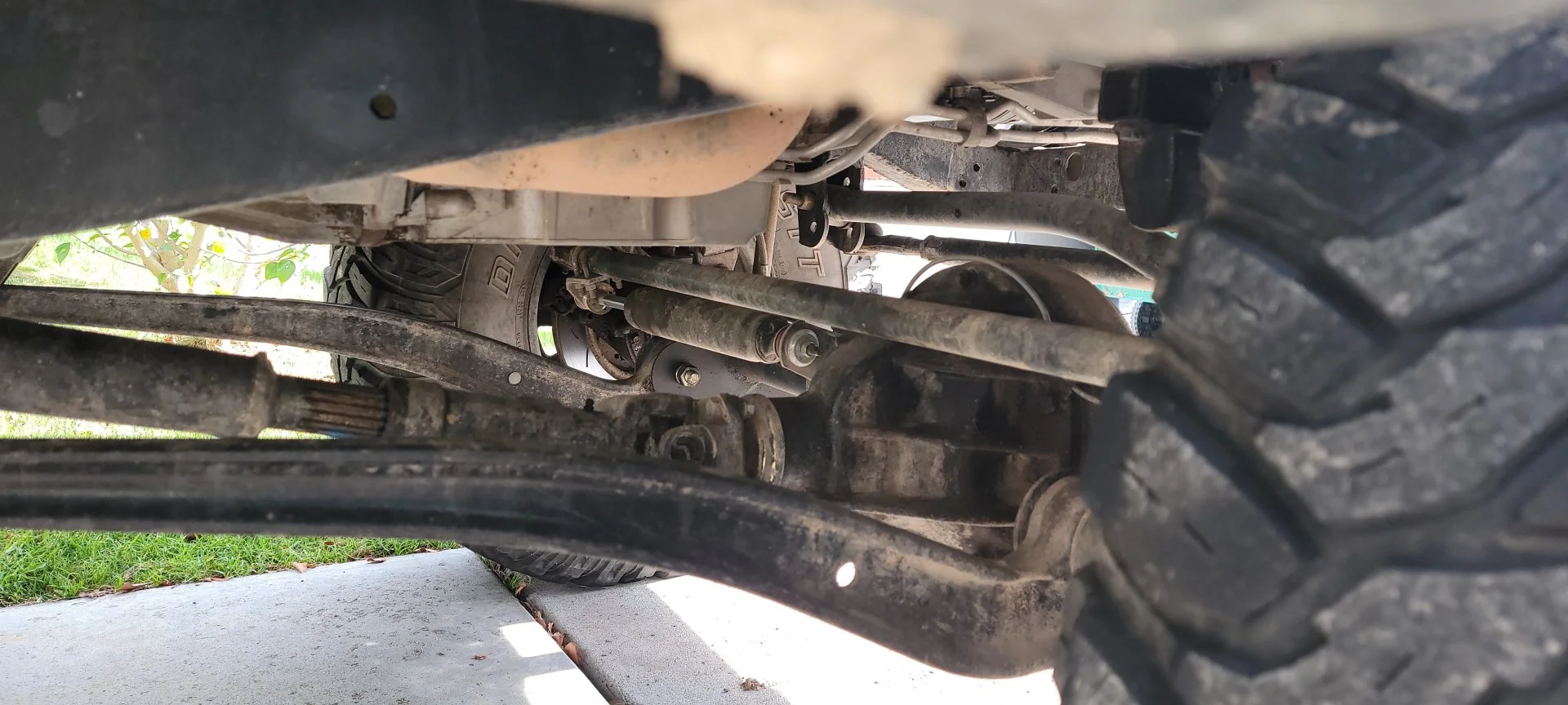

Not sure on the 60 but my 55 has about a 6 inch lift so probably close to soa and the truck pan was not going to work for me. I did the 2000 camaro pan of rock auto. A lot cheaper than holley.
Idea of my lift.
Granted, I have a frombie high steer I was trying to miss also. I don't think I wanted to FAFO the wrong way.

Thank you for the pics. Helpful to push me towards doing the pan.
@dbbowen
The truck pan sits about 3 inches lower. The shorter pan puts the oil filter close to level with the bottom.
