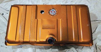

we were talking about fuel rails. Nice dig.
I still don’t agree with vapor lock on a EFI pump but whatever if you want to listen to some marketing dude with clean hands
Is this marketing? Not a loaded question
Cavitation is a natural process that occurs when vapor bubbles are introduced into liquid under pressure. All electric fuel pumps are susceptible to this force. Its most common cause is installer error, where an inadequate fuel supply increases the suction on the inlet side.
Cavitation is literally boiling the fuel through pressure. Vapor bubbles form and then split, causing a micro-explosion. This is extremely damaging, as even a few minutes of cavitation can ruin a fuel pump.
Another cause of failure is over-heated fuel. Not running a return line (dead-head style) or attempting to plumb the return line into the feed line (not into the tank) causes hot fuel to cycle back through the pump, heating it up more. The hotter the fuel, the easier it is to cavitate or even vapor lock. Yes, EFI systems can vapor lock too. This is why a proper return system is so important for EFI.
You realize the majority of LS cars and trucks are returnless right? They all are after 2008.
Yes in-tank pumps are a good idea.
No, overheated fuel is not going to vapor lock a 50-60psi gerotor pump.
Please explain how fuel is going to get hotter then ambient anyways sitting in a tank.
The fuel coming back from the return on my LS race car has never want above 80F btw. There is a temperature sensor built into the Flex sensor.
Vapor lock is a issue with low pressure carb pumps drawing from 10ft away from the fuel source. "vapor lock " is a easy term to latch on to from a marketing perspective because old people had to deal with that for decades with crappy old fuel systems that were an every vehicle
^my opinion. as someone who sells and installs retrofit EFI systems very regularly :meh:

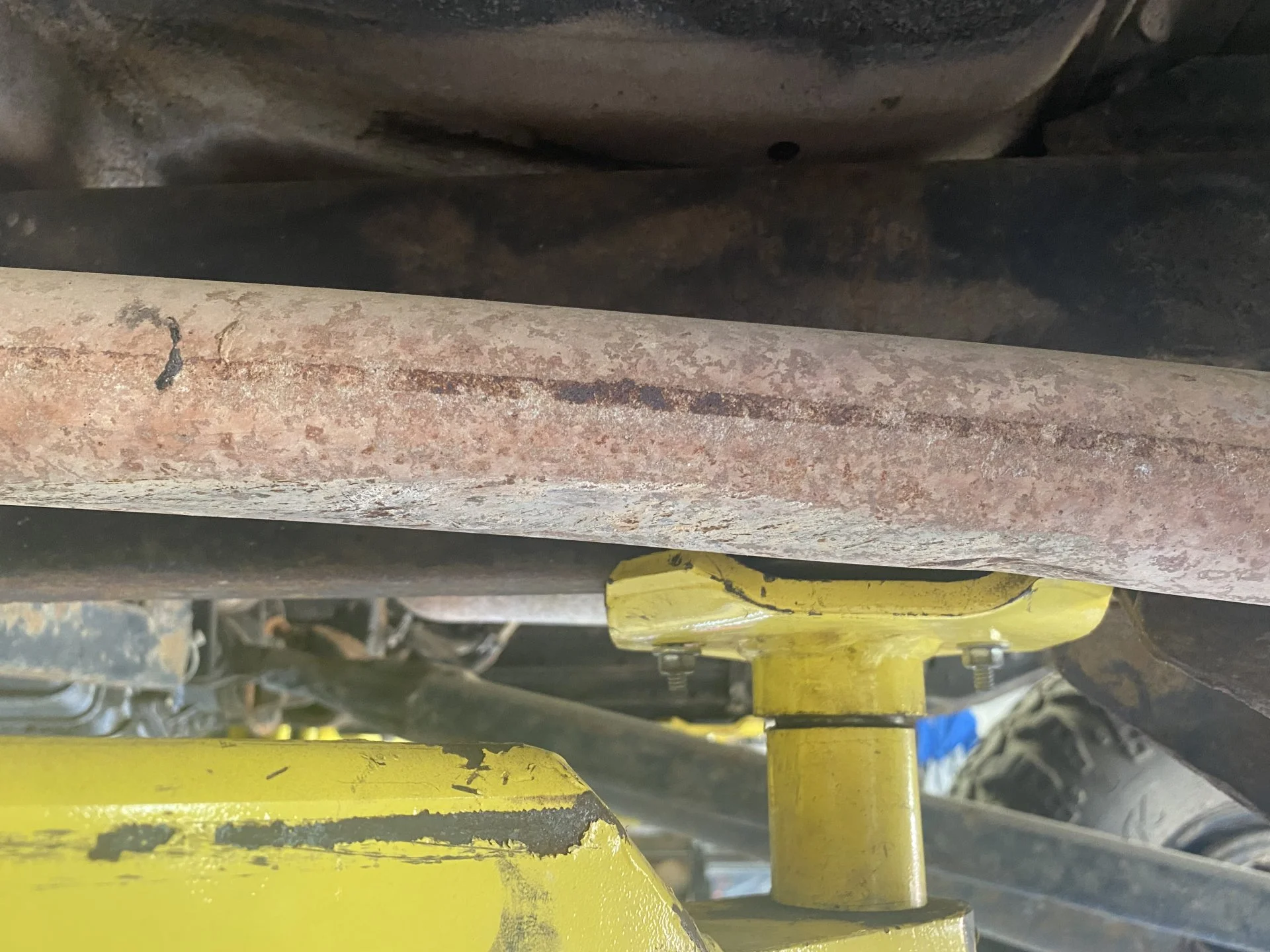

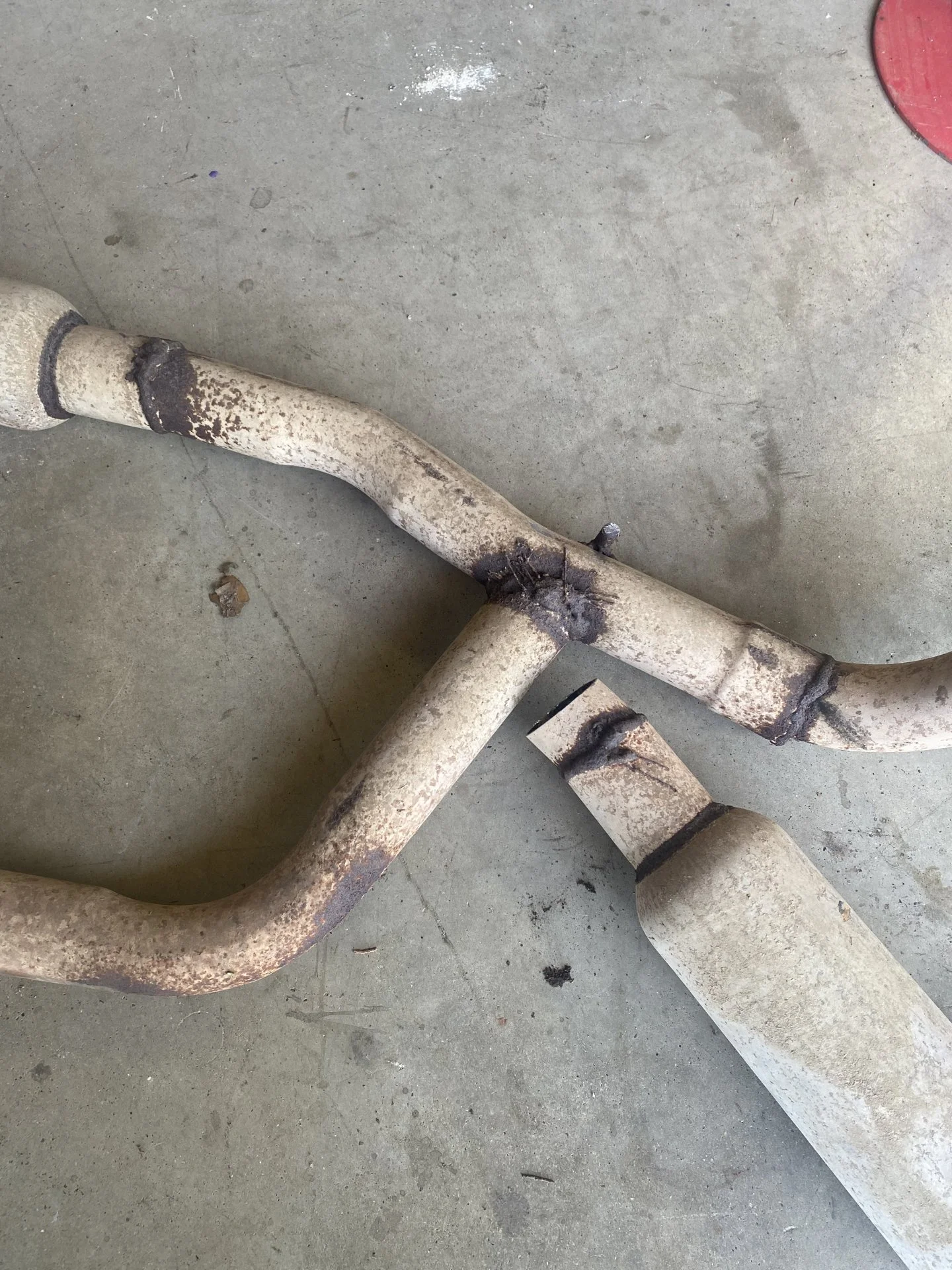

As I start an LS build, I remembered your exhaust posts. The first muffler shop exhaust only lasted a couple years before rusting out.
The second exhuast, pictured, is a 15ish year old exhaust done by a backwoods muffler shop. Not the best welds, but they never leaked. Cracked on one mount…prob due to sliding the exhaust on rocks. The restriction is pretty significant, especially at the exit. After completely building one homemade exhaust from the headers back, it is well worth the time to build your own exhaust.
