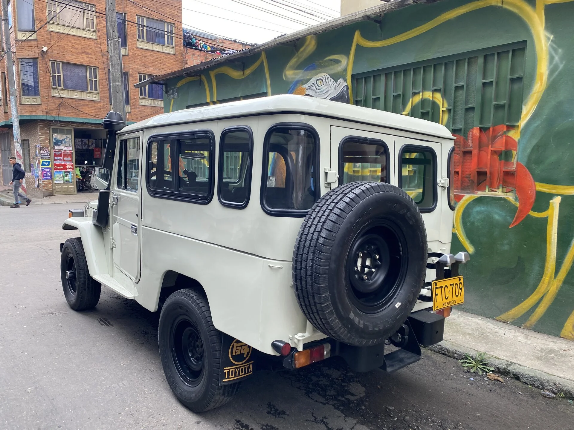

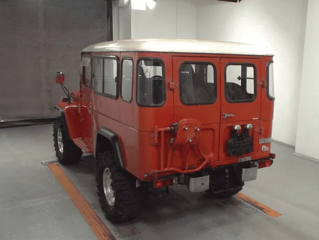

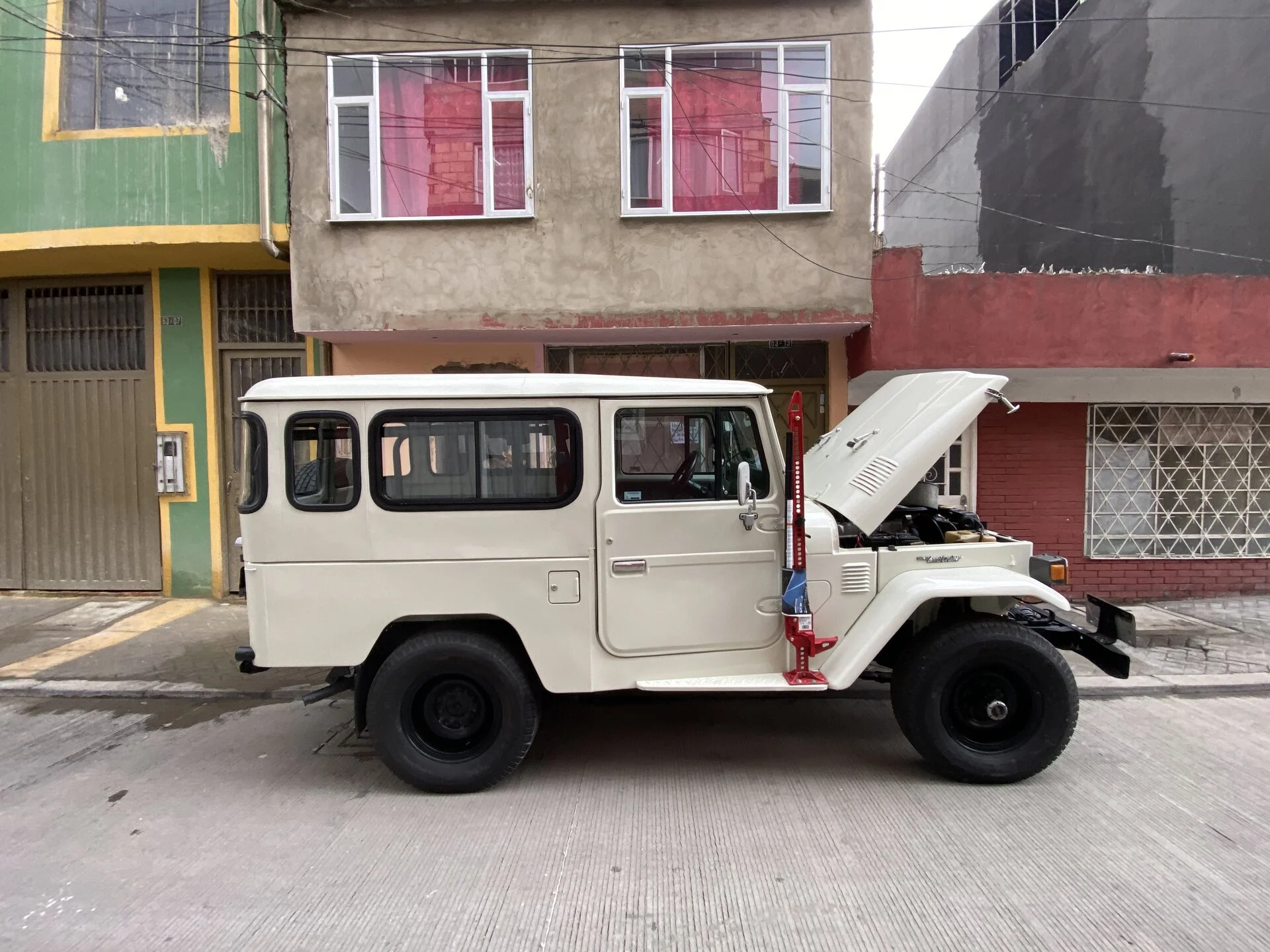

The BJ46 have a factory hard top. What your seeing is probably a Columbian locally made top. A certain percentage of the vehicle had to be made locally so all the hard top from there are aftermarket. Other option would be to use two FJ40 tops to make one that fits. Hardest part is sourcing the small window behind the larger side window.

That’s what I was thinking would be tricky as well. Any idea where that would come from?

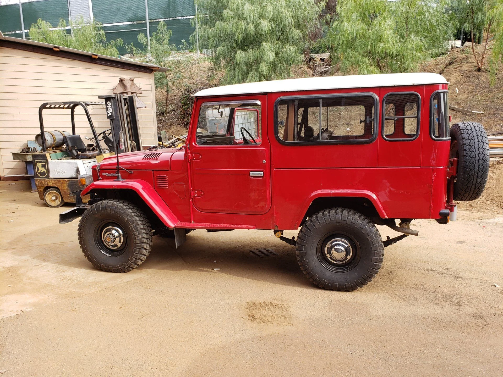

My 43 has the MPR fiberglass top which is pretty solid. Are you sure FJco is using steel?
There was an MPR top in the classifieds. Look up @sandergielen he has a Colombian connection

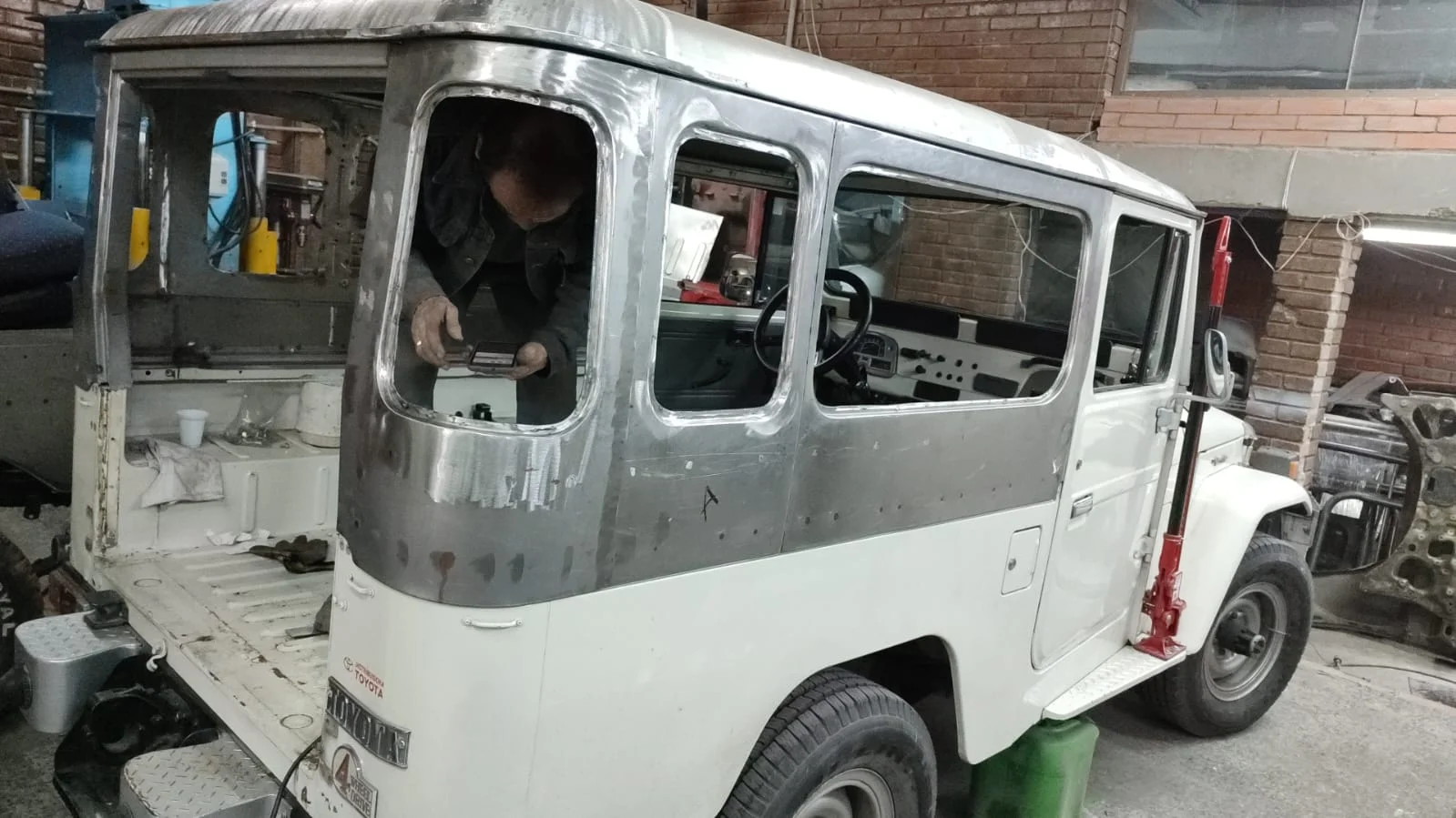

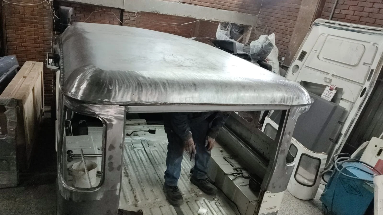

I have seen the FJ Companies work up close at SEMA two years ago. They weld in extension panels on both sides with windows above. Appeared very much like the BJ44 and 46 photo above. I am sure one could be made by a competant welder/fabricator. Their welds in the out side were quite visible. But , WAY better looking than the aftermarket ones I have also seen firsthand. Many folks with them complain of lots of wind noise.

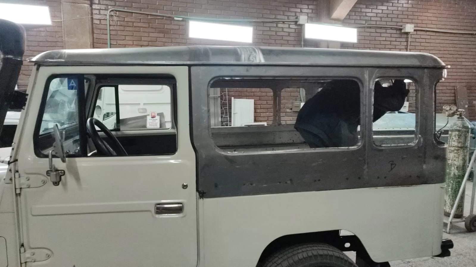

A competent body fabricator or do-it-yourself person could stretch stock 40 sides either by grafting two tops or by adding more sheetmetal without the ugly weld seams.
There are many examples here of people replacing rusted out body sections and welding in new metal with no evidence of the actual work.
The factory tops have the same ugly weld seams and a very obviously a 40 series with a panel added

I've not seen one of the 43 tops in person.... based on what I've seen, I believe an ambulance door window turned on its side would be very close in size. I believe either the gasket or the whole window could be used as a window in the "filler" panel. If I unlimited time and energy, I'd stretch my 40 when I replace my 1/4s and stretch my hardtop to match. Even stretching the fiberglass hardtop could be done quite easily by anyone with experience in fiberglass work.
