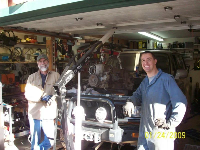

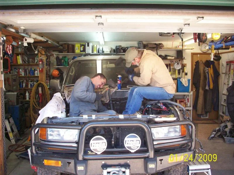

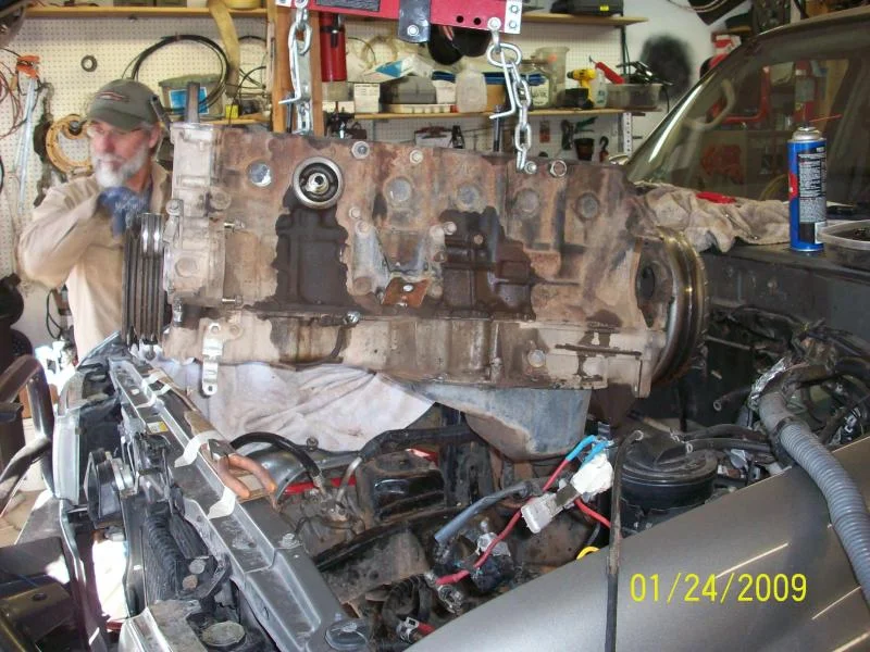

Big thanks to Dan and Jon for helping me pull the engine out. This was quite fun when you have the proper tools (that I borrowed from them).
Tomorrow the block comes apart and on Monday hopefully it's going into the engine shop for a decking and what ever else is needed.

...feed us afterword. Glad to help. It was fun. I've come to the conclusion that the 1FZFE is not the holy grail of Toyota engines that you 80 boys profess.

Those guys look way too happy. I can't remember that last time I had a grin that big on my face.

The reason for pulling the engine out was due to two things: broken crankshaft sprocket tooth and minor pitting on the block surface. The stripped block and the timing cover are at the machine shop for a decking, probably about .005" and a mild honing. New piston rings (same size) and connecting rod bearings will be installed.
