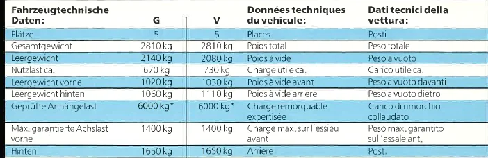

Switzerland takes the price,
HJ61 6000 kg with air brakes on trailer,
All limited to 80km/hours max.
