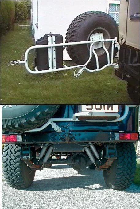

Maybe you can do something with the rear license holder:

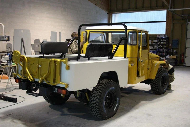

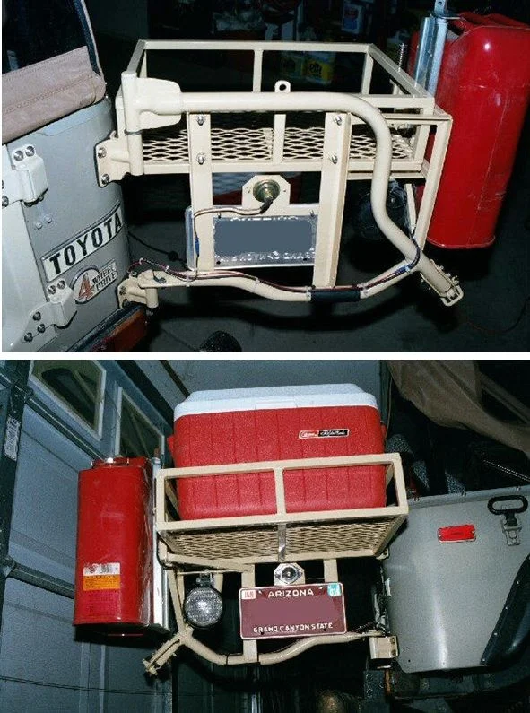

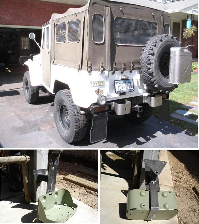

A rear frame mounted swing out carrier with a basket is a nice way to go. Or folks can mount up two spare tire carriers and mod to mount can and license plate there.................. Will try and post up what I did recently.

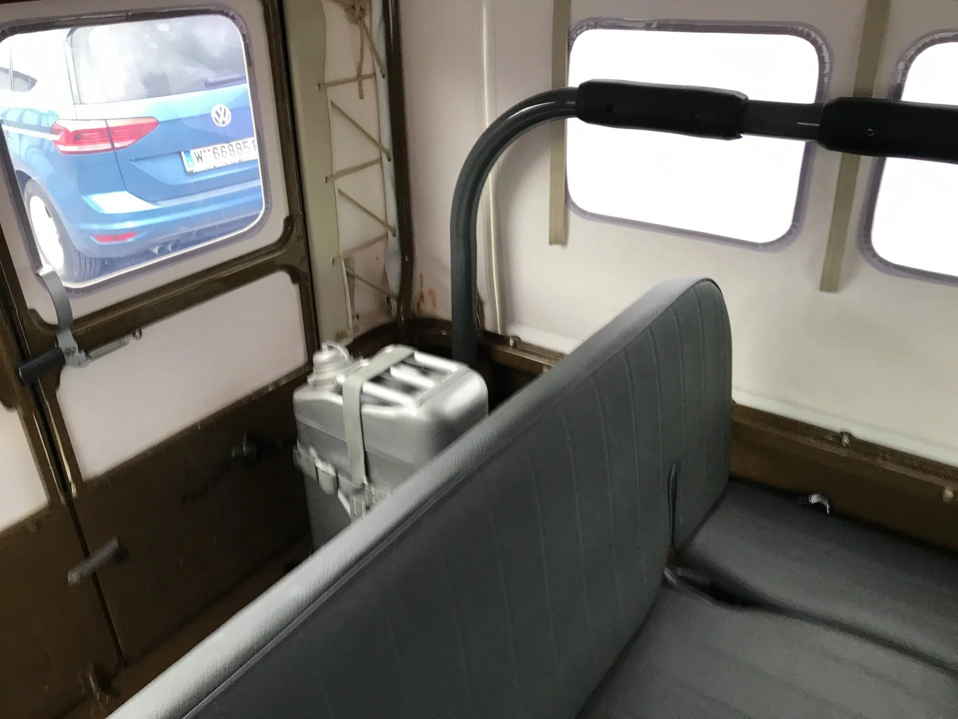

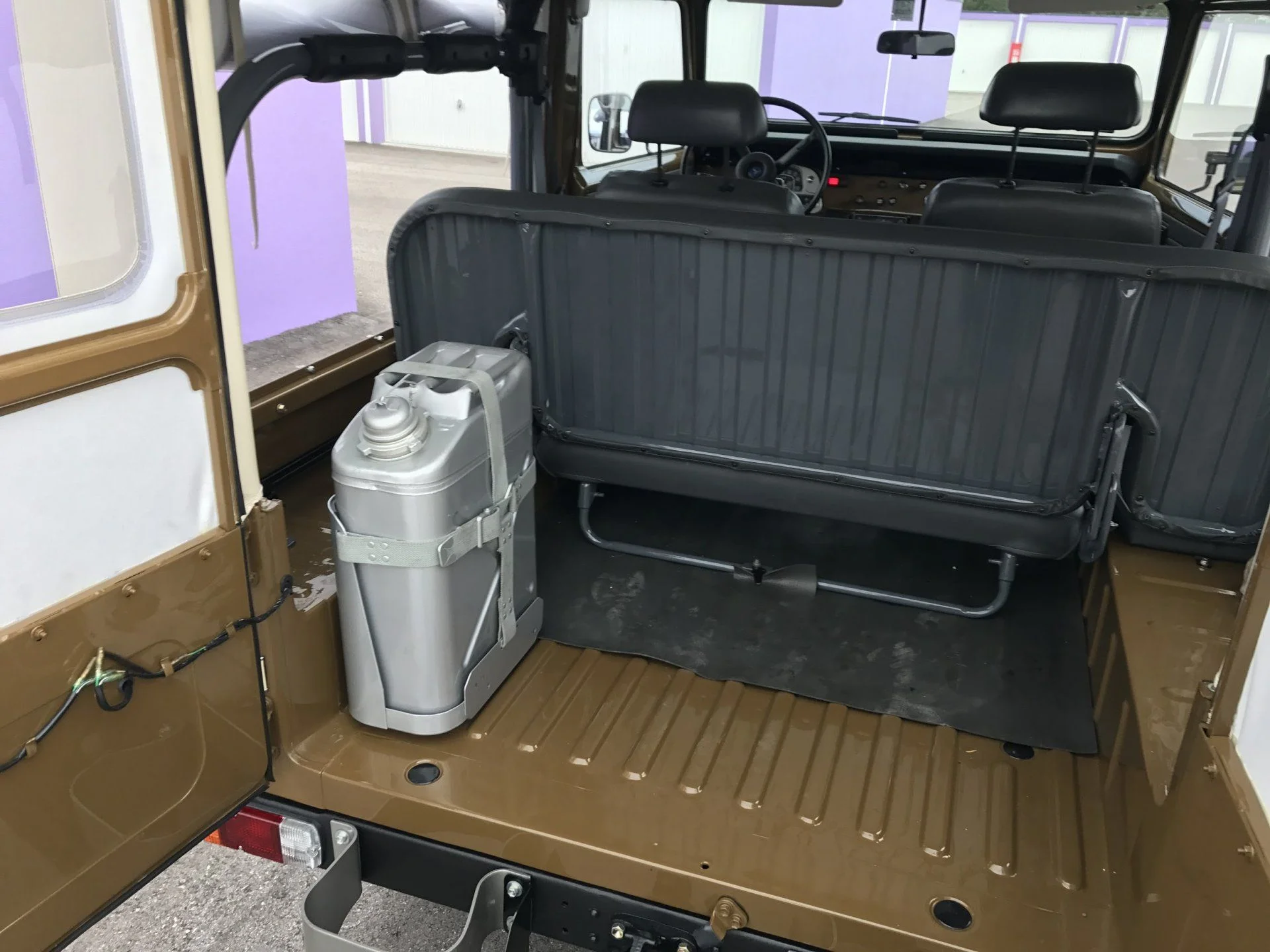

Just put em in your back seat like in Mad Max. :rofl:

@1911 fantastic pic!! Try and post up my setup later.

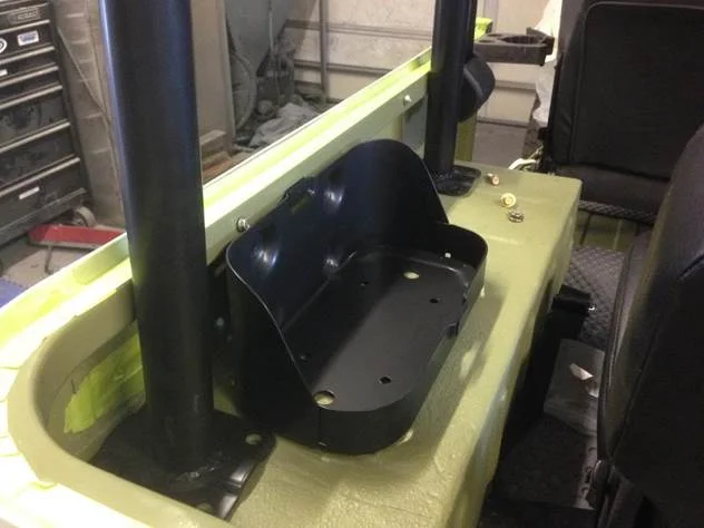

Aux tank under the tub.

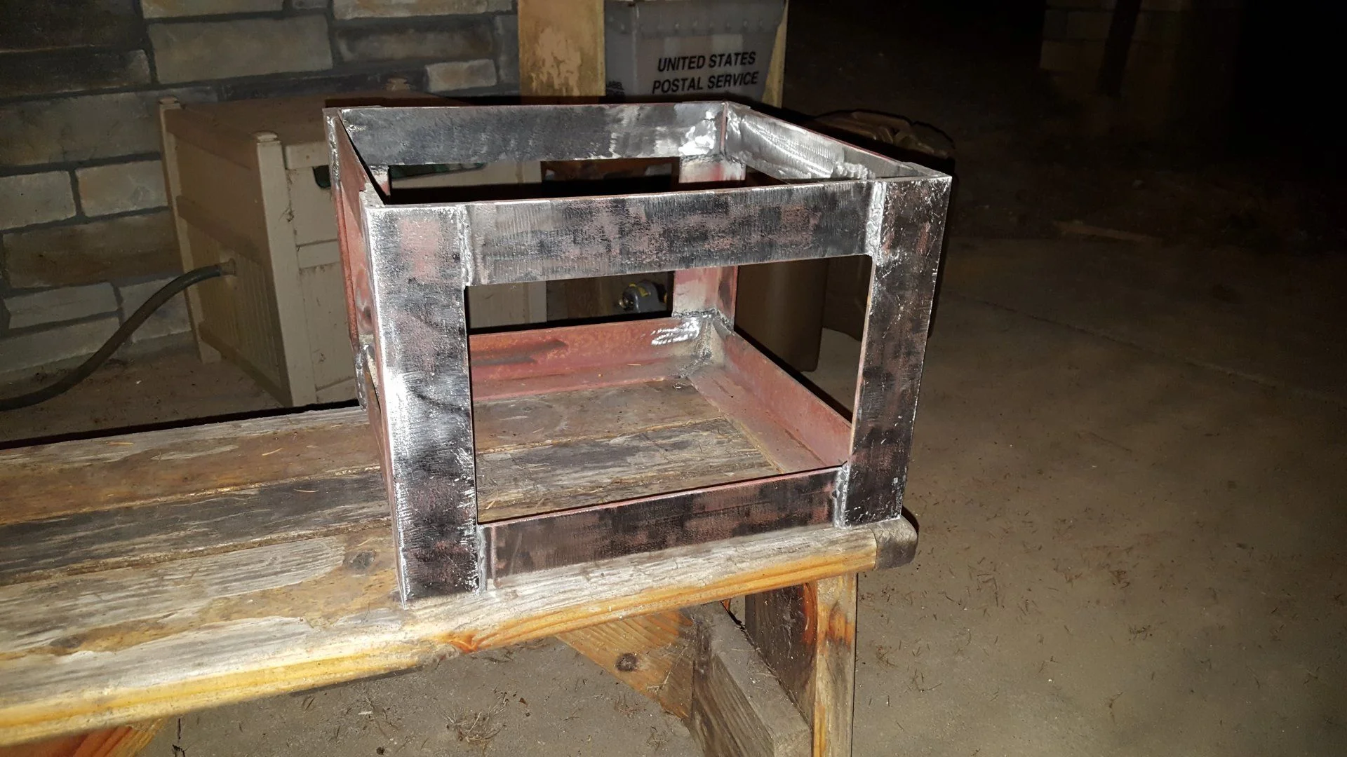

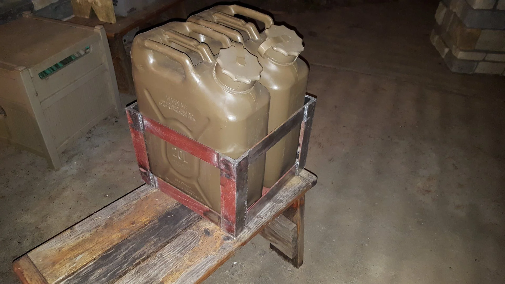

I had picked up a second spare tire carrier and was planning on doing the dual swing out like in a few of pictures above, but didn't like the idea of hanging it off sheet metal or drilling into the tub. I also didn't want to have to open it every time i wanted to get into the back. A bumper mounted carrier would be a better solution, but it would still block access to the rear doors.
Someone made a drop down cage under the rear tub that held a couple of jerry cans, I think I saw it on this forum.

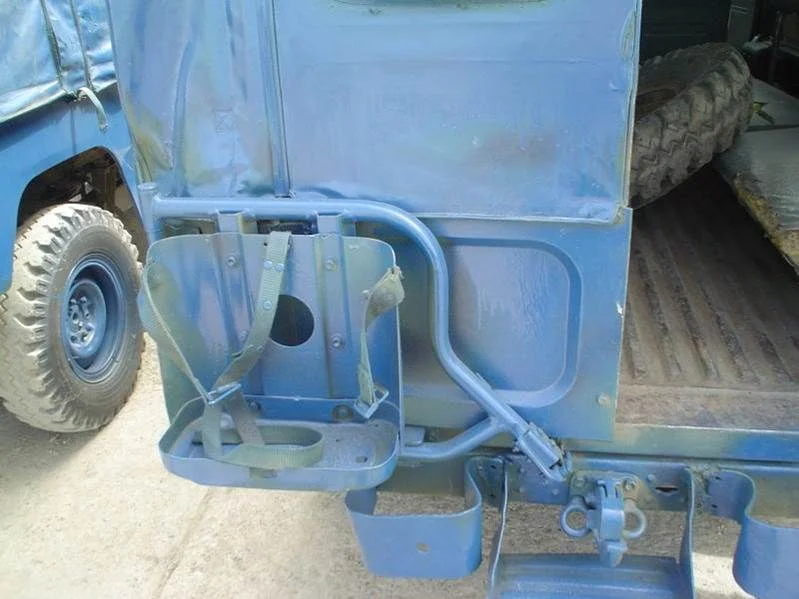

mV60K3FQW-sd_W4mEouMx5q08OAORtOUODfozxZtRSxih4w6AG521vlY3r2Pngwfrpk3uWvSCLXhPOp-oT6R3AFv-hFjzkoXOpryWkVYqxQn3dszE6ZICd-fnRKX_SPi9ARF6I4mIco4NbEkVlKFO7QOlytVlITuSbnZkAgvk_ygptLTIC6iV0f1Ivbs4wF_EG2jAi2Lzsz3f6eXUpi6NSc3QS5R6NaSuvhgB82DVT2BFJ_eY29IL-dLEWU7_bnOHYTXHC-L0iC0WW6wE5Wq8ZbmQxEv2ieApSxWLkicyo0leB2-rpNKouzKU7u2yQ7He7hkvyjG2Kq38uh-WeVCtEsP8gQ3k3lJ7VZl8y0nukPbe2OiOKY41Al2ZfIM1lIkF7eTcEaawj9anWbweKxT1JQqVPIFLCOaoIhUBNDRo_42qU0CmWT0J-w5HJErmG-idlpzRdgMYkkvQviv3qq1Iw08oWCGoajpwQQMc2JPzKSbD2a3BjJfUIsoh2hfqN_IvFl9bF41ZCfBn16GRfWI9Jl9frNJQ0OBZfSPLxbYafUkwvZGkydoUgwu2Ia9i_ISYemwEUZqTJ0RWO6XQz4U7SoJXKbfR5vYRZqTD56qW6h_S225krRlF2Lb=w1202-h901-no

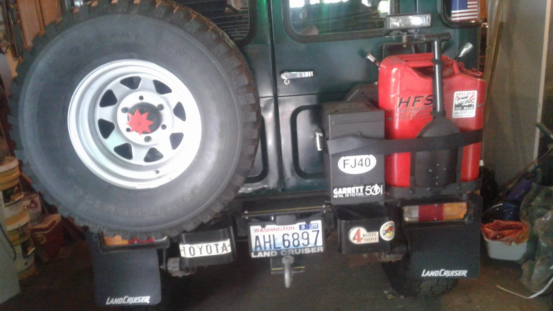

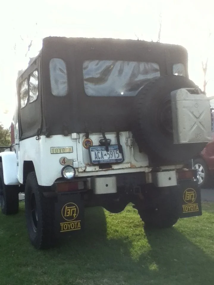

This is what I did, 68 spare carrier on my 76 40. Find a late 74 to early 76 plate style carrier to do the same to yours. This has worked great for over 15 years. :)
wow! Basically perfect, I already had the top holes drilled out when I bought it. Where can I get one of these?

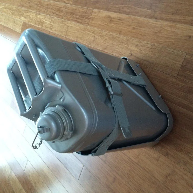

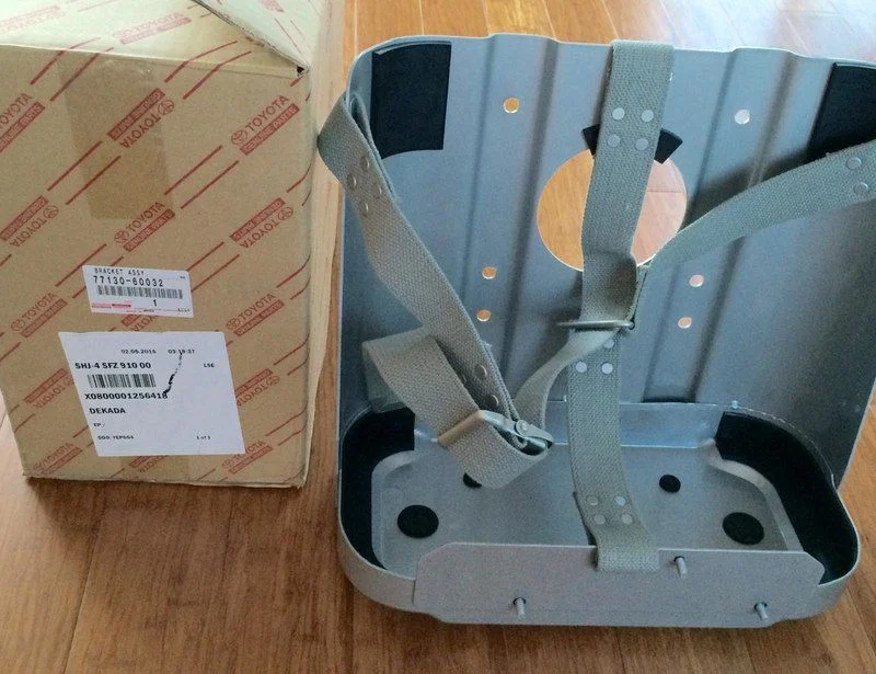

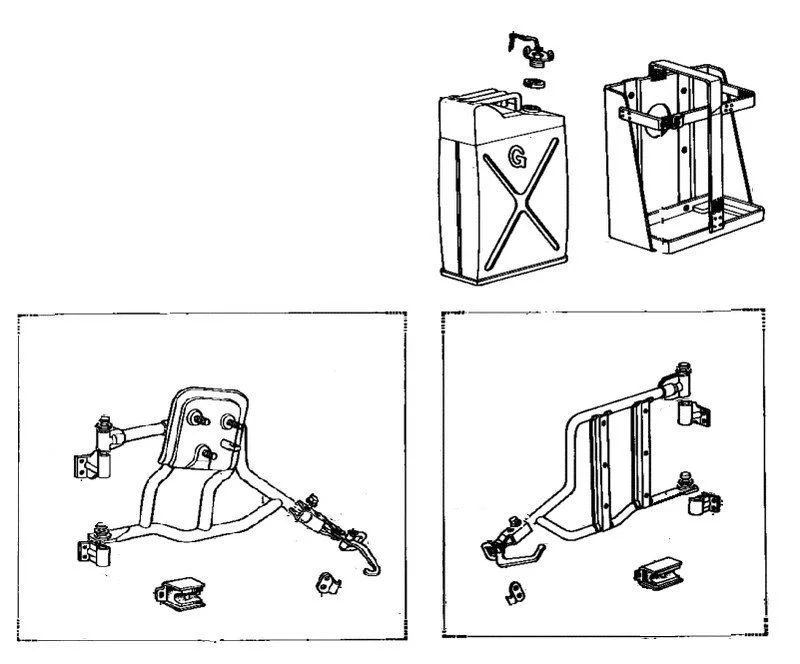

For stage 2 you need
1. OEM Jerry can from J7 77110-60011
In eBay or here
OEM Toyota Jerry Can for Land Cruiser FJ40 FJ60 FZJ80 70 Series 100 Series
2. OEM Jerry can holder from J7 77130-60032
New from Toyota or in EBay
3. You need to fix the number plate holder + electric

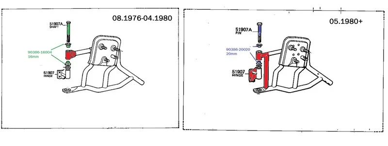

4. If you want to mount it not on the door but on the spare wheel carrier - you need to find the opposite version (old version before 08.1976 or newer
with the tubes + lock and stay; the tube version has a jerry can carrier version from J45).
In eBay
