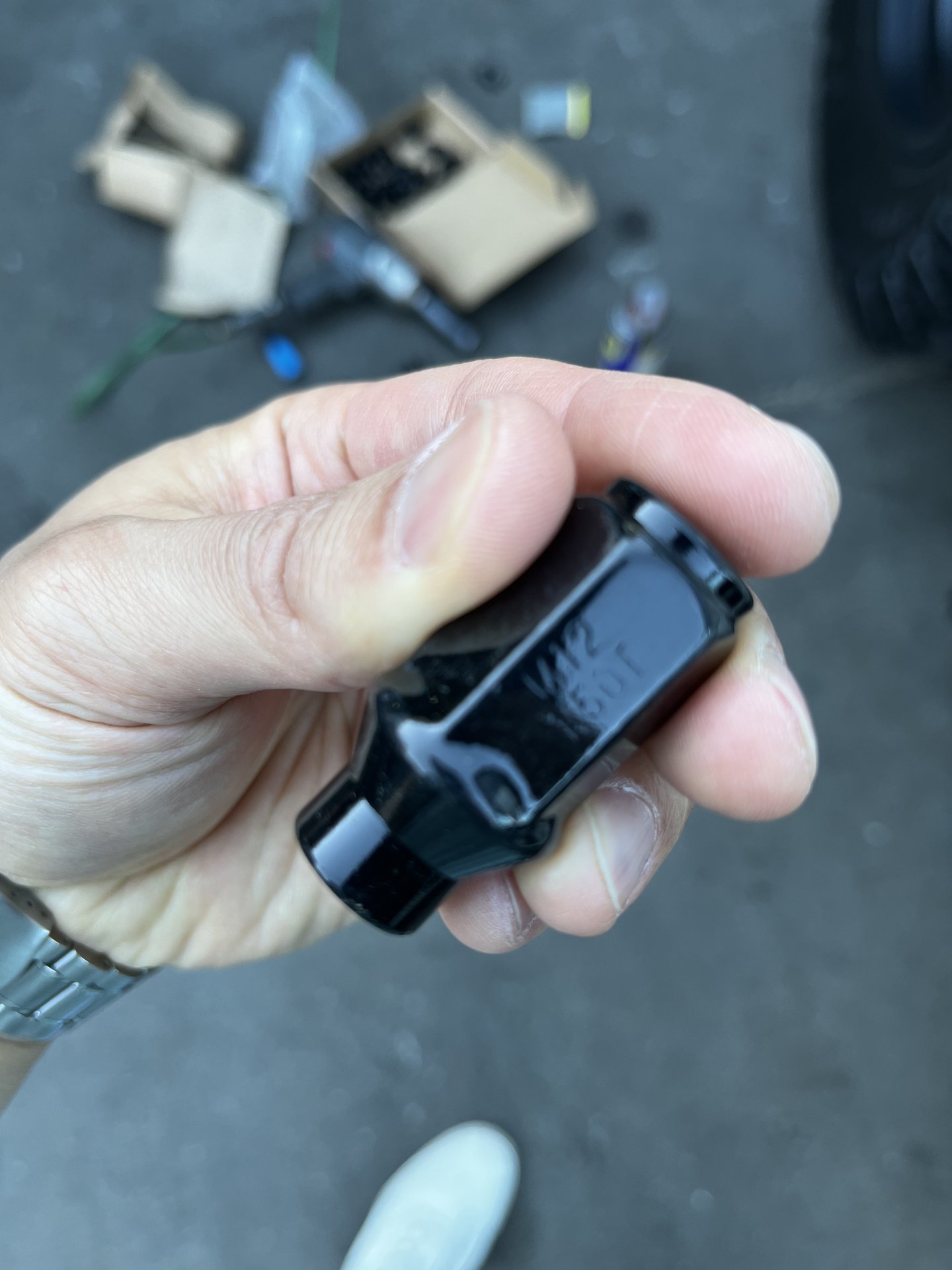

This is why I dumped my beloved 16x10 D window steelies for hub-centric aftermarket wheels with acorn lug nuts. Due to the immense popularity of Toyota Tacomas, 4Runners, Tundras, there's no excuse to run anything but hub-centric aftermarket wheels (hub rings don't count) on your 80 series.
Steelies are much heavier than alloys. They're also manufactured to a much lesser quality even compared to the ubiquitous made in China Wheel Pros brand alloys on 99% of the modified trucks you see on the road today. It's not uncommon that a steel wheel has poor run-out values sans rubber.
  • I only enlist tire shops that use Hunter Roadforce machines
  • Whenever I rotate my 37s, I spend the money to have them roadforce balance each wheel simply because I detest any odd vibrations on all of my vehicles
  • I use these centering style acorn lug nuts for extra peace of mind
