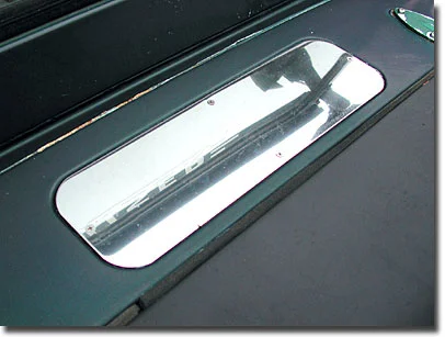

Yea, but won't there always be a ring of water in the crack, rusting away?
I like the idea of getting rid of the drain tubes. Which reminds me that one of mine is missing... Can you still get them?
Edit: pic I found...
attachment.php
attachment.php
We've got more problems with rust up here than you'll have down in CA... put some sheet metal over mine, and put the cover back on. There's very little space for water to sit. It's been 15 years now, and still no problems.:cheers:
Even with a cover like the one pictured, you've got just as much of a crack for water to sit in.
