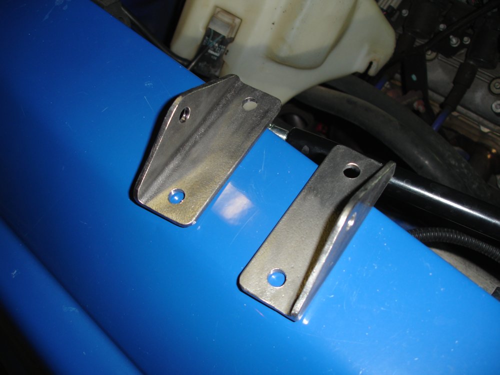

So, I just finished doing this and wanted to add my experience to this thread.
I was doing great on the hood until I had the first strut in on the drivers side. Using the same fender holes as show at the beginning of this thread, I got everything snug and tight, and then left the hood open while I brought in the passenger's side bracket after painting it. I went to grab something off the bench and wham, the hood comes down. This is when I snapped the ball joint off the end of the strut attached to the hood. Seems that I had compressed the strut to full before the hood was closed and the last inch was just too much. So, I picked a threaded hole just below and further to the front of the vehicle and drilled it out and tapped it for the strut. Went ahead and used washer for re-inforcement and lock washer and nut on the inside of the fender. So I'm all ready to put the ps bracket on finally when I realize I can't find it......like, literally and hour of searching the garage and the engine bay later, cannot find the damn thing. Great. So, I got some angle iron and with a grinder and a bench grinder, made these:
Then painted and installed:
Now, everything's back together and it works great....a really fun and easy mod (if you don't lose your brackets!).
