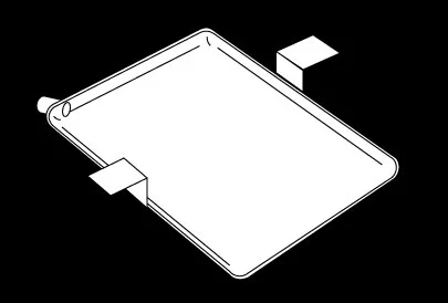

Nothing yet but the plan is to add a catch under them with a drain to the rear of the wheel wells. Anyone that has dropped a bolt in the engine compartment and found it by the sliders will know what path am talking about. I am thinking I will space it down about an inch so air can still pass but water will drain. The charcoal canister is under the left and the cruise control is under the right one.
http://www.greenwoodcorvettes.net/gc4/louvers.htm
look at the baffles they show in the link above.
Here is what I envision and it should be really simple to make. Then the idea would be to weld it to the hood (being as it will need to be painted anyhow. Black nylon tube would attach to the nipple to the edge of the hood and then down to the inner fender well.

Question - is there enough room between the canister/cruise control and the hood for a catch? I would imagine based on the angle of the hood and the need for the catch to be angled towards the rear or front of the vehicle that you would be talking at least an inch to two inches of space being needed...would that impact clearance issues of the hood?

Considering the thickness of the hood insulation I would think so. It wouldn't need to drop very low.
