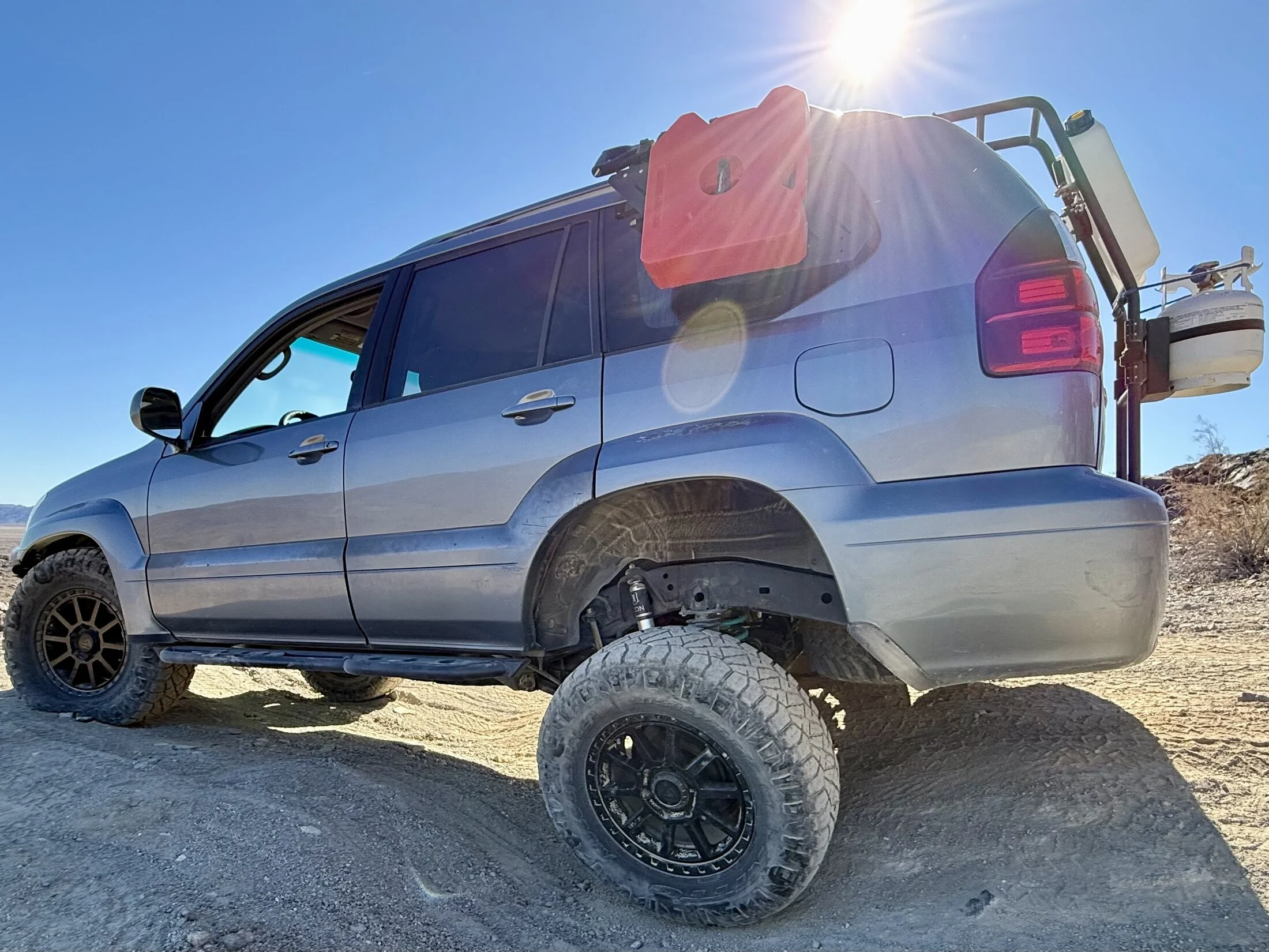

Build purpose: Explore the mountains and deserts around me.
Current wheels, tires, gears, lockers:
  1. 2024: Rear 8.2” Factory E-Locked (2918 5th Gen 4R) Axle Housing; Retained the rear GX470 axles, rotors, calipers, and wheel bearings. Welded new brackets for rear HD sway bar
  2. 2024: Polished 4.56 Revolution gears front and rear
  3. 2024: Upgraded GX460 front calipers and rotors
  4. 2023: AlphaEquipt Foxtrots 17x7.5 zero offset, 27 lbs per Claude
  5. 2025: Five Yokohama Geolandar MT G003 285/75R17 (aka 34.1” by 11.1”), 63.3 lbs, Load E/121
  6. Spare tire in a tire swingout on FJC steel wheel 17x7.5, +14 offset
Current front suspension:
  1. 2025: Apex Bolt-on spindle gussets
  2. 2017: Front UCAs: Total Chaos. I’m at 3.7* caster.
  3. 2018: Front LCAs: New Toyota OEM
  4. 2018: Installed diff drop and upgraded the diff support bracket

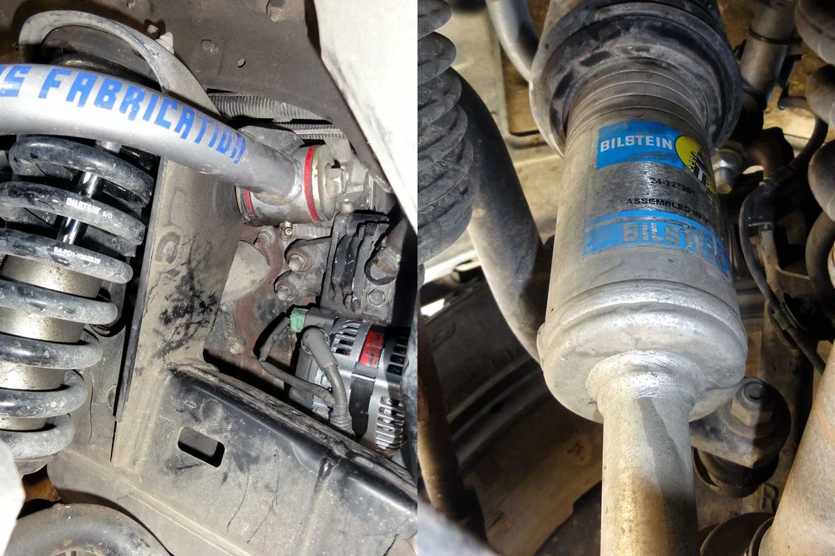

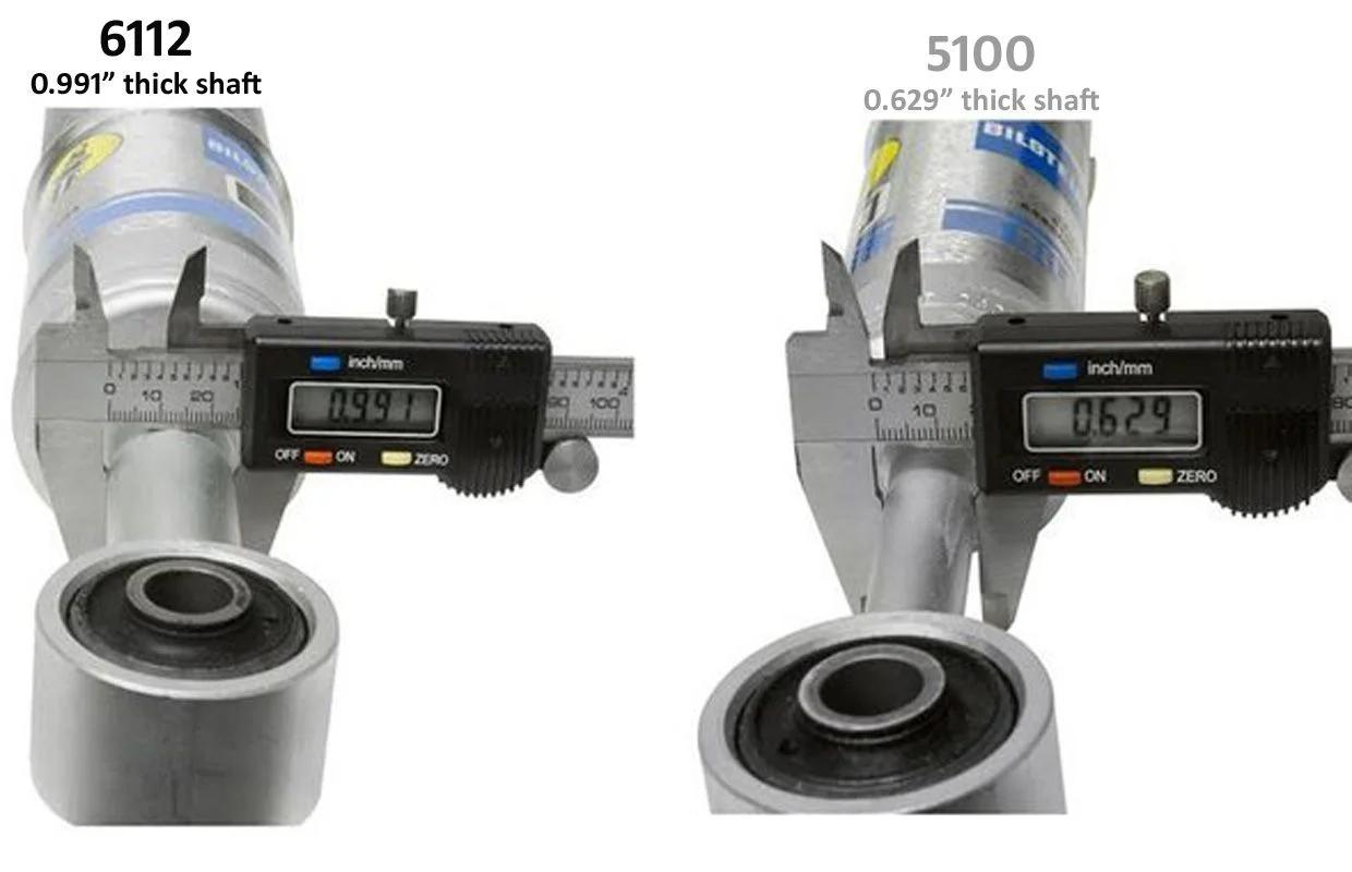

  5. 2022: Extended Travel Front Coilovers: Bilstein 6112s heavy kit 47-284142 with 700 lbf/in coils. 2.6" diameter IFP shocks. Lifted about 2.3” in the front. 6112s are 17mm longer which result in 1.24” of added droop.
  6. 2022: Durobump bump stops for the front. Much softer than stock oem bump stops to improve the ride on washboard roads or hard hits.
  7. 2023: Removed front sway bar. Now my front tires don’t rub at all, yeah!
  8. 2023: Taco Tabs Cam eliminator kit to fix the alignment; 2024 spot welds behind factory cam tabs to reinforce them.
  9. 2024: 555 tie rods
Current rear suspension:
  1. 2019: Rear Shocks: Icon 56550 MT Long Travel (17"/28.5"). Digressive valving matches digressive valving of front Bilstein 6112s.
  2. 2019: Rear Coils: Dobinson C59-701V; ~19.7" free height; variable rate 210 to 245 lbf/in; 17mm wire; Got about 2.75" rear lift on these coils with drawer and rear tire swingout. Closer to 2.5” when loaded with water, gasoline, propane, wood, and supplies for a weekend trip.
  3. 2019: Extended MetalTech stainless-steel rear brake lines
  4. 2019: Coil Conversion Kit: MetalTech Stage 2 (no added height; Toyota isolators)
  5. 2021: Extended rear diff breather line to gas cap. Homemade kit with Amazon parts
  6. 2022: Rear Sway Bar End Links by OCD (Mike Studts) beefy rear adjustable swaybar end-links
  7. 2022: Timbren Active Offroad bumpstops for the rear with 1” hockey pucks as spacers.
  8. 2022: Eimkeith Panhard Correction Kit (PCK) installed to level the bar. Moved to 8.2 axle housing.
  9. 2023: Nolathane GX470 heavy duty 24mm thick rear sway bar to help transfer articulation and stabilize the front. Custom welded brackets on 8.2 axle housing.
  10. Apache Offroad HD Upper Rear Control Arms with multi durometer joints for added flex
  11. Apache Offroad HD Lower Rear Links with multi durometer joints for added flex
  12. EimKeith LLS bracket to protect lower control arm mounts
Current body armor and recovery points:
  1. 2025: OVS SCAR 10K Winch with synthetic rope
  2. 2025: JW Offroad rear tire swingout (half passenger side).
  3. 2024: Restless Offroad Front Bumper with Auxbeam 4” cubes, 3” cubes, and 2” morimoto 1banger sae fog lights
  4. 2024: Goliath Offroad front bumper reinforcement bracket with recovery points.
  5. 2024: eimKeith LLS brackets for rear arm lower mount points.

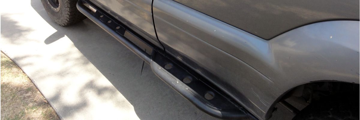

  6. 2017: Rock Sliders: MetalTech OPOR
  7. 2018: Skid Plates: RockSteady Motorsports aluminum front and middle
  8. 2019: Rear Recovery Point: 2" Tow Hitch Mount for soft shackle recovery
  9. 2022: FJTOYMAN rear shock shin guards to protect bolt and bottom of shock.

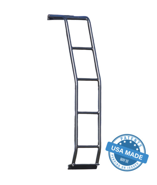

  3. 2018: Gobi ladder to carry jerry can for extra gas. Two 3-gallon Rotopax fuel containers with locking Rotopax handles

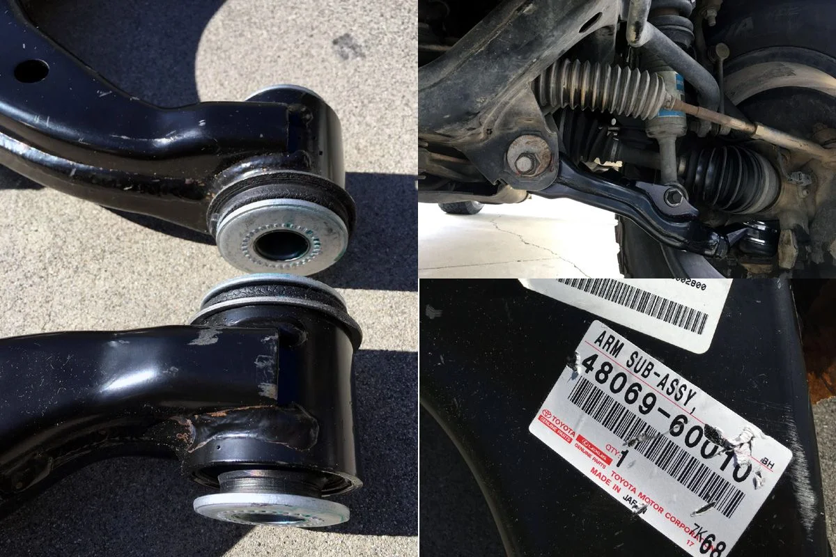

9. Replaced LCAs with Toyota OEM LCAs #48068-60010 for the right side and #48069-60010 for the left side

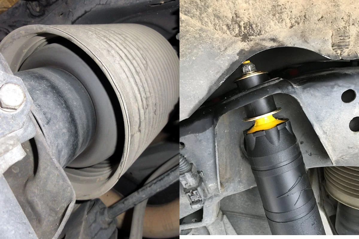

I replaced the OEM rear shocks with the OME 60004 shocks. I still have the air bags in the rear, but this change made my GX470 bouncy upfront. I've recently added some weight like the 2nd row seats and two crates of tools and fluids. This weight made the suspension behave much better, but still not riding like a plush luxury SUV.
I’m considering upgrading the rear shocks to Bilstein 5160 remote reserviors to see if they behave better than the OME 60004. Maybe the 5160s will match the valving of the front Bilstein 6112s. Just a guess at this point.
[Update 1/04/2020] Finally did the coil conversion and removed the OME 60004s. The OME 60004 rear shocks were not a good match for the front Bilstein 6112s. The rear digressive Icon 56550 LT MT shocks are a much better match to the digressive Bilstein fronts.
I don't recommend that you mix digressive Bilstein front shocks with progressive OME rear shocks. It's not a good mix. Ride is very bouncy as if the mismatched shocks create harmonic oscillations and make you feel like a bobble-head on old roads that have a lot of breaks in the cement/pavement.

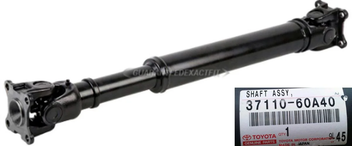

1. Replace rear drive propeller shaft assembly to get rid of clunk. Rear drive shaft assy #37110-60A40. Old part number #37110-6A480. Grease for now.

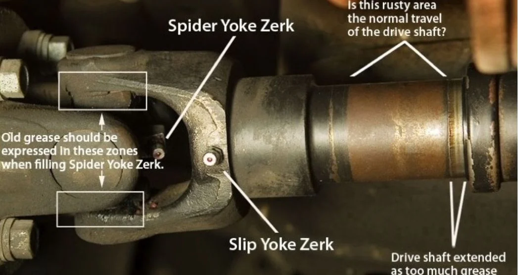

Nice work! Have you tried greasing the driveshaft? I know the thump/ bump is pretty common across the board. Mine used to need greasing at least twice a year or it would let me know it was back there...
Do you have pictures of exactly what you grease in the drive shaft? I asked my mechanic to grease the driveshaft, but I don't think he greased the right spot. Good thing he didn't charge me. It was part of the oil change.
Here's where I'm at today, but my build keeps on moving...so these might not be the latest pictures for very long!
Stole an Internet pic but this will give you an idea. It’s the slip yoke zerk. Only a few squirts recommended for that one as you don’t want to hydrolock it.
IIRC, there are 6 total for front and rear that IMO should be serviced routinely. May just save you from having to replace the shaft prematurely.
I lube the drive shafts at every oil change, easy to remember that way and fresh grease is never a bad thing. On the yoke I have always put grease in until the yoke just begins to move.
