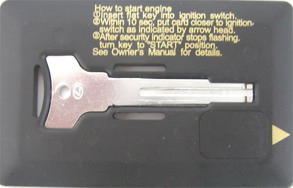

I'm going to resurrect this thread because I lost my master FOB key this past weekend when my belt loop broke carrying kids.
All I have at this point is the valet key and they key card in the glove compartment. I tested the valet key and as mentioned above the security light stays solid for a moment then goes out. Does anyone happen to know if the key card is going to produce the same result or is this considered a master that I can use to program new keys?
What does the key card look like? Picture?
It is a master key. I tested this morning on my way into work and see the light go out immediately upon placing the chip close to the ignition.
