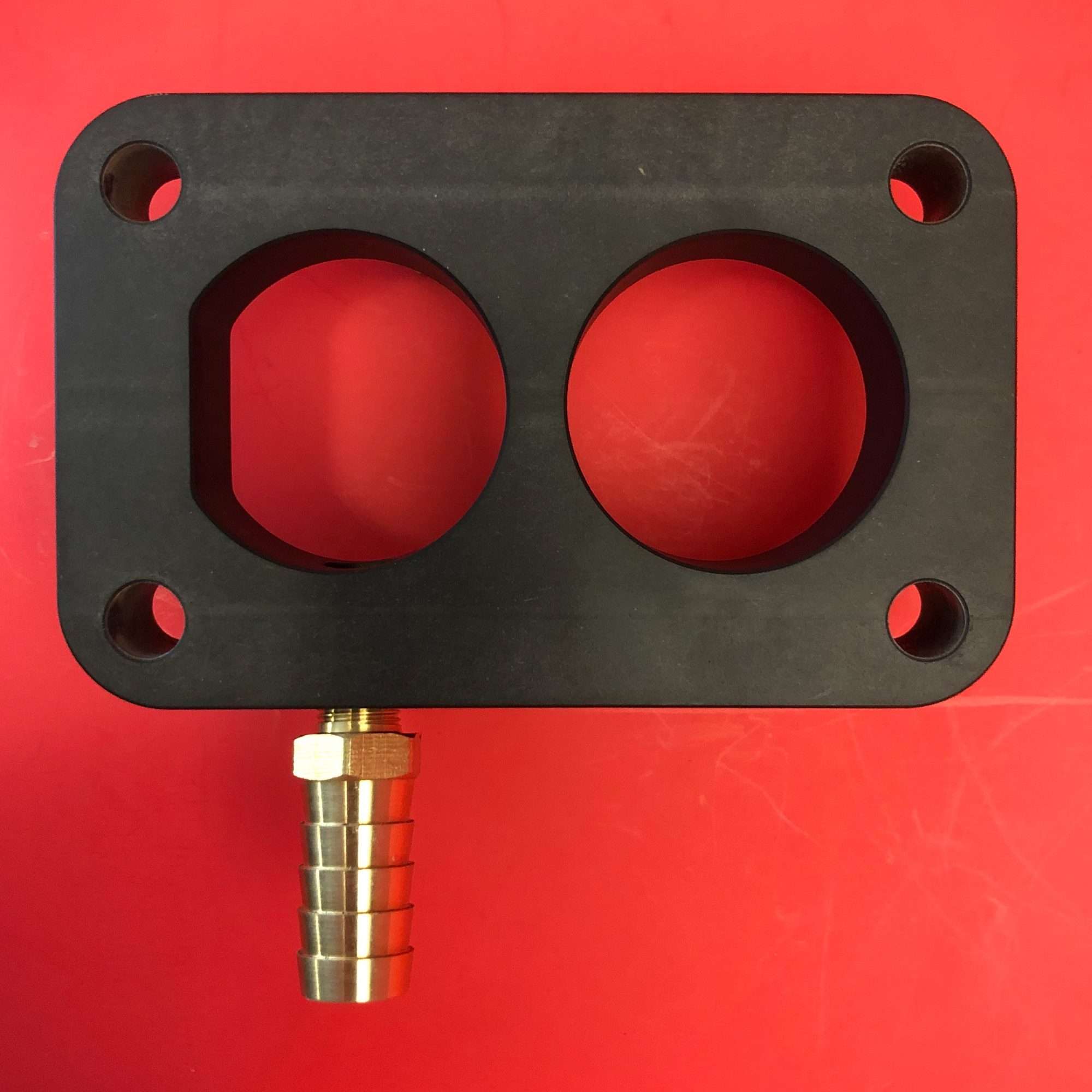

Removed the fuel pump from the box and needed the first item out of the Mosley Motors box
Good time to introduce this kit. Email him at sales@mosleymotors.com for a kit. He's a one man operation so don't try to call.
What's in the box?
5/16" fuel line and high pressure clamps
Very quiet Walbro pump (in tank kits available)
Lokar cable and bracket
Air cleaner rod (bent for a 2F air cleaner)
O2 bung
2300 Holley Adapter machined for adapter clearance
Corvette Return with -an fittings.

Install the modified 2300 adapter. Mosley machines off a portion so the adapter fits flush on the Insulator. NOTE*** you don't use carburetor gaskets with a fresh isolator.
SECOND NOTE ***** be sure to put these three studs in from the bottom of the adapter before you screw it all down
