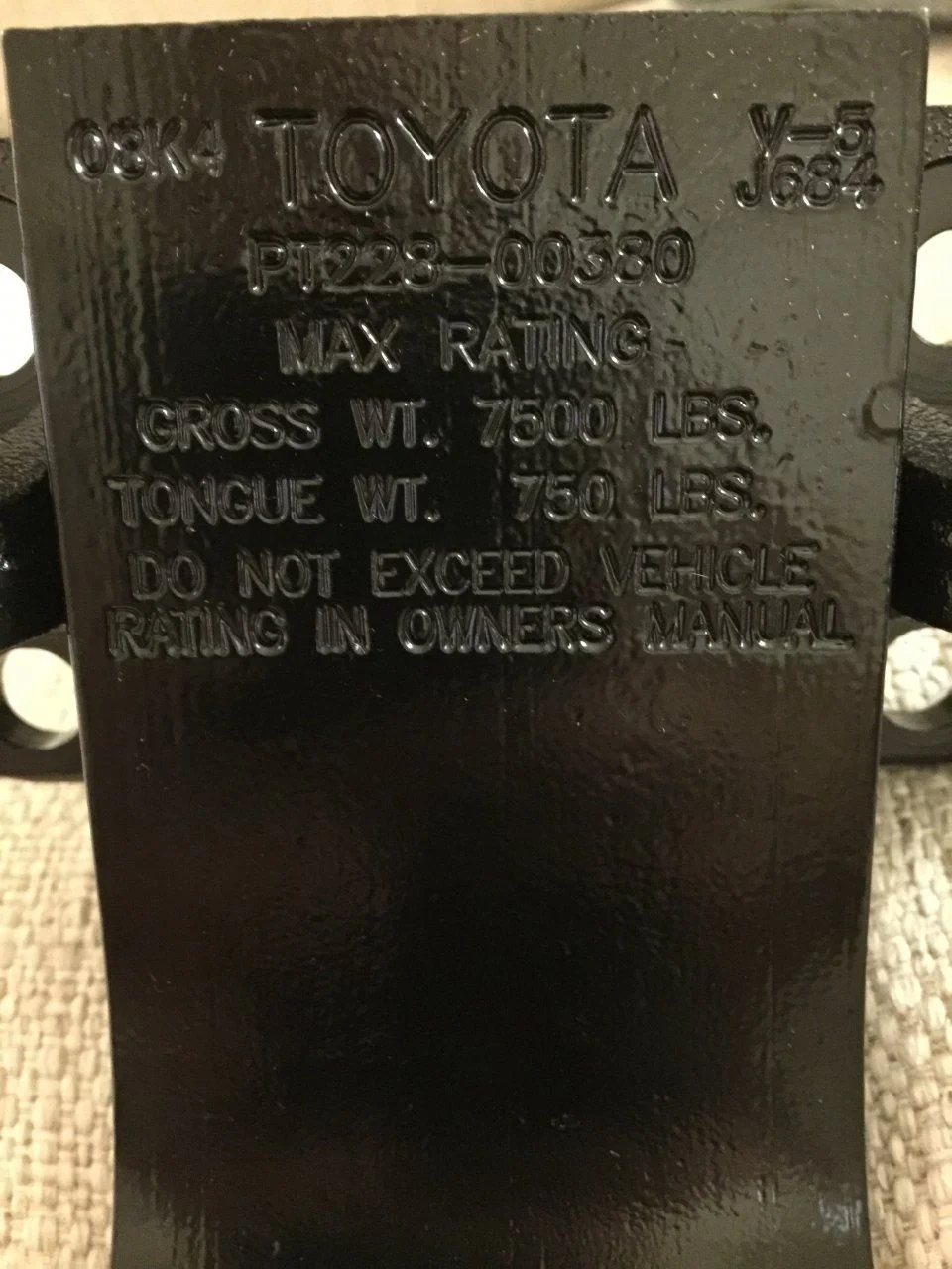

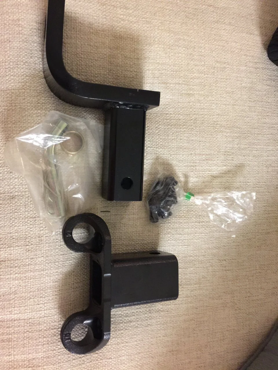

Scored today! Got a hitch insert, hardware, hitch with pin all new and all for $25! Thank you Craigslist!

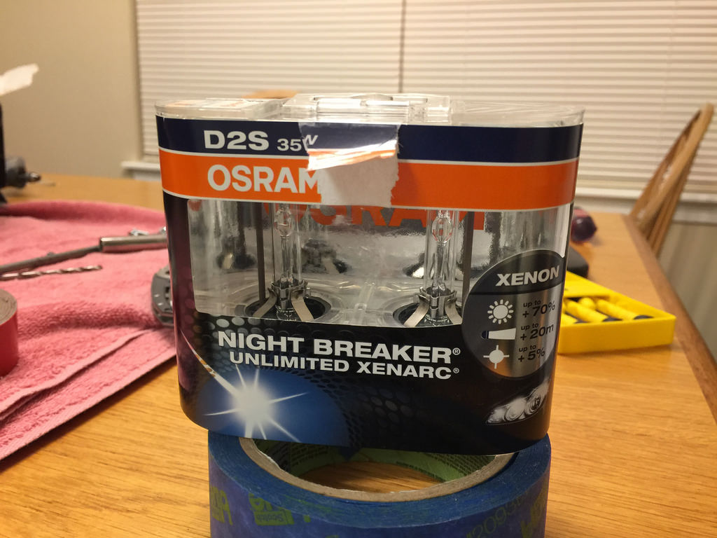

-Osram Xenarc 66240 Nightbreaker (4200K)

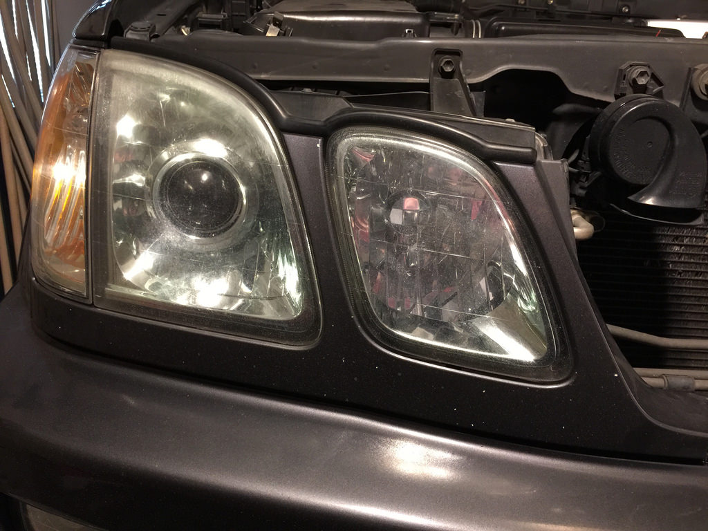

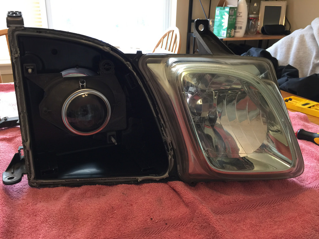

I began by removing and opening up the stock projectors. 7 minutes in the oven at 270* was perfect for opening them up. The lens came off pretty easily.

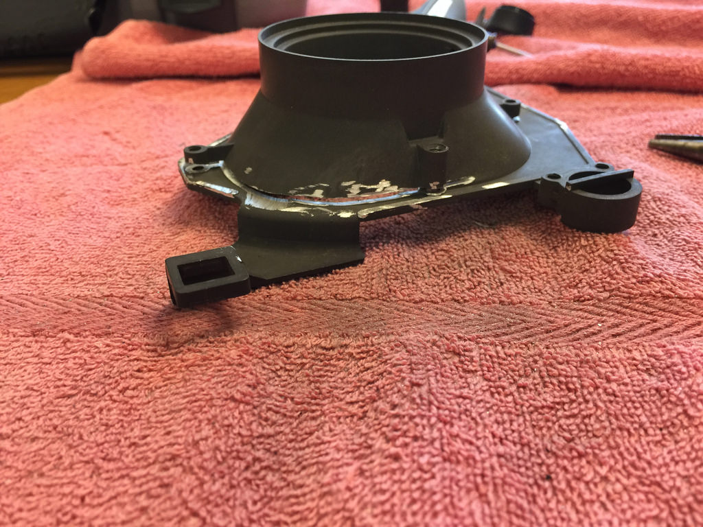

Then I disassembled the headlight and cut the stock projector. You need to cut the housing in order to use the stock mounting points. Try and cut it as flush as possible. I cut it from the outside but if I were to do it again, I would cut it from the inside of the projector. I used a dremel with a metal cutting disc.
I mocked up the TSX projectors and used double sided tape and such to tack the projector in place to test alignment and to level them. I tested with the stock TSX projector lenses in case I got them smudged or chipped since I was mounting and unmounting them on the truck with no lens on.

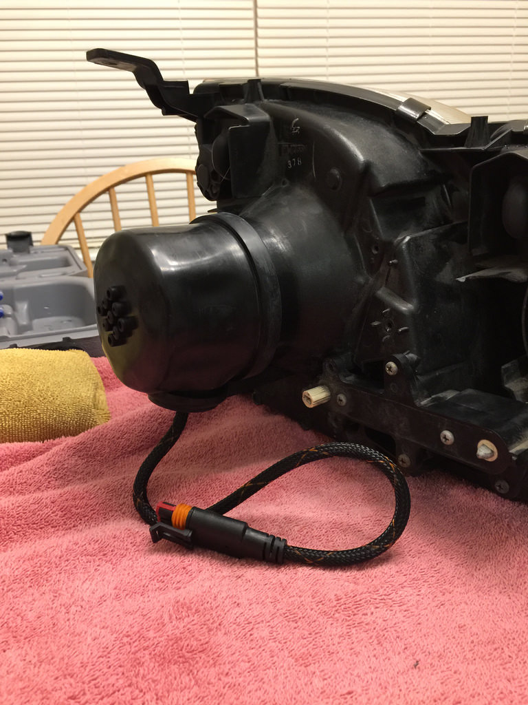

Then once I was happy with the alignment, I drilled holes in the mounting plate to attach the projector housing. Then I placed the new Retrorubber butyl glue and baked the new lens back on. Once again, I did 7 minutes at 270*. Then I cut the 80mm rubber caps to pass the wires through and mounted them up. I had to cut the bottom of the cap because the D2S bulbs use the ignitor on the back of the bulb and the wire points straight down.

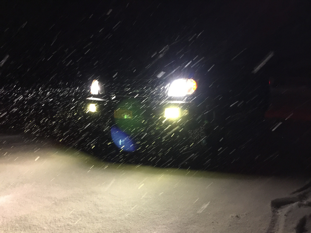

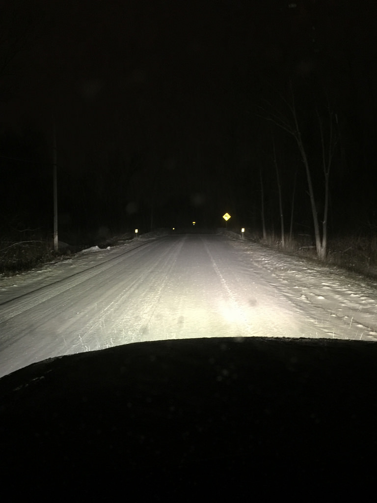

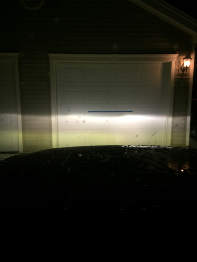

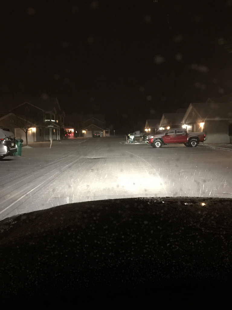

Output shots! I need the bulbs to break in and I need to work on aligning the bulbs some more. They are aligned well vertically but need to work on aligning them horizontally. The pictures are taken with different exposures to capture the light differently. I'll try and get some foglight only output shots tomorrow night.
The left projector got a little tilted somehow during final mounting so I'll need to go in and fix it another time.
Next up is to clean up my hideous headlight lenses and ceramic coat them to prevent further oxidation. Thinking I'll tackle this next weekend.
Dude awesome! I'm excited to see more people commit to this retrofit. I passed the igniter wire through the cap in the same way.
Maybe it's just your pic, but your cutoff looks a little blurry, any issues seating the bulb? Also did you compare output between the stock lenses and the clear? When I did, the stock lenses actually won my opinion, so would like to hear your feedback.

Thanks! It was my first retrofit so I learned a lot. The cutoff is a little blurry right now due to the projectors not being exactly aimed at the same height. The bulb seating is good but the projector seating in relation to the shroud was a little off in my opinion. Also, the slight tilt on the left projector is causing it to look odd. I'm going to try and align them a little better side to side to get a better cutoff but my hands froze tonight before I was able to finish aligning them so I just focused on getting them down so I wasn't blinding anyone.
TBH, a nice clean and crisp cutoff isn't all that important to me, besides looking cool. As for the lenses, I test fitted with the stock lenses and then mounted the FX-R lenese. I didn't notice a huge difference, but I did think it was a little more crisp with the clear lens. I'd like to open the headlights up again and work on them a little more, but it won't be for a while...maybe in the spring.
