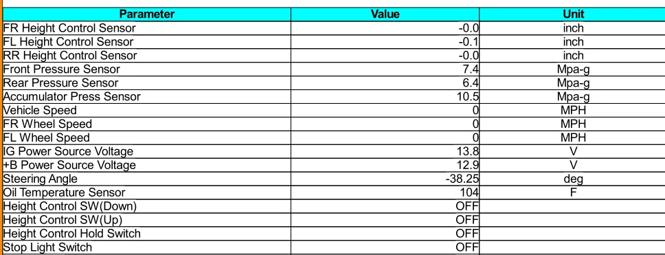

My cable finally showed up so I was able to get Techstream up and running. First install attempt was a big fail but the second install worked great! I was able to read my pressures and they seem to not be too bad, surprisingly! Front is a little high so I'll crank the TB's a little bit.
I was sitting in the driver seat so that may be the -0.1 FL reading.
Front: 7.4
Rear: 6.4
