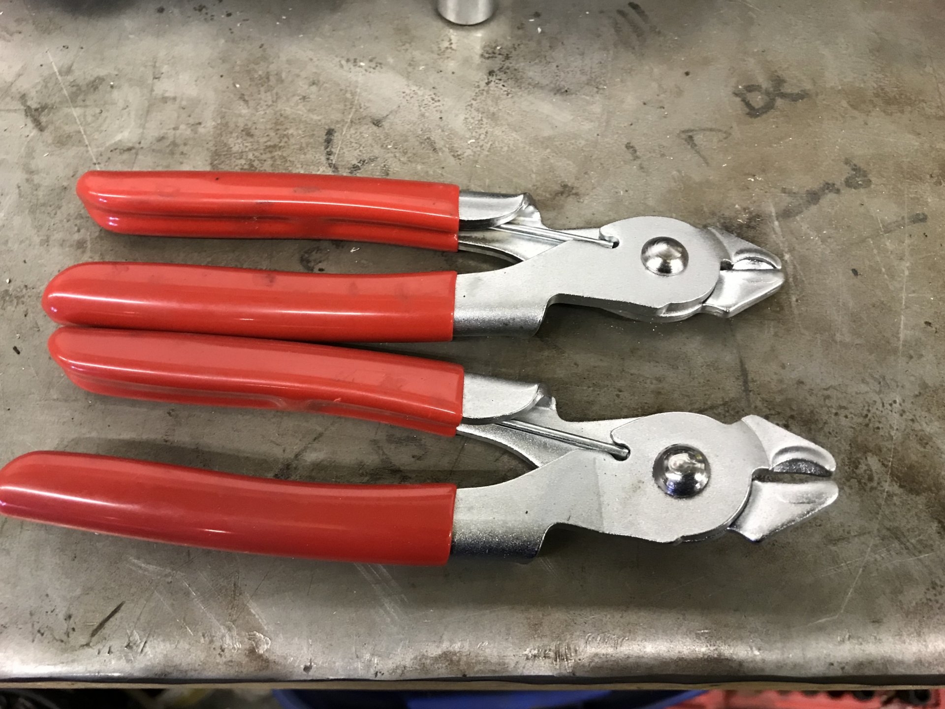

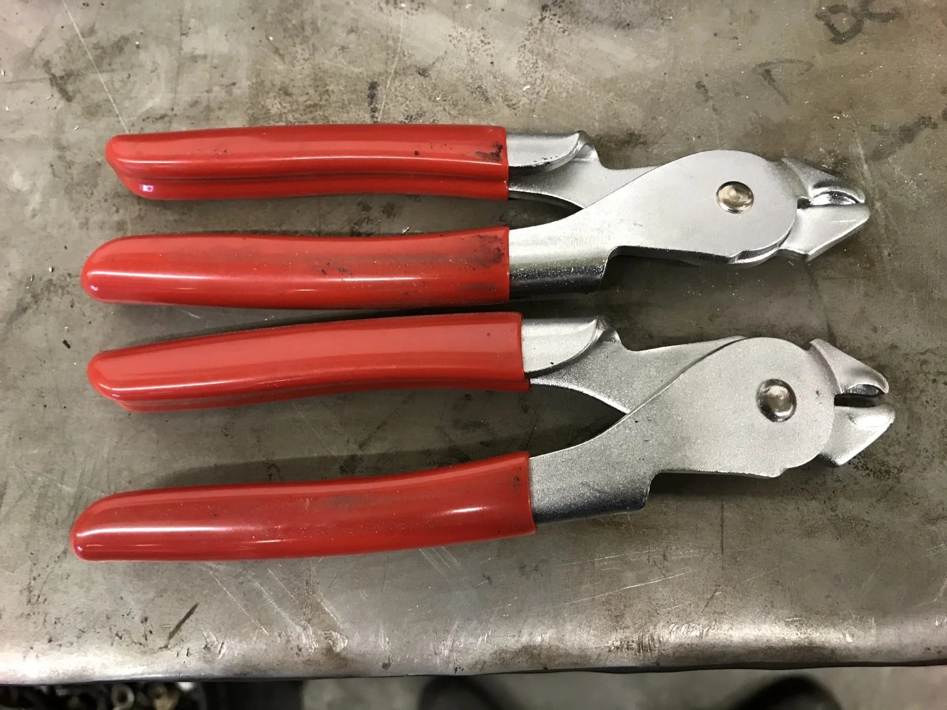

Just make sure you get the cast pliers, not the flimsy stamped steel or even worse, the plastic ones.
The pliers shown on here are nice ones with pointed tips for easier removal as well.
You'll also need a quality pair of needle nose pliers to remove what you have.
I have had these two awhile, done five or six seats with them. Zero issues.
I cut the old hog rings out with dikes. I use only SS hog rings.

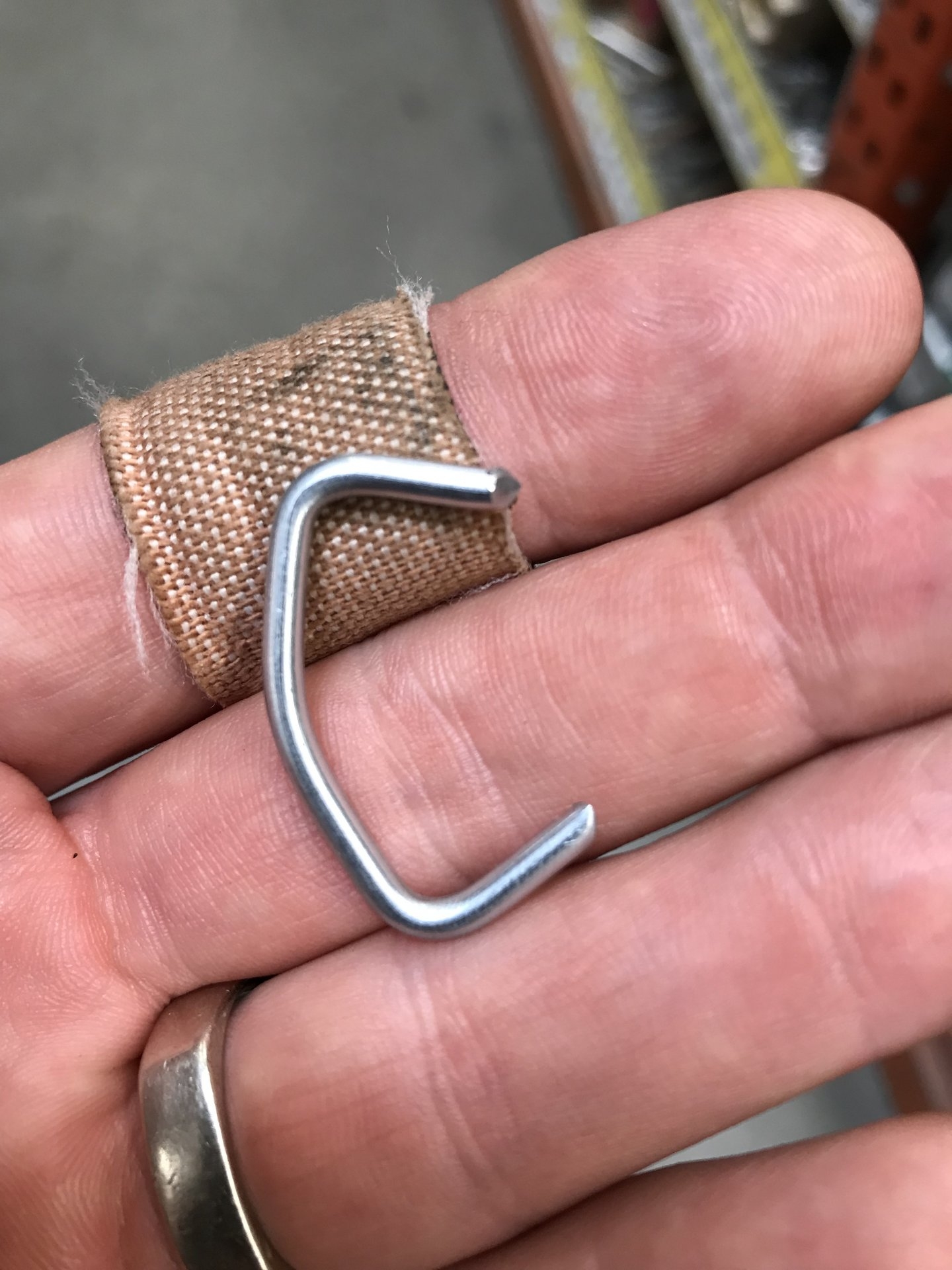

So the only Hog Rings I can find are 12g galvanized hog rings for chain link fencing. These looks substantially larger than the ones I just removed. What’s the school of thought on using the larger rings? (PS, the bandaid is for you @NLXTACY)
Problem solved. Local auto upholstery shop down the block gave me a handful of stainless rings for free. #Winning!
