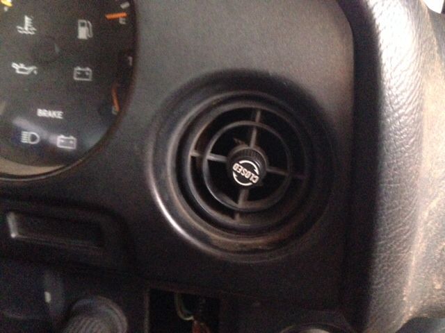

Also you looking for one of these
It's a bit stiff, but all looks intact, so how do I get it out
push one side in, and it will turn sideways, then just pull it out, its just a press fit into the cup
If you want the vents out without breaking them, you will have to remove the whole dash pad. They are held into place with two or three small screws from the inside. With age they get brittle and pulling on them to get them out of the holders is hard without breaking them. Ask me how I know :censor:. Hope that helps you out. I'm looking for some replacements also.
Well spud there's our answer. If you ever get the dash to that state let me know and I'll shell out for it. Don't worry about it until you find you need to deal with the dash being out one day, you've got much more "fun" things to deal with in the mean time.
Thanks bluehawk.
Hey guys thanks for the comments regarding the vents, I've already found a reason to pull the dash apart, I want the facia off it, as the glow plug light cover looks like it's been poked with a screw driver on mine, I doubt it can be fixed, so there you go, there's my reason and I'll let you know when the vents are out :cheers:
