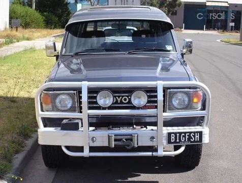

Do you know a source where i could get the acryl headlight protectors for the models with the round headlights.The model that just snap on.I think they were once made by EGR and even sold by Toyota Aus.I can only find the square model headlight protectors.I included a picture off the round headlight model on a Aus Hj60.

Yeah the round headlight protectors are pretty much non existent these days. Maybe roodog will have something?

Here you Sved
http://www.ebay.com.au/itm/291041071179?
This is the same guy I buy my bonnet protectors from,
Sved if you want me to get them for you, PM me mate and they'll go in your box :cheers:
Crick, that's awesome mate :)

Wow, what a beautiful truck!
I don't know the answer to your question perhaps eBay, but how did you manage to fit a winch on the alloy bull bar?
Hey Nex
It's fairly easy actually and I will be doing as part of my build.
With the 60 there is quite a bit of room between the body and the ends of the chassis, you need to purchase a winch craddle they are about $90 (can put a pic up if you want) you then mount the craddle to your chassis, takes all the weight, then cut a hole in alloy bar and you have a winch on a alloy bar :)
