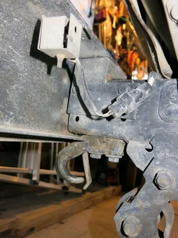

I decided whilst at work today to go and checkout an old wrecked Sahara, I knew someone had already ripped the console out :bang:
But I thought, hoping really that they didn't take the sensors, so I couldn't find the inside one, that must've been an easy find for them.
But I found the outside one, just gotta know where to look
Gotta keep searching, you never know :cheers:

This ones been sitting out in the weather for a while, so hopefully it will be ok, or you could rip out the inside one and sell it to me :)
Does that pig tail for the outside one have a blue connector on the pig tail....than would be located behind the passenger side headlight? I have a blue female connector there that looks to be missing the mail end
Hey mate don't quite follow what connector you are talking about, but I don't have that end piece yours has, I thought that was just a protective cover, I have to go back out to this Sahara so I'll have another look
