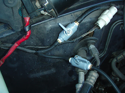

So I am still very much in need on this Vaccuum diphragm valve... Anyone havea line on one? Parted out blown up 12ht anywhere in the world?
Here are a couple pics, also note that 2H one looks almost identical but wont work as it has a different bracket and a different stroke length (if you click the pics you will get a blow up):
I have not found a part number yet.

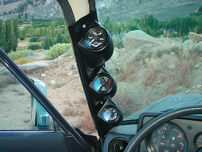

I also finally got around to installing my gauge pods for a month long trip in eastern NV and the eastern Sierras. I put in 24v gauges for trans oil temp, turbo boost, and a pyrometer. Install pic:

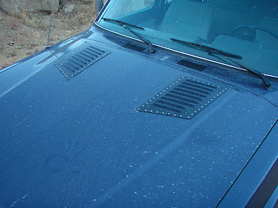

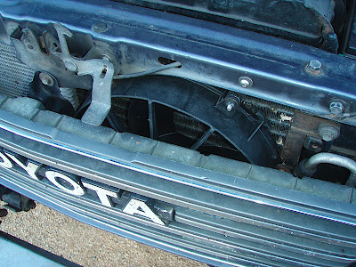

I also did some other mods to allow the truck to handle heat better...
A SPAL 24v 12inch pusher fan (which of course required moving the trans cooler and modding the central upright and grill):
Hood louvers to let heat out:

I have been using the set up for several days out here in the desert and its been doing great. Two questions though:
1. Now that I have the pyrometer I am concerned about my EGTs. Its pretty hard to keep out of the red which starts at 1050F or so. What is a safe range for a 12HT?
2: I have yet to figure out where to install the thermal sensors for the trans oil and engine coolant (to turn the fan on automatically). Anyone have suggestions for a 12ht?
Is your pyrometer pre- or post-turbo? I think pre-turbo pyro EGTs should not go over 1200 but I could be wrong on that.
