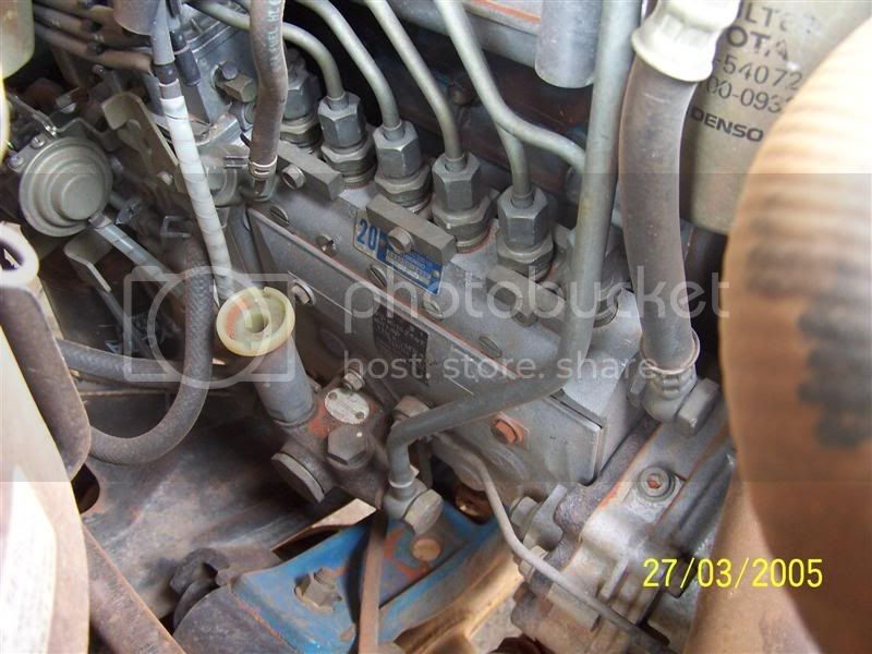

So I seem to have figured out my vacuum mysteries with the great chart pointed to in the previous post. The downside is that I have also determined that my vacuum actuator is bad on the 12h-t. The diaphram seems to be leaking and its not the same as the one on the 2H. Both G&S and 4Wheel Auto (who usually never fail to find my part) cant come up with this one... Anybody have a lead? (click the pic below for a larger one)
Can you post up a pick. I know someone who may have one.
Ill need a better pic to make a positve identification. It would be good if I get it by tomorrow morning aust wst
Here are a couple pics, also note that 2H one looks almost identical but wont work as it has a different bracket and a different stroke length (if you click the pics you will get a blow up):
I have not found a part number yet.
Zander no used available and Toyota says none in oz . Its 3 weeks from Japan and the retail price is $126.38 AUD.
Try Japan 4x4
The oz part number is 261133 6804

Well this vacuum idle up valve seems to be very elusive. I think mine was damaged on this crate it came over from AUS on after pulling it and inspecting. I am told the part is no loger made, but the part number is:
88031-60050 Actuator set, idle up. HJ61
In any case i pulled it and have taken some better pics:
http://picasaweb.google.com/longnow/LCFrameSwap/photo#5004523017508891778
Anyone know about a blown 12h-t or one that is being parted out ANYWHERE?!?!
Well thanks to Japan 4x4 I now have a part number on the vacuum idle up valve:
The bad news is that Toyota Japan doesnt have any and NO ONE can find one!!! Any leads appreciated.
