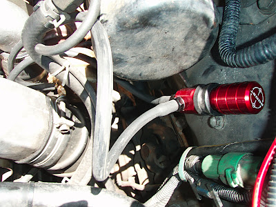

Just got my Hallman dial-a-boost unit in from Extreme PSI which I will install when the rain/snow stops. By other accounts this should lower my EGTs.

So the Sierra storms cleared and I was able to install the Hallman RX boost controller. It seems to be the perfect one for the 12ht. At almost full boost I have it sitting at 14psi (could likely get 15 psi out of it). This gives me about 30 turns of resolution back to standard boost of 7psi. Nice unit all around as it has a ceramic ball inside instead of metal, and it is built with plenty of friction on the dial so you dont need to lock it. They also sell the cable kit so you can control it from the cab.
Anyway the new mod is definitely a good one. Increasing the boost does help the EGTs for a given speed, and now I can go a lot faster up the grades out here in the Sierras!
Cool.. just installed the same Boost controller on my 1HD-FT this evening..
except I don't have the ceramic ball.
Goes like a rocket at 15PSI
Backed it off to 13PSI for now.
Yeah now mine is peaking at 14, but cruise speed on the highway is 7-9psi and so only goes up into the teens when accelerating or on big hills, so it doesnt spend too much time there. I am very happy with the quality of the unit, would definitely recommend.
