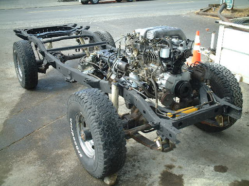

Now I just add the exhaust brackets and push it back across the street to my mechanic who will be mounting the engine/tranny, and putting the body back on. I will post some pics as that goes together.
Lots of pics of engine mounted without the body... please:)
I will be doing a 12HT swap in the future and hope for many reference photos.
Thanks,
Phil
Finally got the motor and tranny bolted together and mounted into the frame today...
pics start here:
http://picasaweb.google.com/longnow/LCFrameSwap/photo#4981732383964135442
I took some pics with a tape measure to give folks some reference points. If you want more or different ones let me know. Also note the tranny mount is not mounted in these pics so there might be some shift still to happen. (I got the wrong tranny mount somehow)
