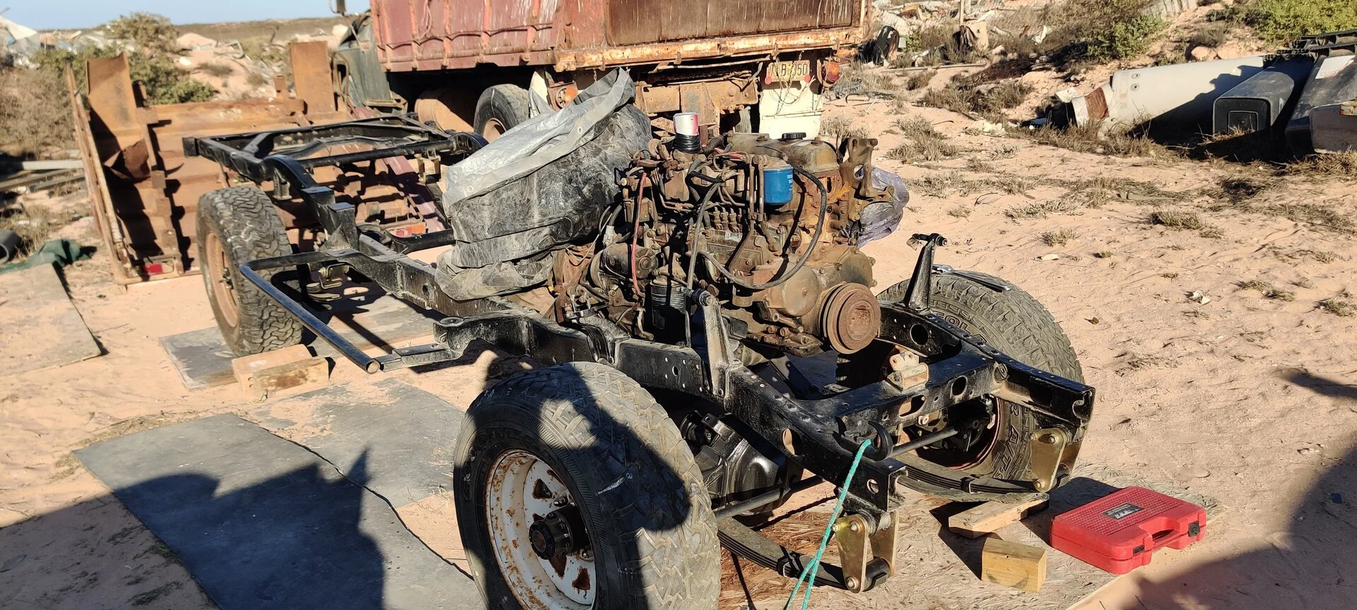

After working over both of the 2H engines that came with my HJ47 Ute it seems both are low on compression and needing rebuilds.
Luckily I've obtained a complete HZJ75 troopy as a doner car with a 1HZ turbo and going to attempt s conversion but have a load of questions before removing the engine from the troopy to begin installing it to my 47s rolling chassis
