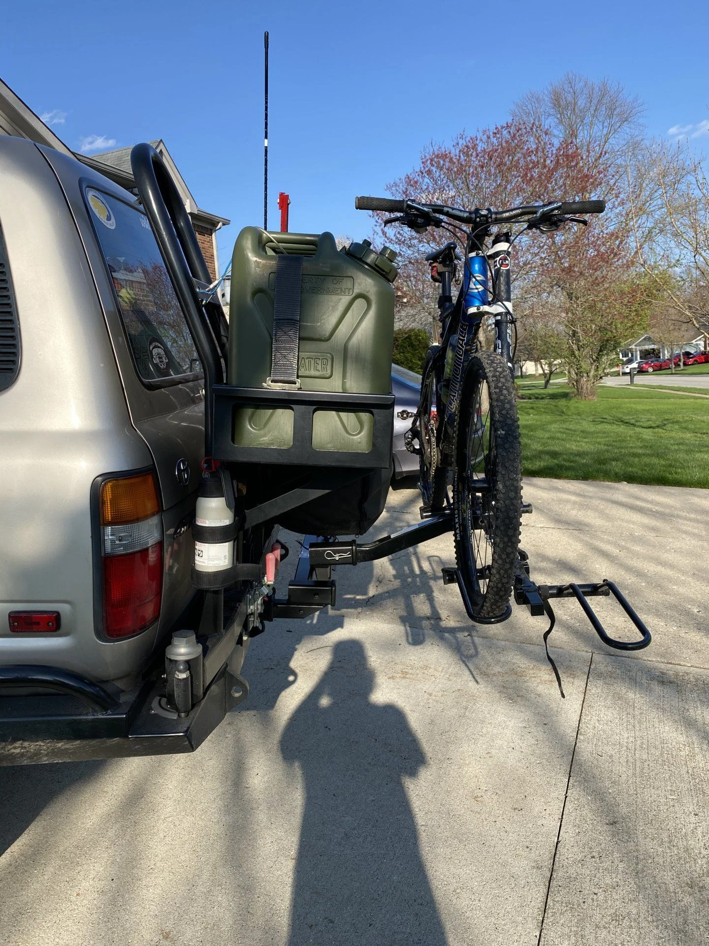

There is a photo above of the drivers side swing out of the rack attach. I’m fairly certain it would clear on the Jerry can side. I would really prefer passenger side swing on the Wilco if you are on the side of the road.

There is a photo above of the drivers side swing out of the rack attach. I have the Jerry’s and the tire swing. Ive emailed Wilco. At this point I’m willing to try about anything. My preference is not to add more weight to a swing out. Supposedly the spindles can handle #3500 but Slee ain’t saying. The Wilco is brutally expensive and the return policy kind of sucks. It would cost me somewhere around $200.00 to find out.

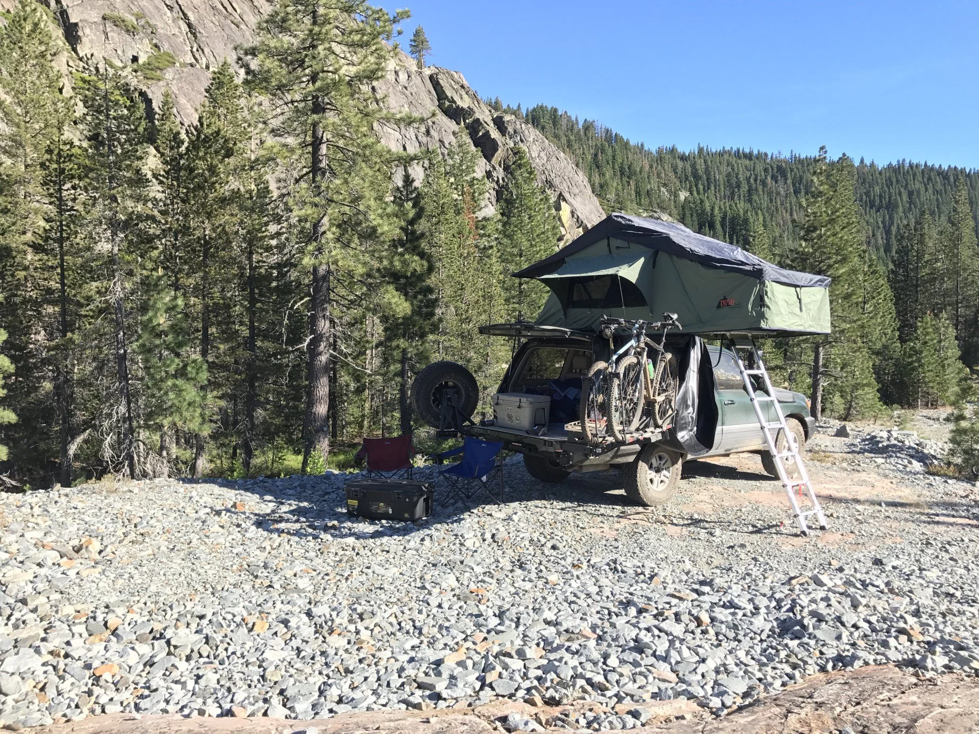

The ONLY way I could get my Yakima Holdup to mount to my BIOR dual swingout bumper was to run a 4" drop receiver. Even then, the tire swingout BARELY clears the tire tray if and only if the rack is tilted in its downward position.

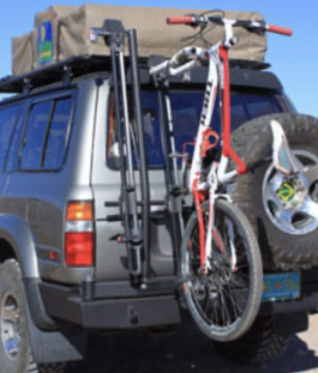

I'll be getting the BIOR rack this summer that mounts onto the swingarm itself and holds 2 bikes in a vertical orientation.

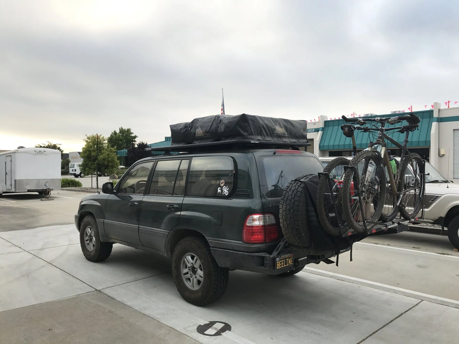

here’s my setup and the one I want
Hmmmm, fork mount.... Would prefer two wheels somehow. Thank you for sharing that.
Fork mount would be more secure when off-road though. Only issue is that you have to then stow the front wheels which is a pain.
Yep, truth. I've become really happy with wheel tray racks.... Going to figure out a way.

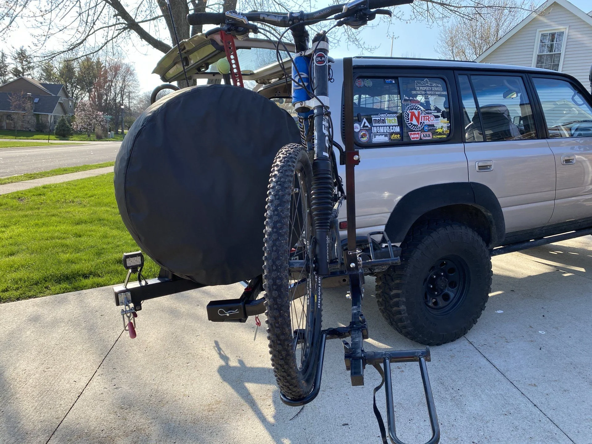

It’s a Slee. I wasn’t excited about the cost either but there is no other option to retain use of your swing outs. When I travel with my bike I don’t want to have keep taking it on and off. Order the Wilco through Amazon. Free shipping if you’re a prime member. My bike rack is a cheapie from Amazon. A 4 place Swagman I think. It was maybe 200$ or so. It holds the bike well. He Wilco is top notch quality. It’s worth it.
Jonesy, So Slee dual swing out rear bumper(tire on pass side, Accessories on Drive) then WIlco swing attachment as well? And Wilco mounts on the Receiver hitch of the Slee? Just trying to get my head around your setup which looks awesome btw!

Yes, i think thats the only way you can get them. Tire on passenger. I have the hitch that goes though the bumper and cross member and fasten to the frame raiIs. The standard Slee hitch wold probably work too. The Wilco allows you to pull a trail with the Wilco swing out on.
