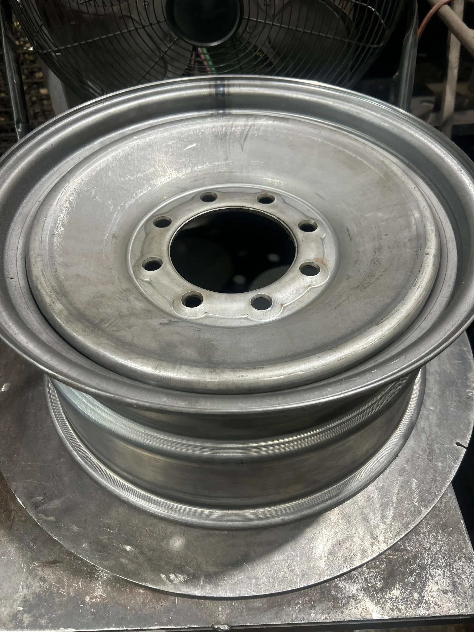

so i don't think the USwheel option will clear brakes even if i downgrade to '99 calipers and rotors. i reached out to diamond racing wheels (they make wheels for dirt track stuff and people put them on civics when i was in highschool). they actually have a wheel that isn't bad:

diamond can make these in a 17x8 with a backspace of 5.75" which is around a +32mm offset. if i paired this with the correct tire (255 section width) it would actually be a little narrower than stock:
only thing is that 255/85r17 is a really weird tire size and i think mickey is the only manufacturer. i could go down to 255/80 and the options open up a ton.

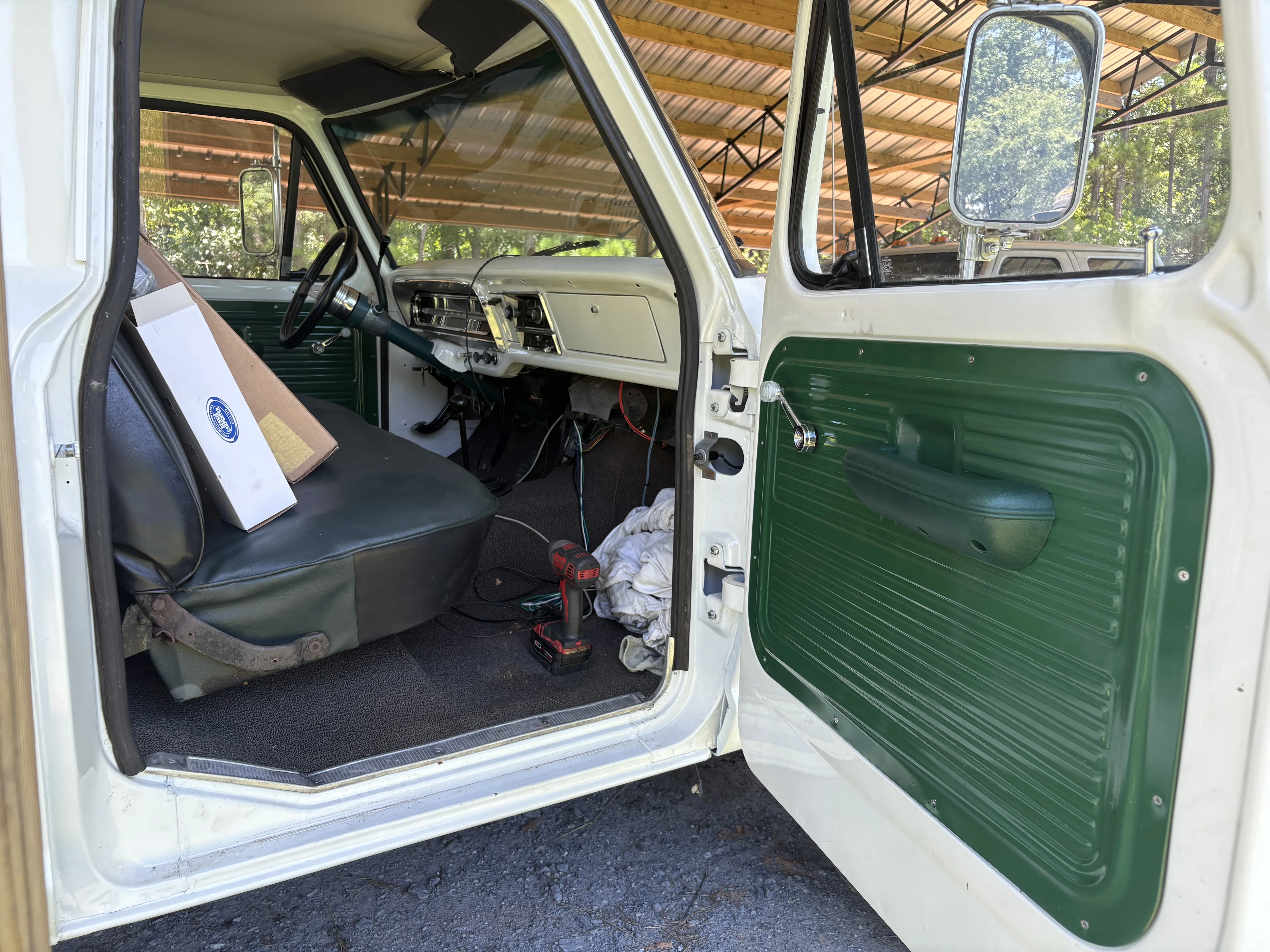

another ford weekend for me. made a little bit of progress on the truck. first is door panels - they're installed. i painted them green and it doesn't really match the arm rests so i'll have to revisit. when it's not in broad daylight it looks like it matches though. i am still waiting for the upholstery shop to get it together and send out my seat upholstery. i'm a patient man but it has been 11 weeks lol.

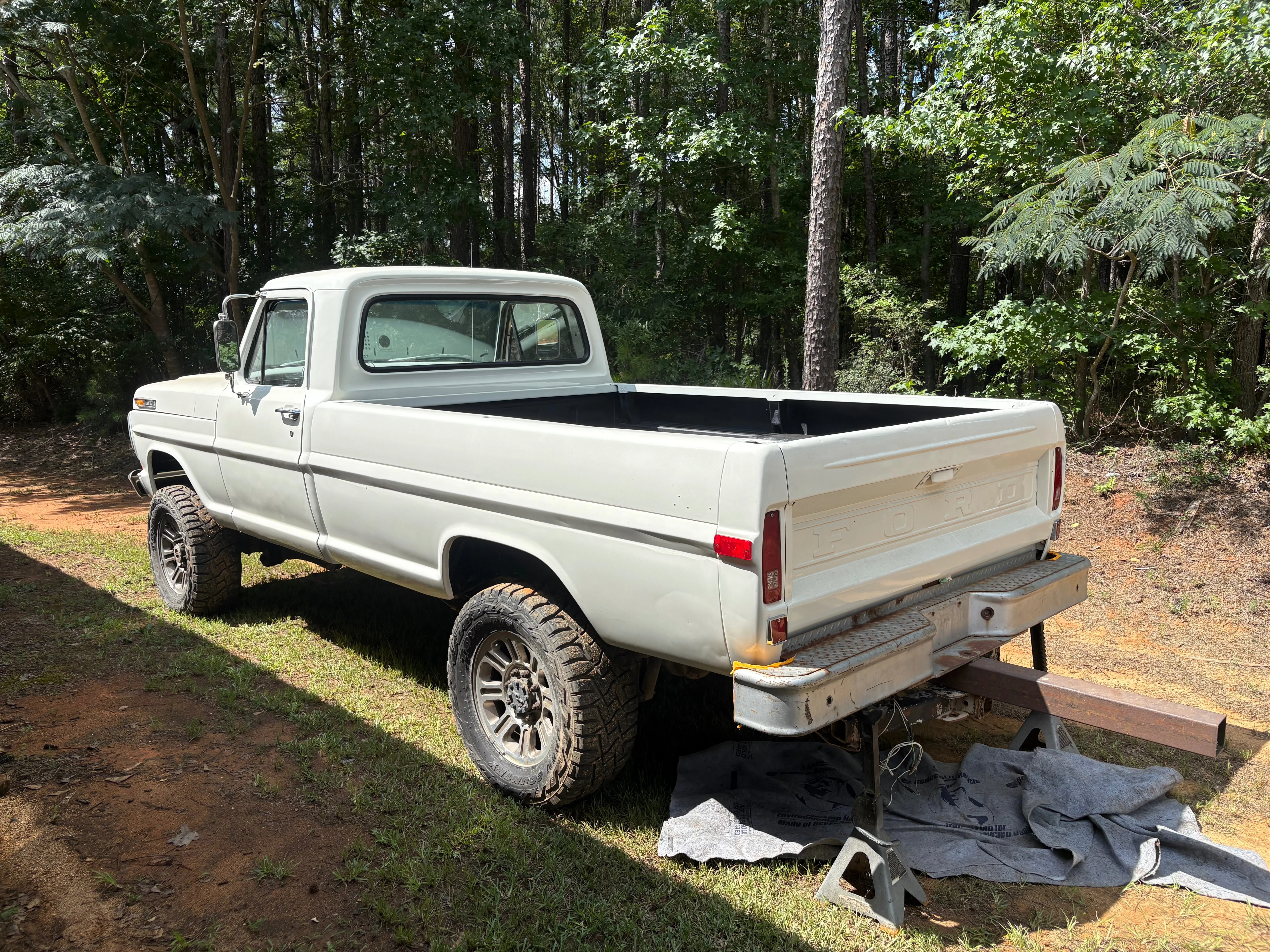

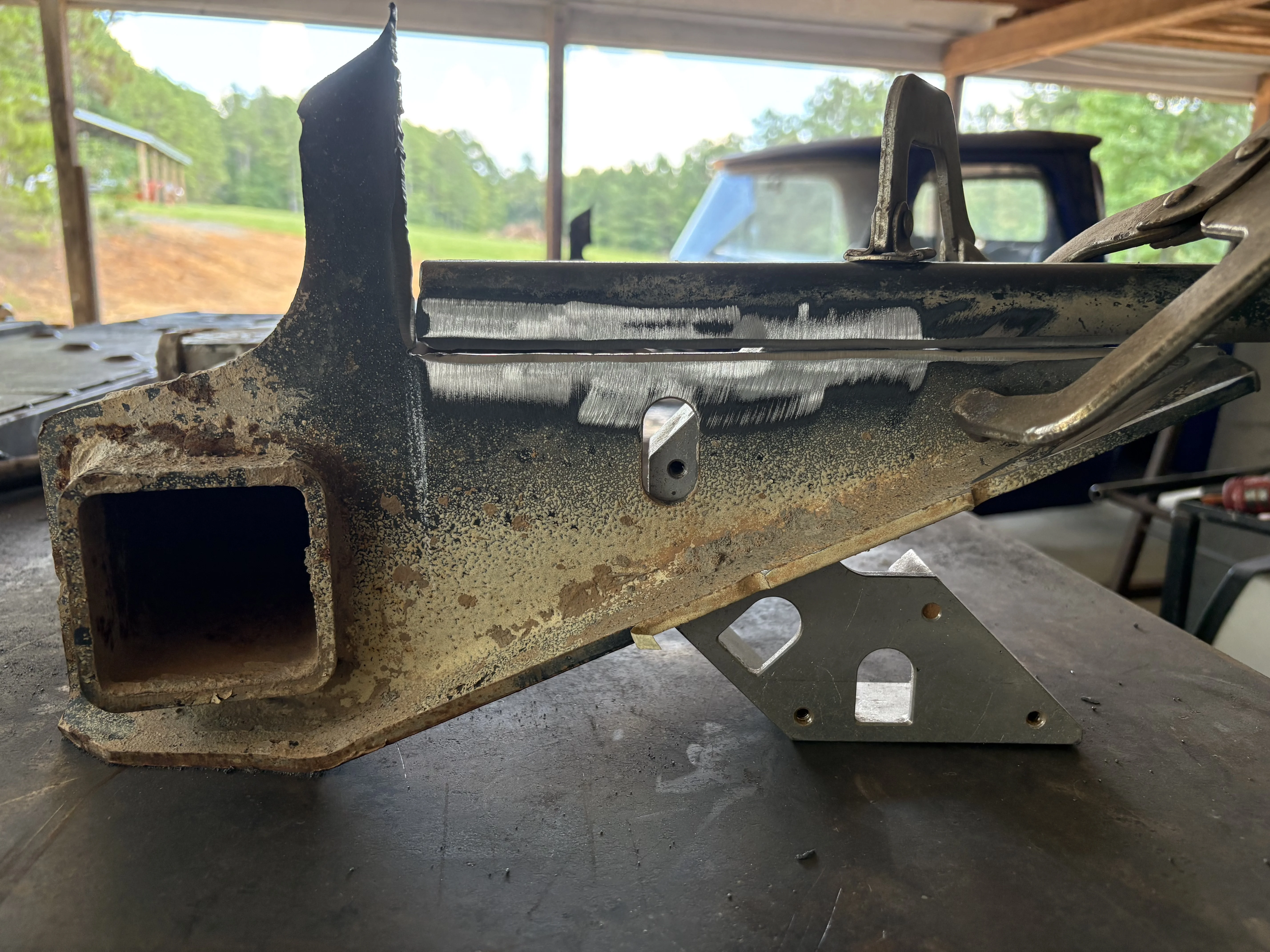

i have also started cutting down the tow bar. i took about 4.25" out of it and will use it as a bumper mounting solution since it will bare all loads from towing instead of the bumper like it may have back in the 70s. finally got to use this square from fireball tool. we never can seem to find a great application for it but it was super handy for this task.

and here's an idea of what the bumper will look like. i didn't finish mounting it because i think i want to strip the paint off of everything and get it looking decent.
