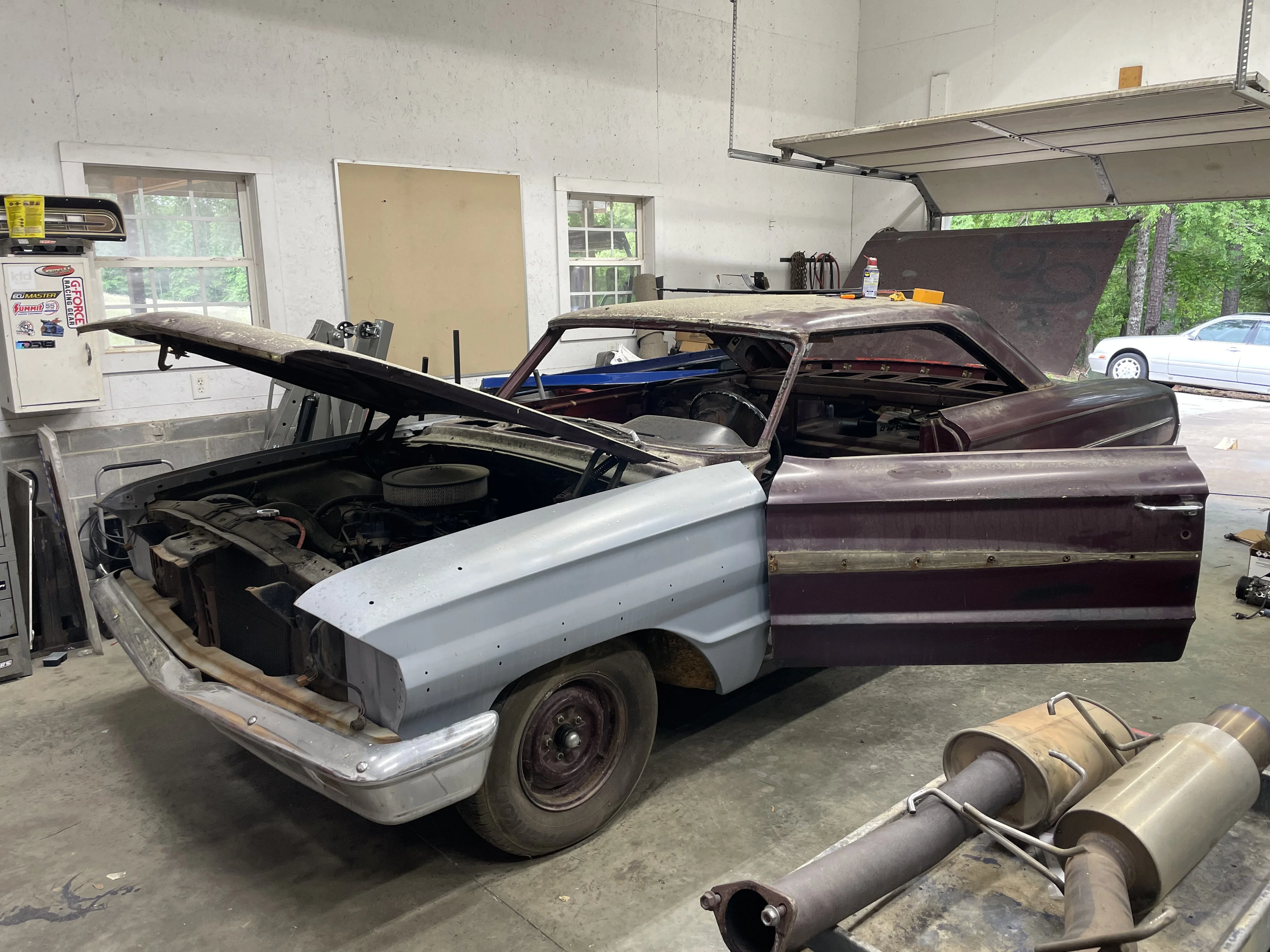

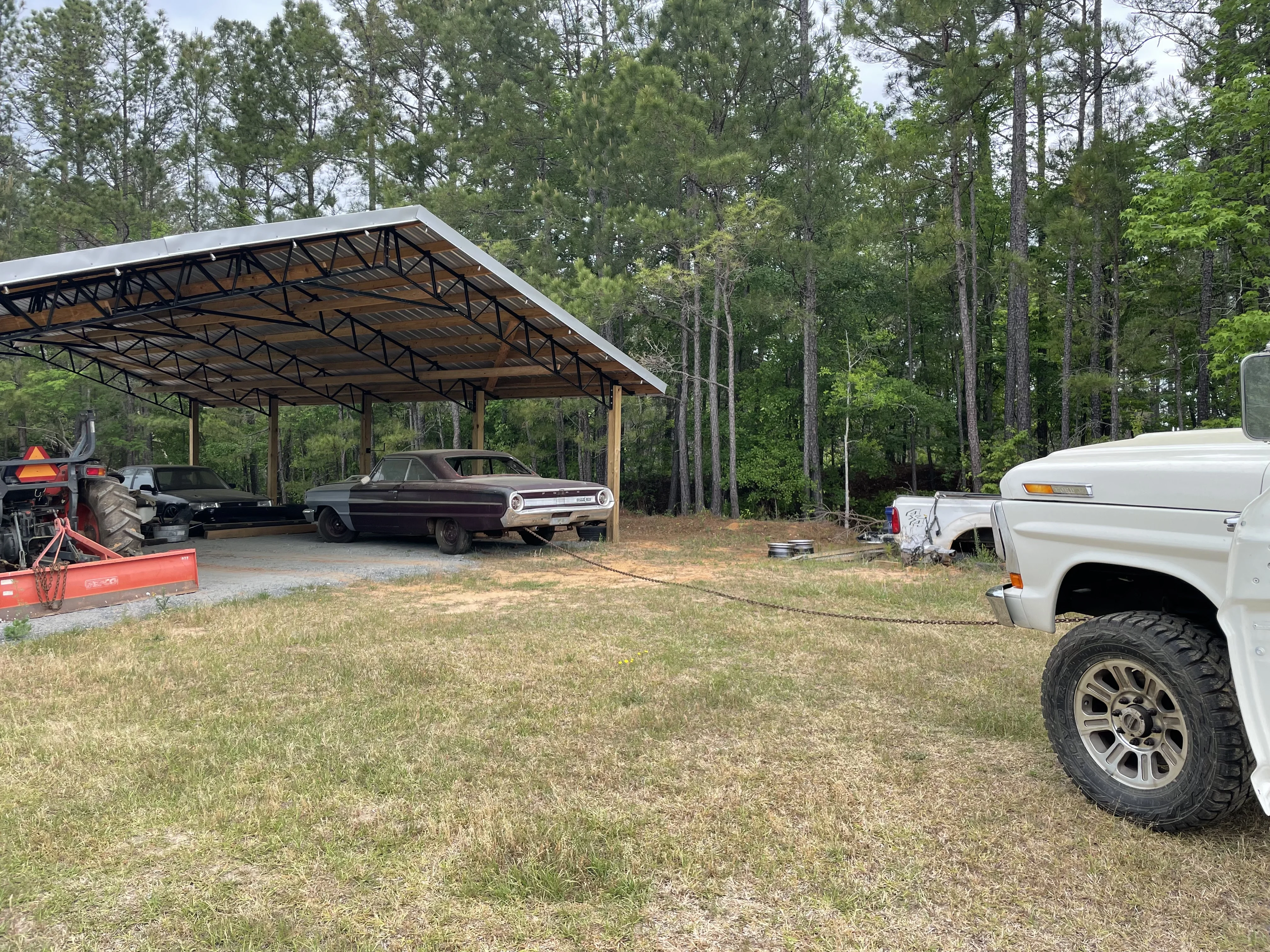

finally got to use the truck a little. dragged out my galaxie to start work. does this count as a barn find?

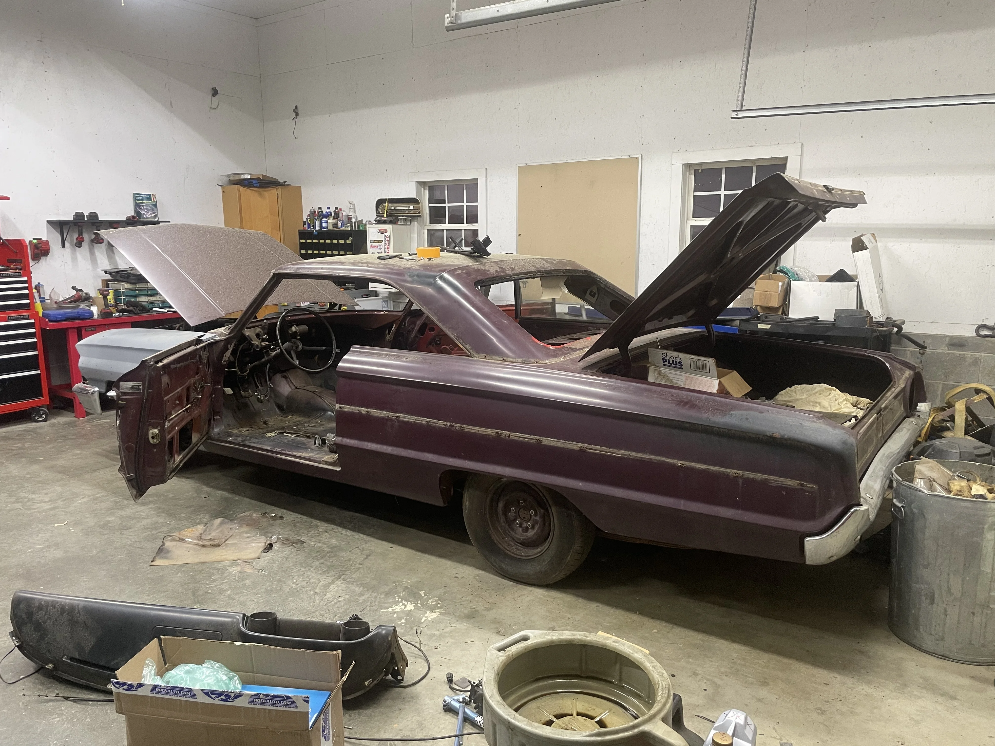

lots more parts on one of these... took all weekend but it is totally torn down and ready for body work. fortunately it only needs a little bit of rust repair in the trunk - my goal is to get this one painted quickly and on the road to enjoy but we know how that goes.

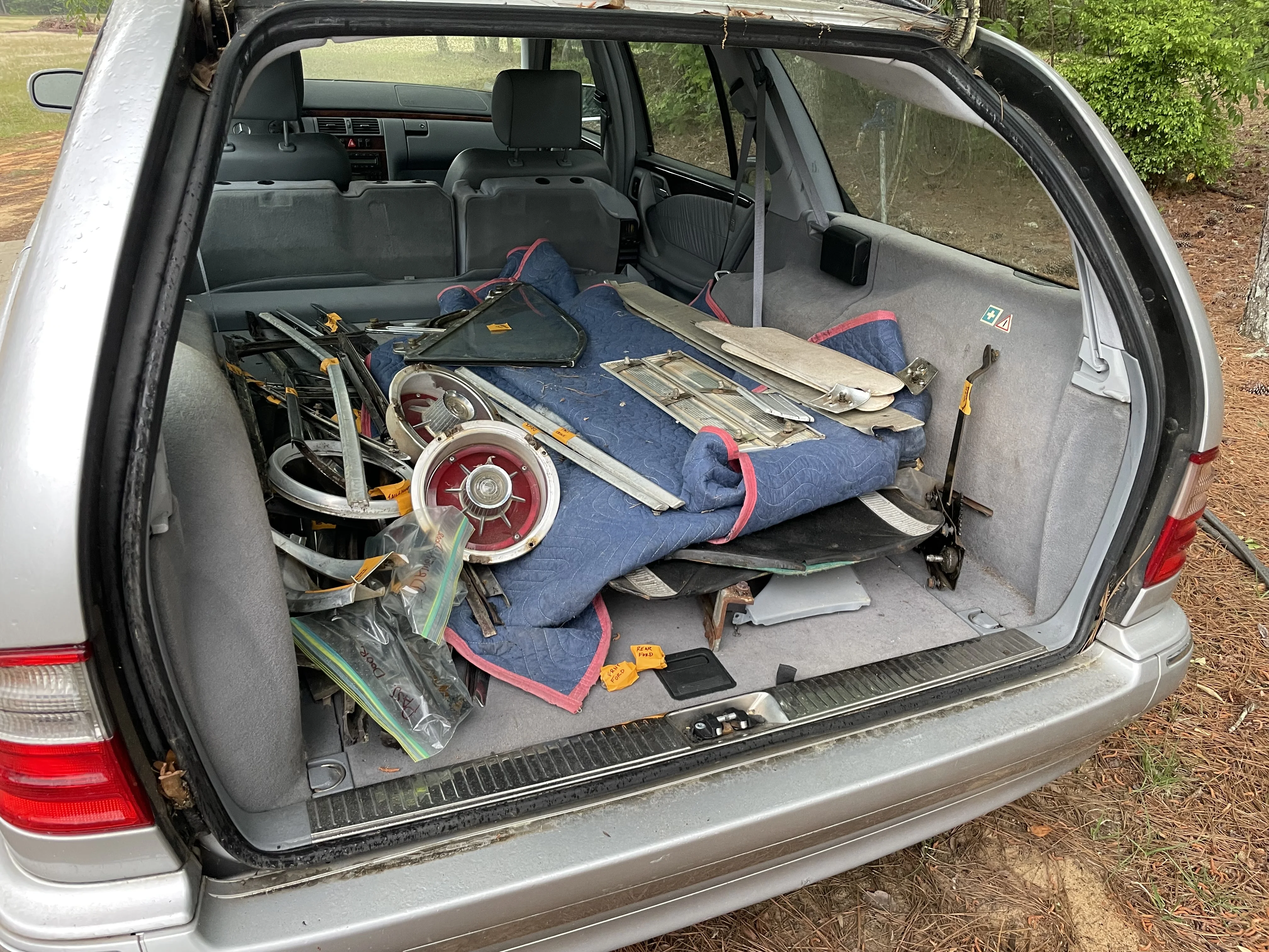

finally found a use for the mercedes :clap:

What year Galaxy and what’s the overall plan ?

Oh sweet! The '64 Galaxie is my all time favorite early 60s big body sleeper rod, only the 64 has those lines. I've actually considered (briefly) selling my 62 to get into one.
What's the plan...resto, cruiser, street rod? Motor?
ya know i haven't really gotten that far. i will be painting it wimbledon white coincidentally. picked the color before i even bought the f250, plus i have almost a whole gallon left over that i refuse to let go to waste. i'm a big fan of white on red so that's probably the direction i'll go.
my original plan was to just do body work, paint it, and enjoy it but... the body comes off of the frame so easily and i already have a dolly... and a friend who could have the frame sand blasted in an hour. you see where this is going. current thoughts are to put the body on a dolly and paint it, have the frame blasted, do a little reinforcing/suspension work, and paint it in a decent two-part frame paint. the 289 in this thing is dog tired - i'm talking absolutely will not pull the car unless it's warm - so i'll likely put a pretty plain 351w in it for the time being. the goal is really to have a respectable cruiser and see where i want to take it from there instead of going straight to complex engine swap/frame swap like i did on the f250.
