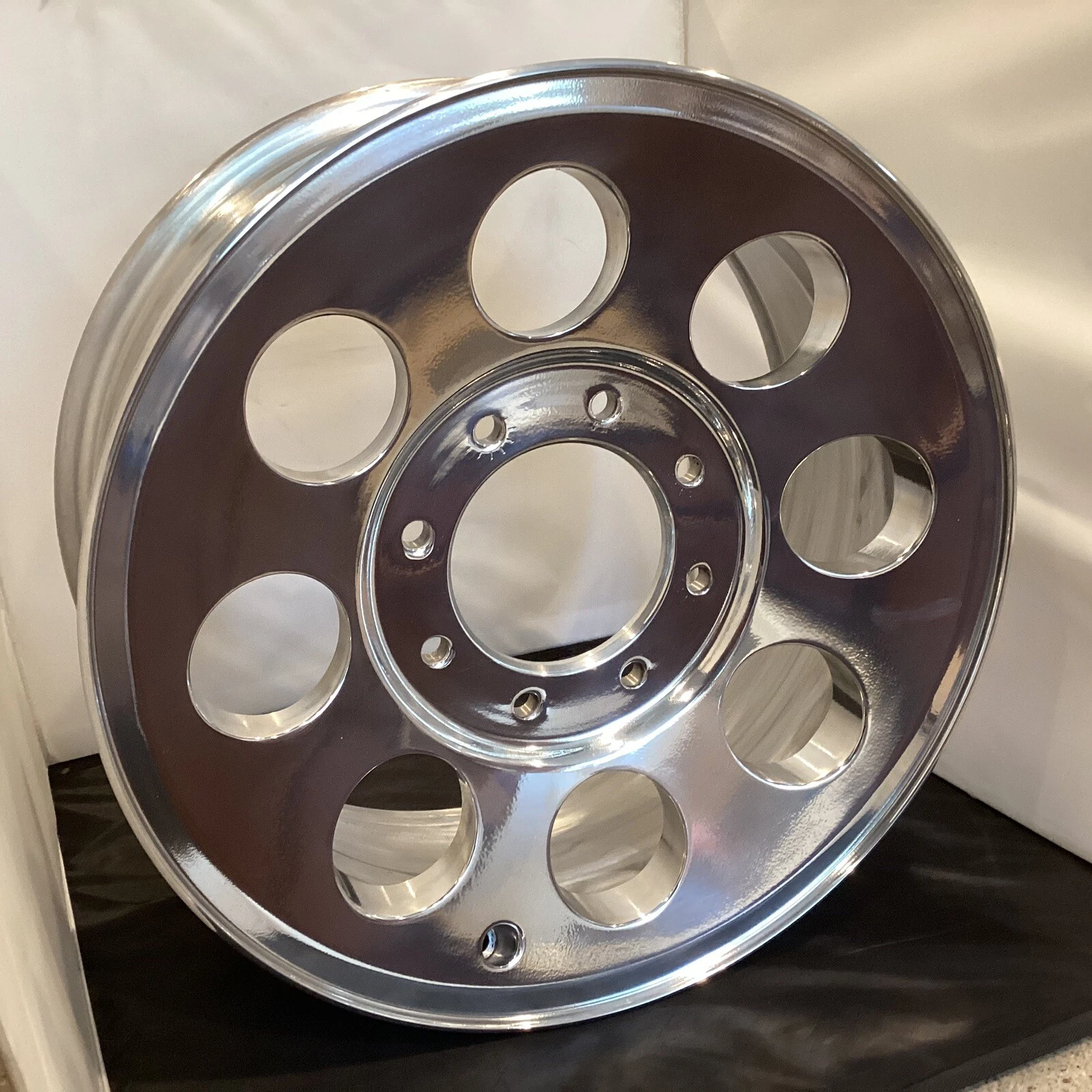

there's also this wheel which is an OE ford SD wheel with the right offset and brake clearance... it's close to the MT 8-hole wheels that were cool in the 70s/80s. i dont know if the look would feel uncanny valley or not but i bet i could find some locally for relatively inexpensive.
  • Like
Reactions: PIP
or
for true period correct classics

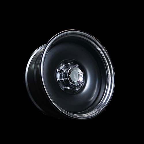

detroit doesn’t seem to offer them in as high of an offset as i’d want. i’ve browsed wheelsmith and i don’t see where they have anything in 17” diameter in 8x170 but admittedly haven’t read the entire site
so i don't think the USwheel option will clear brakes even if i downgrade to '99 calipers and rotors. i reached out to diamond racing wheels (they make wheels for dirt track stuff and people put them on civics when i was in highschool). they actually have a wheel that isn't bad:
full
for reference, the king ranch wheels on the truck currently are 18x8 +44. tires are 33x12.50.
diamond can make these in a 17x8 with a backspace of 5.75" which is around a +32mm offset. if i paired this with the correct tire (255 section width) it would actually be a little narrower than stock:
only thing is that 255/85r17 is a really weird tire size and i think mickey is the only manufacturer. i could go down to 255/80 and the options open up a ton.
You can call either and they will make whatever backspace you want. Here are the Detroit's on out last years SEMA BOTB 1974 F250 with SD axles.
20 x 8 with 40 offset 8 x 170 pattern.
Interesting - i actually didcall detroit and they told me they couldn't do it. perhaps i should call again and hope i get a different rep.
