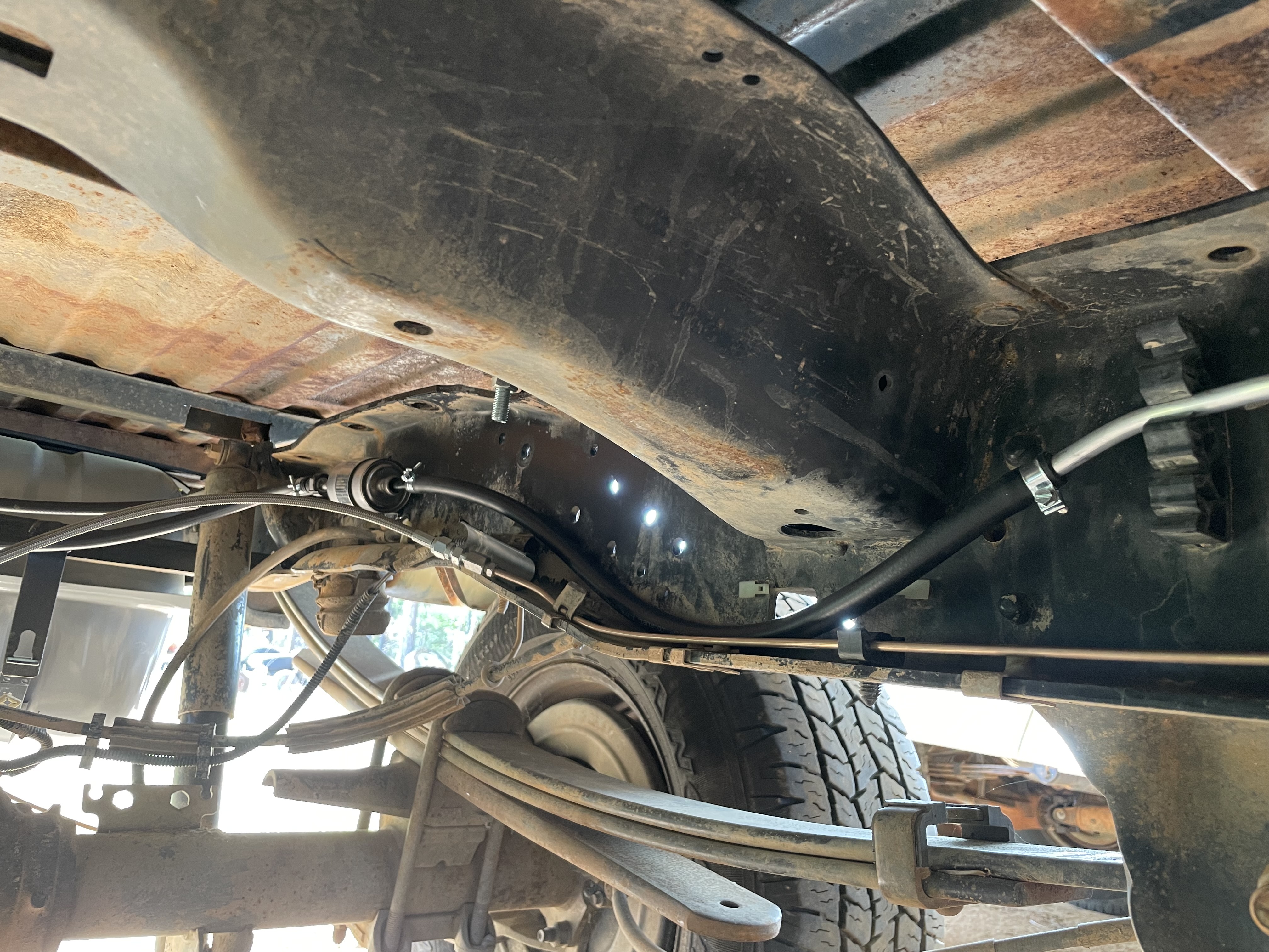

Little more progress but nothing too exciting. Finished up the fuel lines - the C5 Corvette return-less filter/regulator setup really simplifies things. I plan to clean up the lines some more but need to dig through my pile and find some more factory fuel line clamps. I don't like the way parts store P-clamps look.
I did a small bubble flare on the ends of all of my hard lines so the rubber lines won't slide off under pressure.

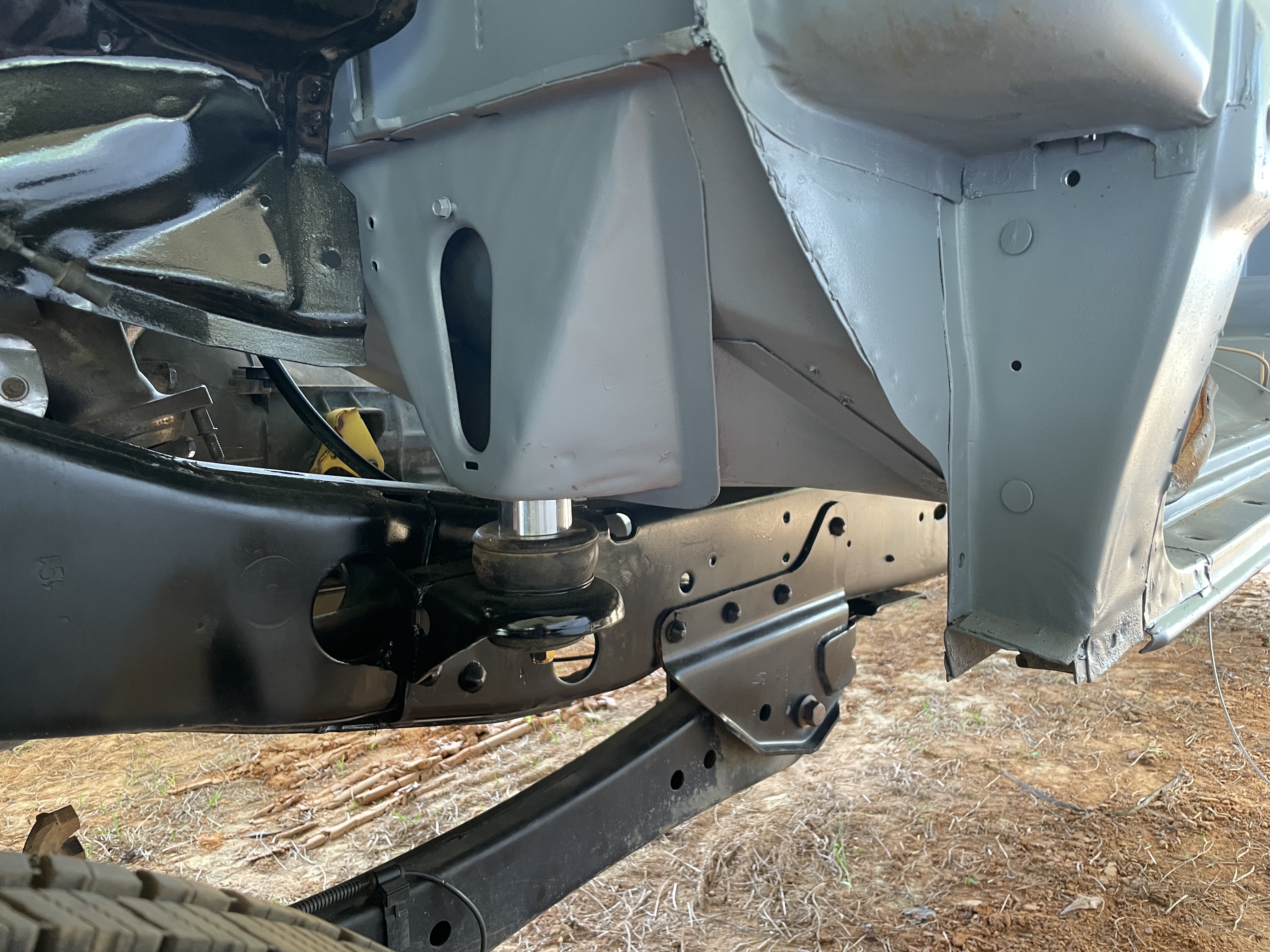

Also got my body lift installed. Just ordered some aluminum spacers from McMaster for like a quarter of the price most retailers wanted for practically the exact same thing. I don't think the truck looks too high at all and it solved all of my drivetrain clearance issues that I was having.
full
full
Shimmed rear passenger cab mount to get the body line a little closer. I'll still have to fine tune all of it once panels go on.
Also finished up all of the brake lines to the master cylinder and finalized the vacuum booster mount so I could theoretically bleed the brakes now haha. Next steps are:

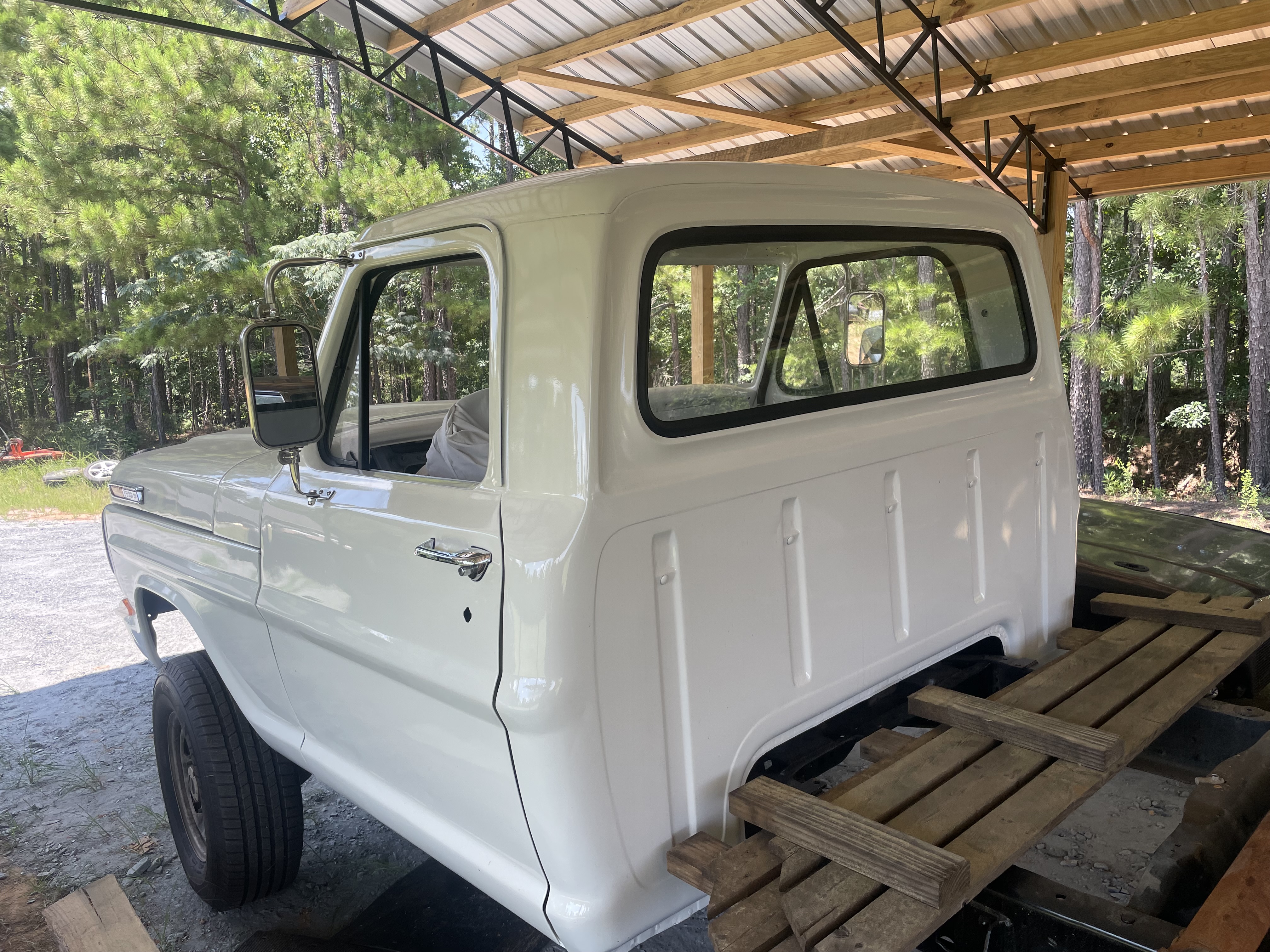

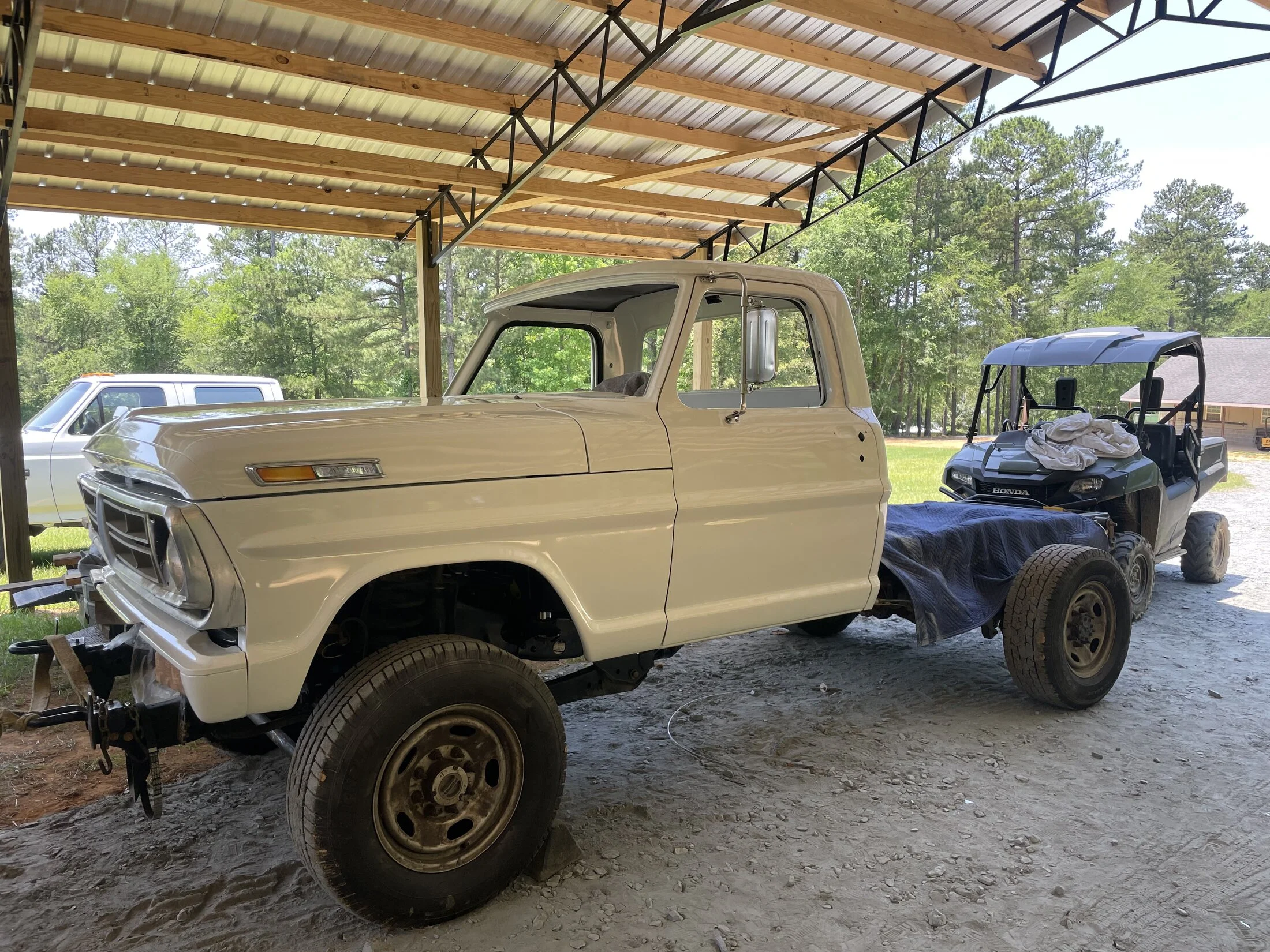

Goodness fellas it has been a minute. Been building the nerve to break out the paint gun. Went with wimbledon white in base/clear and couldn't be happier!
Interior is also wimbledon white and I'm thinking I may go with a green interior (dash pad, door cards, seat, carpet) but not totally sold. The traditional interior color for wimbledon white would be a dark reddish color.
Took the second half of the week off work to make this happen and STILL barely got it done. Pulled the final panels into the shop while they were still wet with clear literal seconds before it started raining.

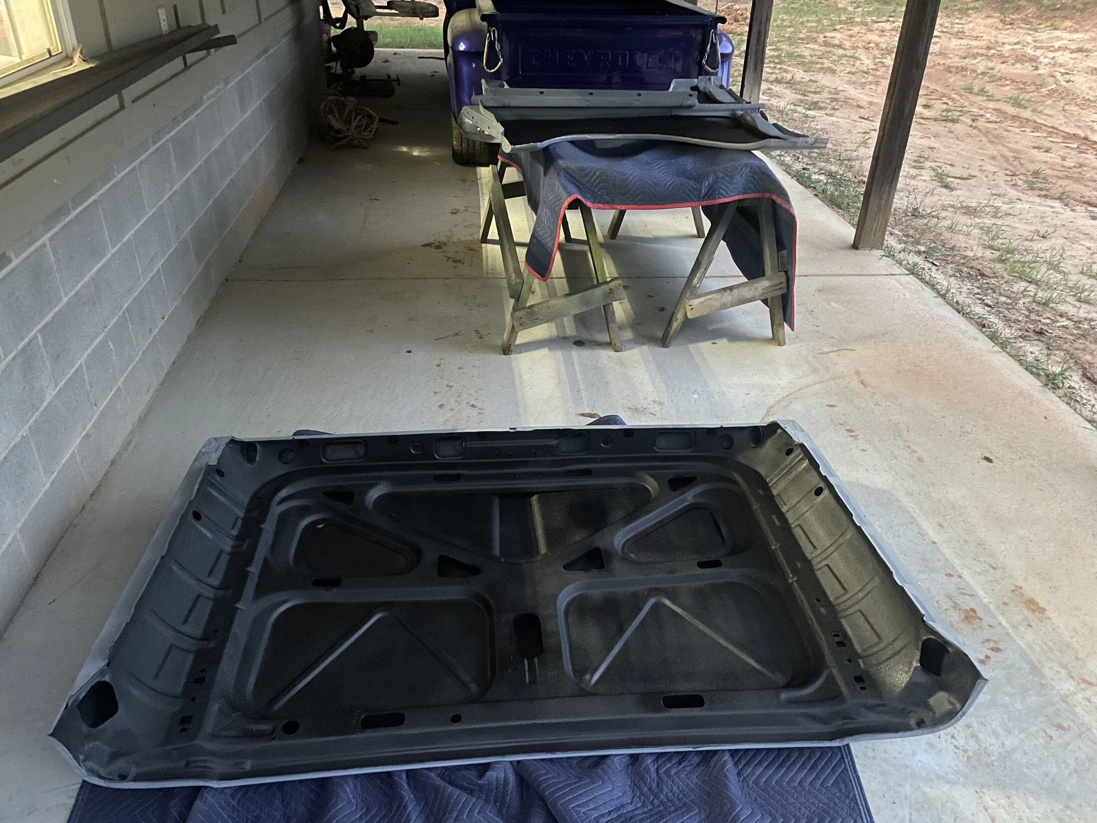

Also sprayed the underside of the cab/fenders/hood with raptor liner. Wanted to tint it to match body color but the only tintable kit the paint supplier had was too old and had hardened in the box. I think black looks just fine and it's under the truck anyway. Hopefully this was worth the additional monies and actually reduces heat and/or vibration. Still planning on getting after it with other heat/noise insulation products in the future. For now my wallet needs to heal.

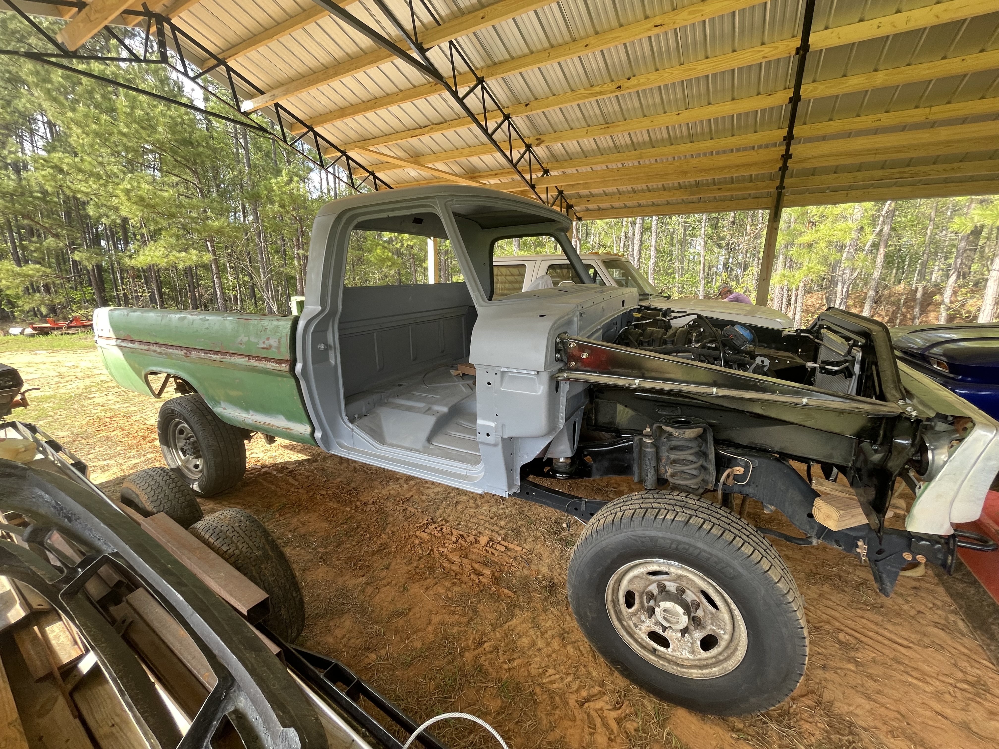

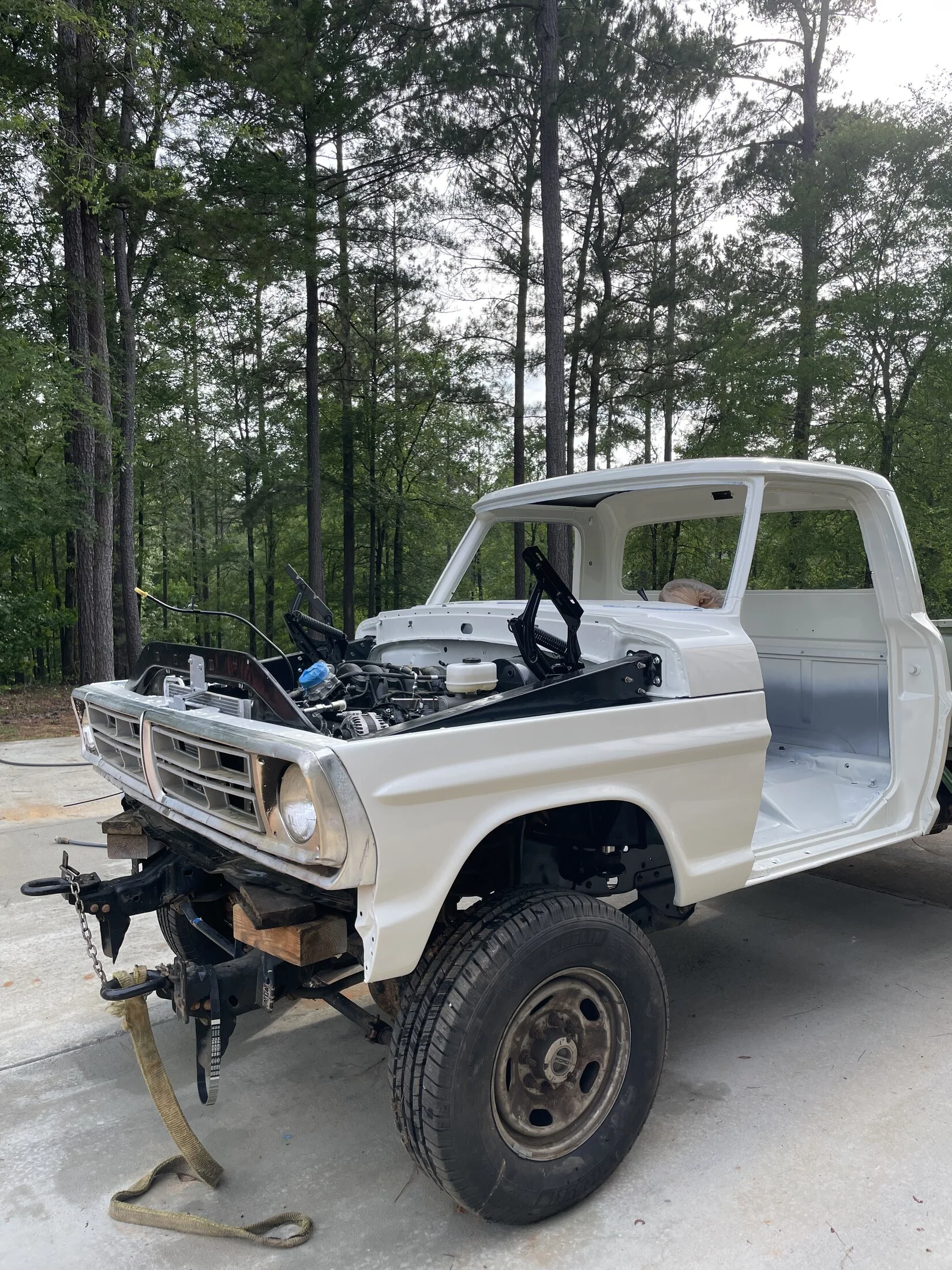

Got some doors and the hood on. Was able to get the body line pretty straight. Also polished and rebuilt my mirrors with new hardware since the last guy didn't use stainless hardware. Turned out nice!

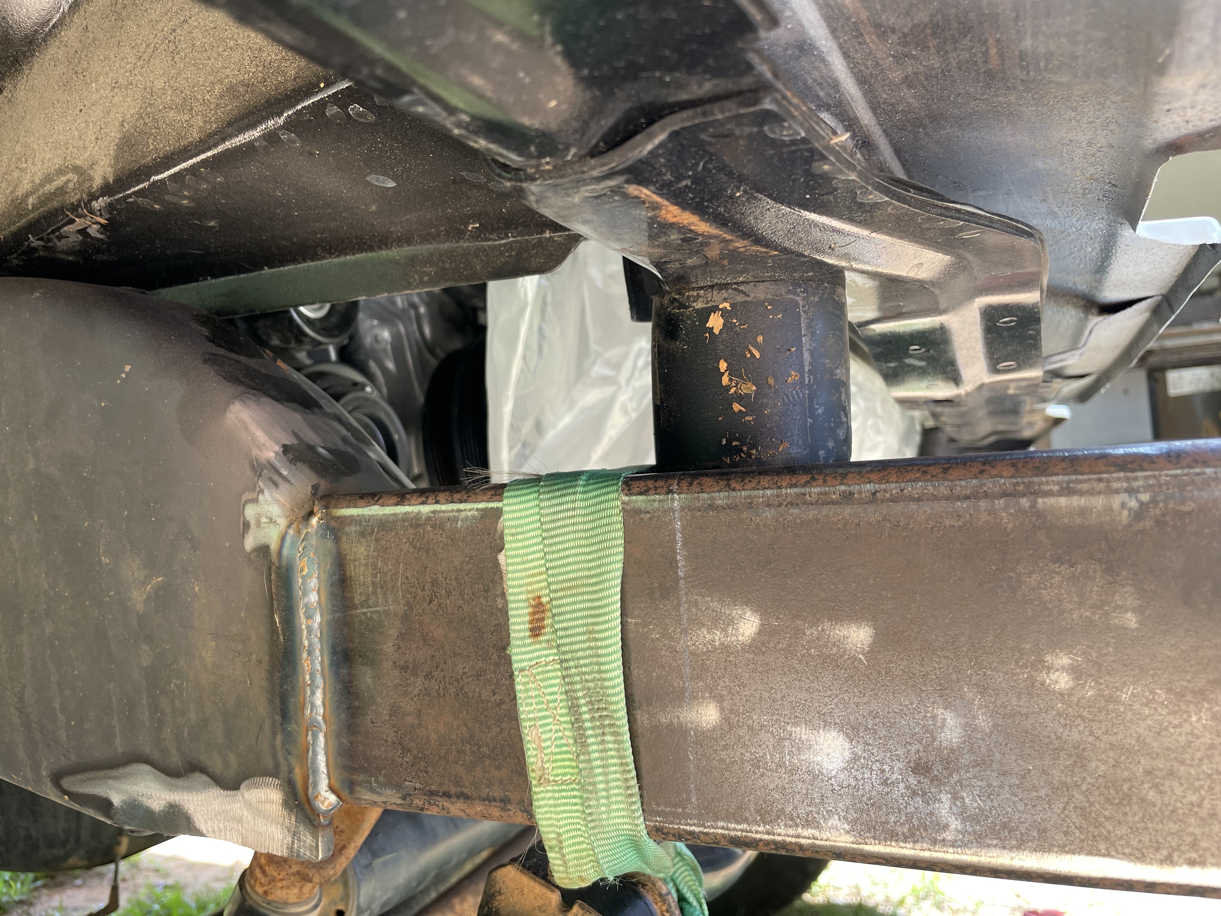

Didn't get too much done this weekend but got the front frame pieces started. Maybe not the most elegant solution but it'll all look better once I finish it up I think.
full
It's just a 12" long piece of 4x4" -3/16" wall box tube. Theres an access hole on the bottom side so you can get at the nut holding the mount bushing once the bumper is installed. I'm planning to plate the bottom with 1/4" plate and clean up the remaining portion of frame. Gotta come up with a new way to mount the sway bar too but it's just metal.

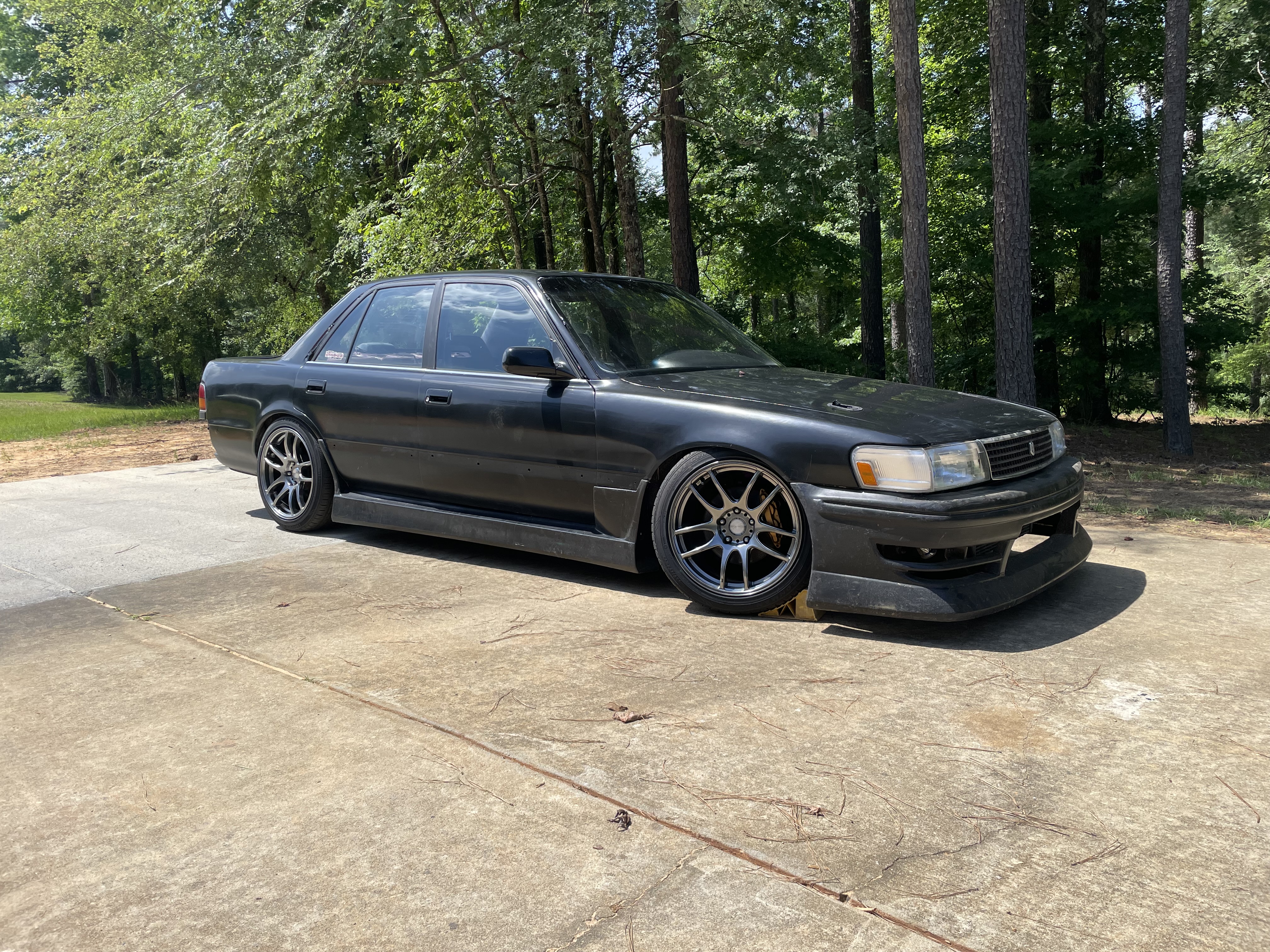

Here's a pic of it all sitting under it's own weight! Sway bar is just tied up out of the way for now. Spent most of my spare time this weekend dressing up the Cressida with a new body kit because it needed some love.

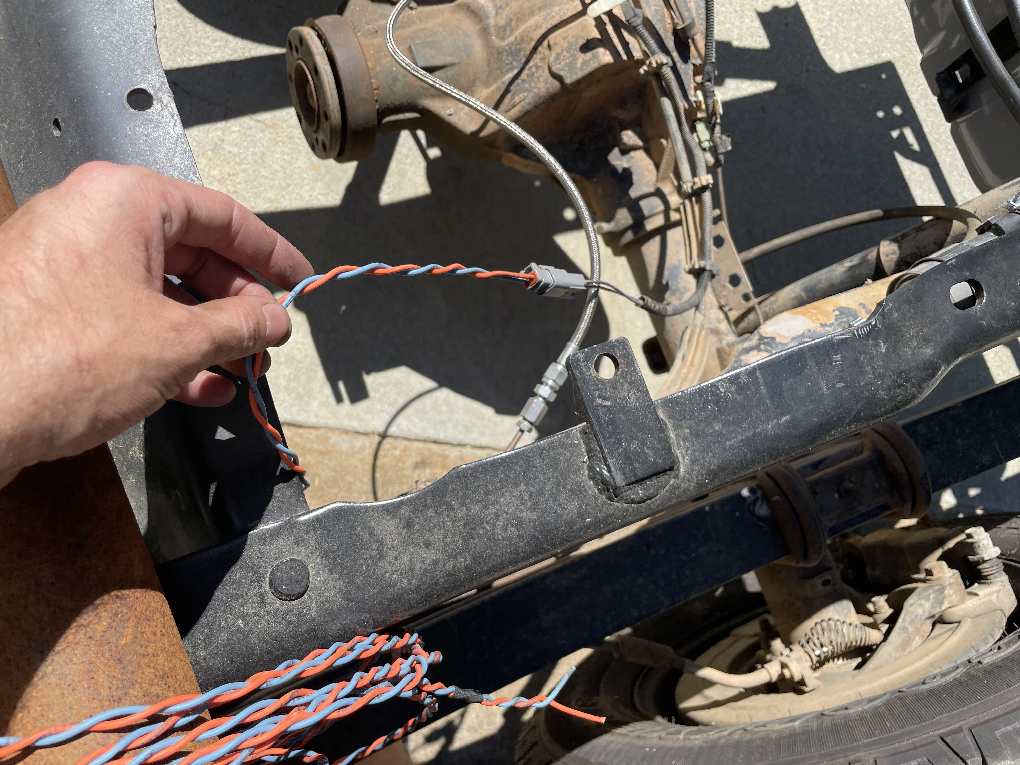

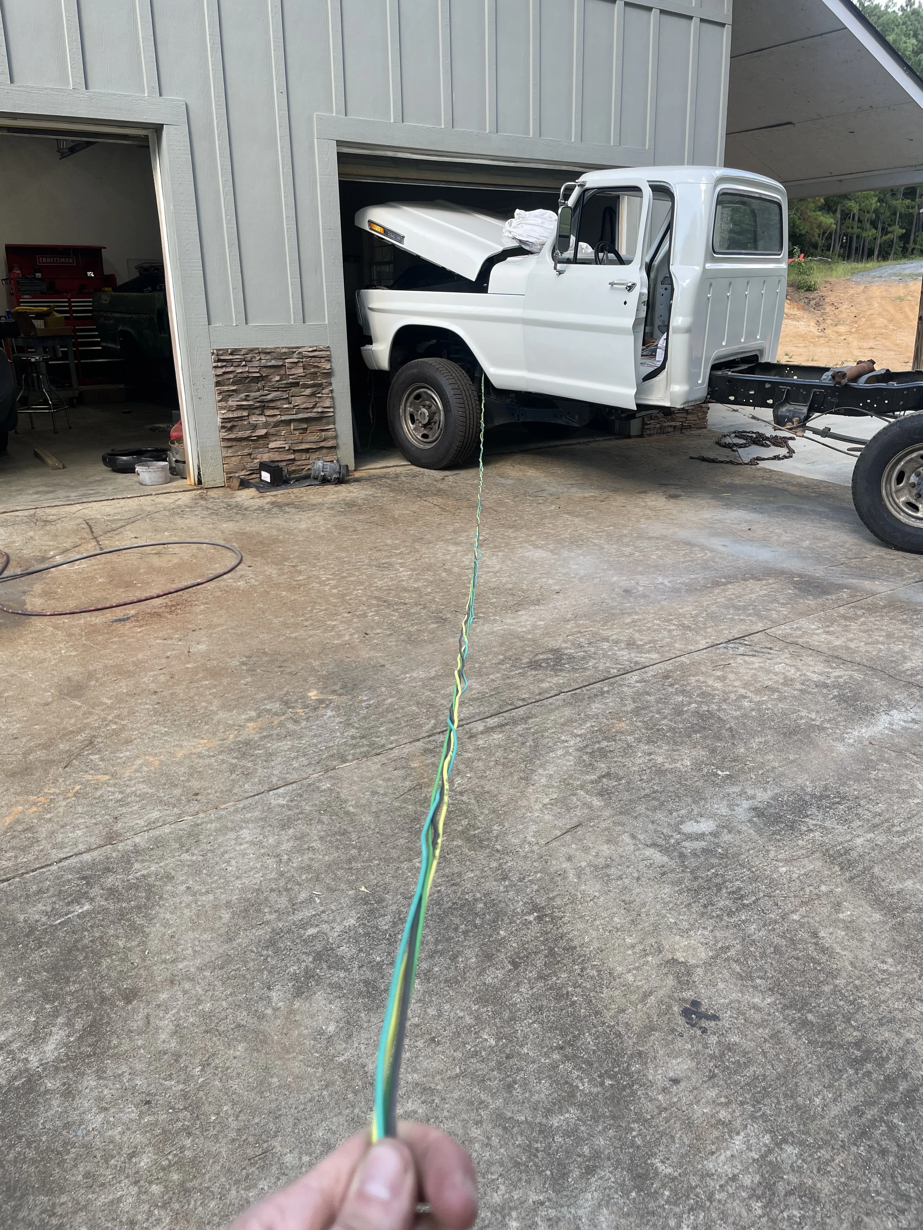

Wiring! Lots of it.
full
They give you enough for a loooooong bed. Also unfortunately the truck does not fit in the shop :(
full
Also wired up the locker. There are a handful of things I'm waiting on wiring up because I'll want the ecu to trigger i.e. fuel pump, radiator fan. Also waiting on a lot of wire loom so I only have to get under the truck once.

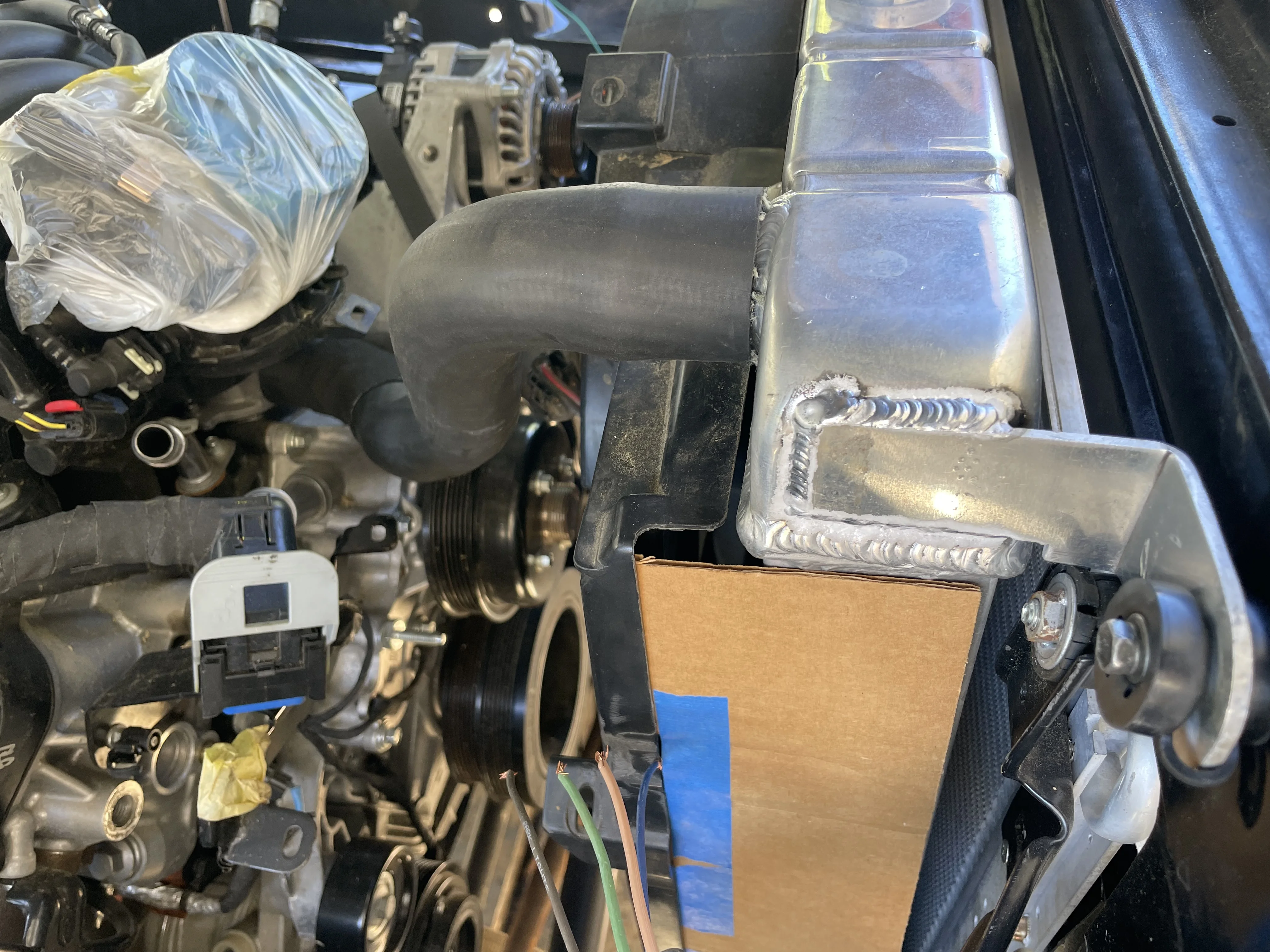

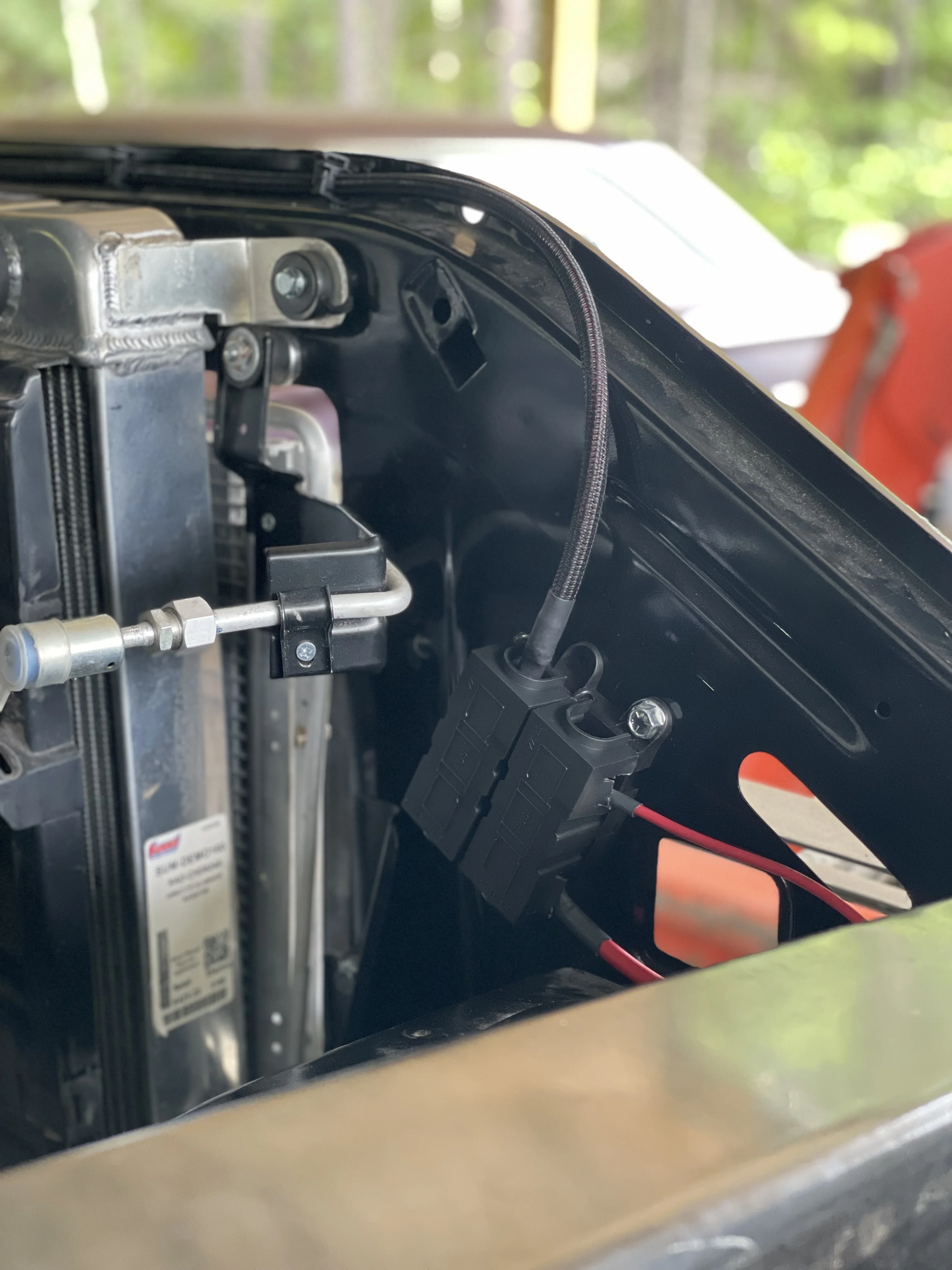

I also got the radiator halfway mounted - was hoping to come up with something a little more elaborate but kinda hard to ignore the simple solutions sometimes. Ignore the bolts holding it on. Awkward length for a M6 bolt and this is the best my bolt bin had to offer.

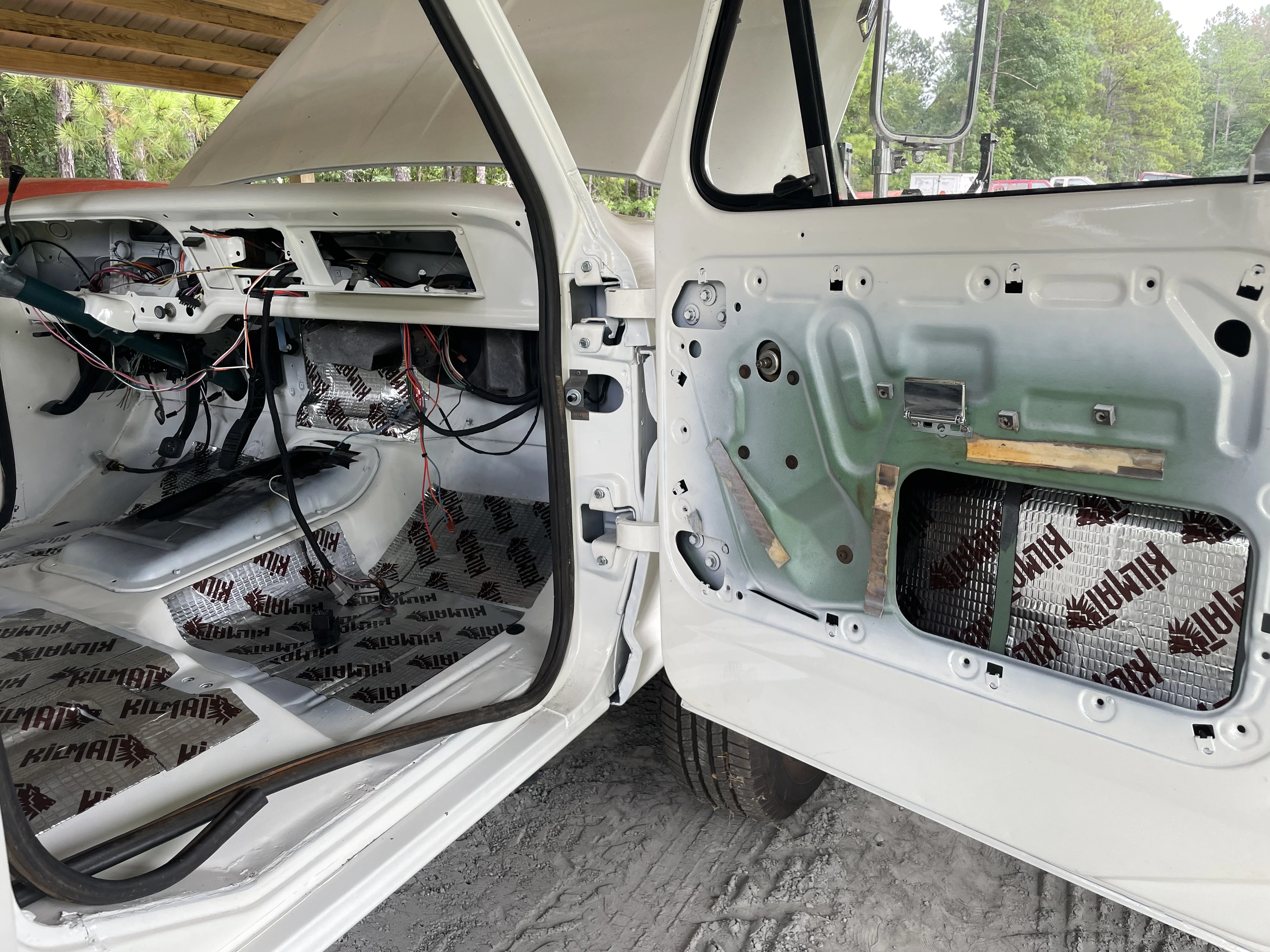

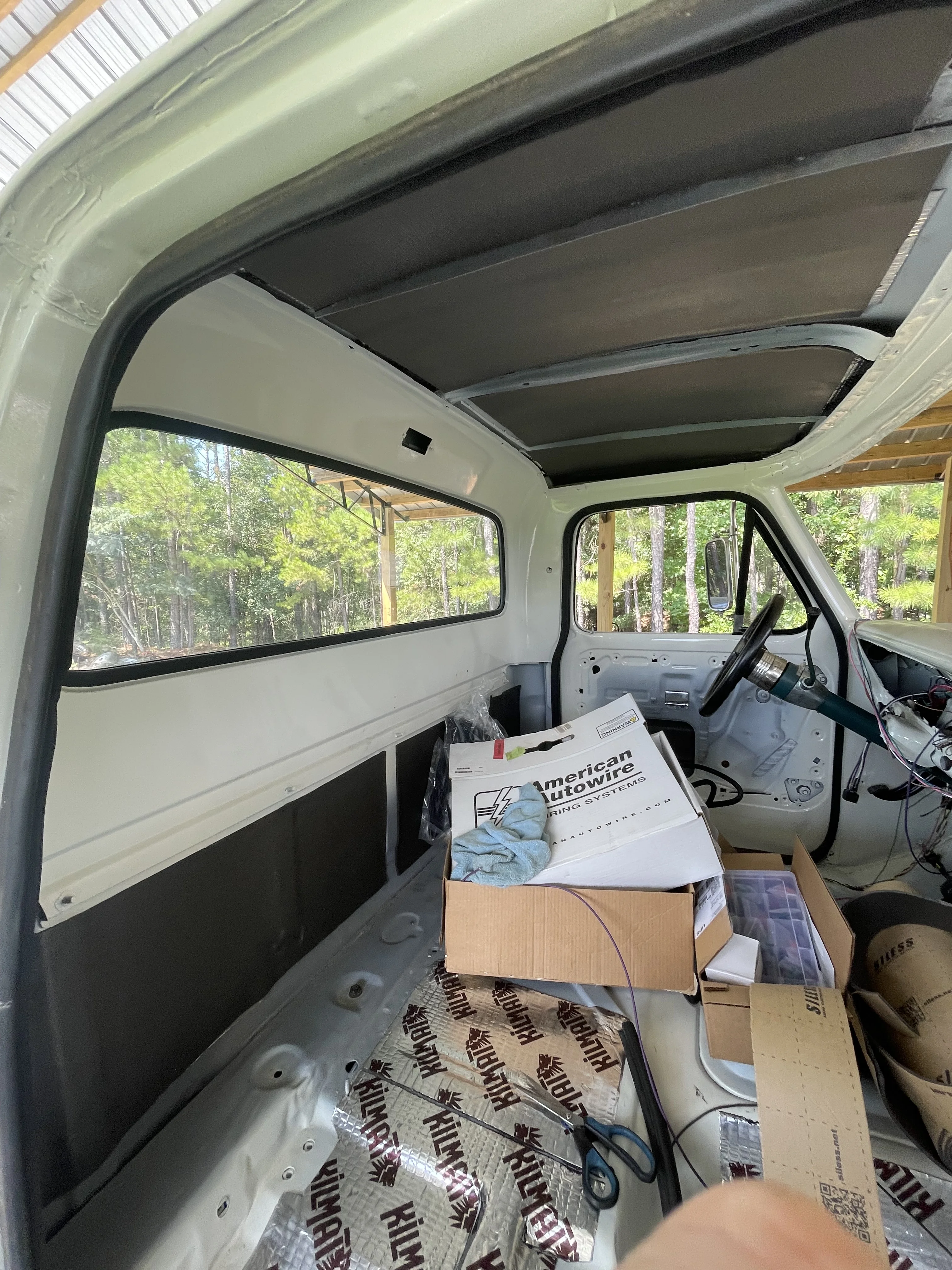

Some reflective butyl insulation in this weekend. Will be taking additional measures to make sure this is a comfortable riding truck.
full
full
Also knocked out some more wiring which you wouldn't be able to tell from photos. Finished the start relay which is triggered by the neutral safety circuit from the transmission controller. Lots of backtracking through this harness. The instructions don't include a real wiring diagram but rather just tells you which color goes where (in efforts to be dummy proof perhaps) so there's a lot of tracking down open circuits. Need to get the ECU/engine harness so I can fully plan the integration between TCU, ECU, and body harness before looming up wires.

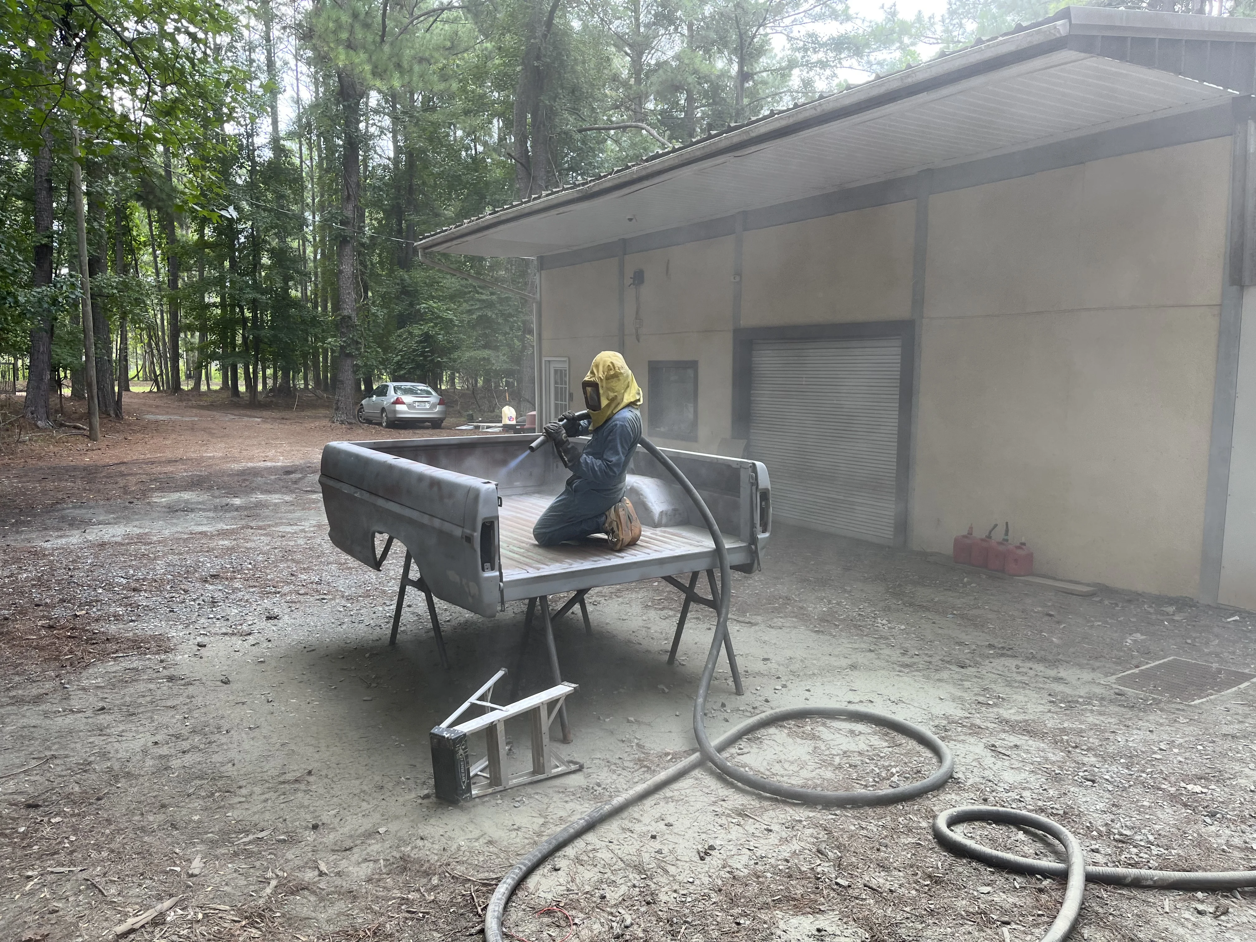

Got the bed media blasted this weekend. A family friend has a sure enough blasting setup. It's like fighting a giant snake but made extremely quick work of the bed. Think I got it all done in an hour and a half.

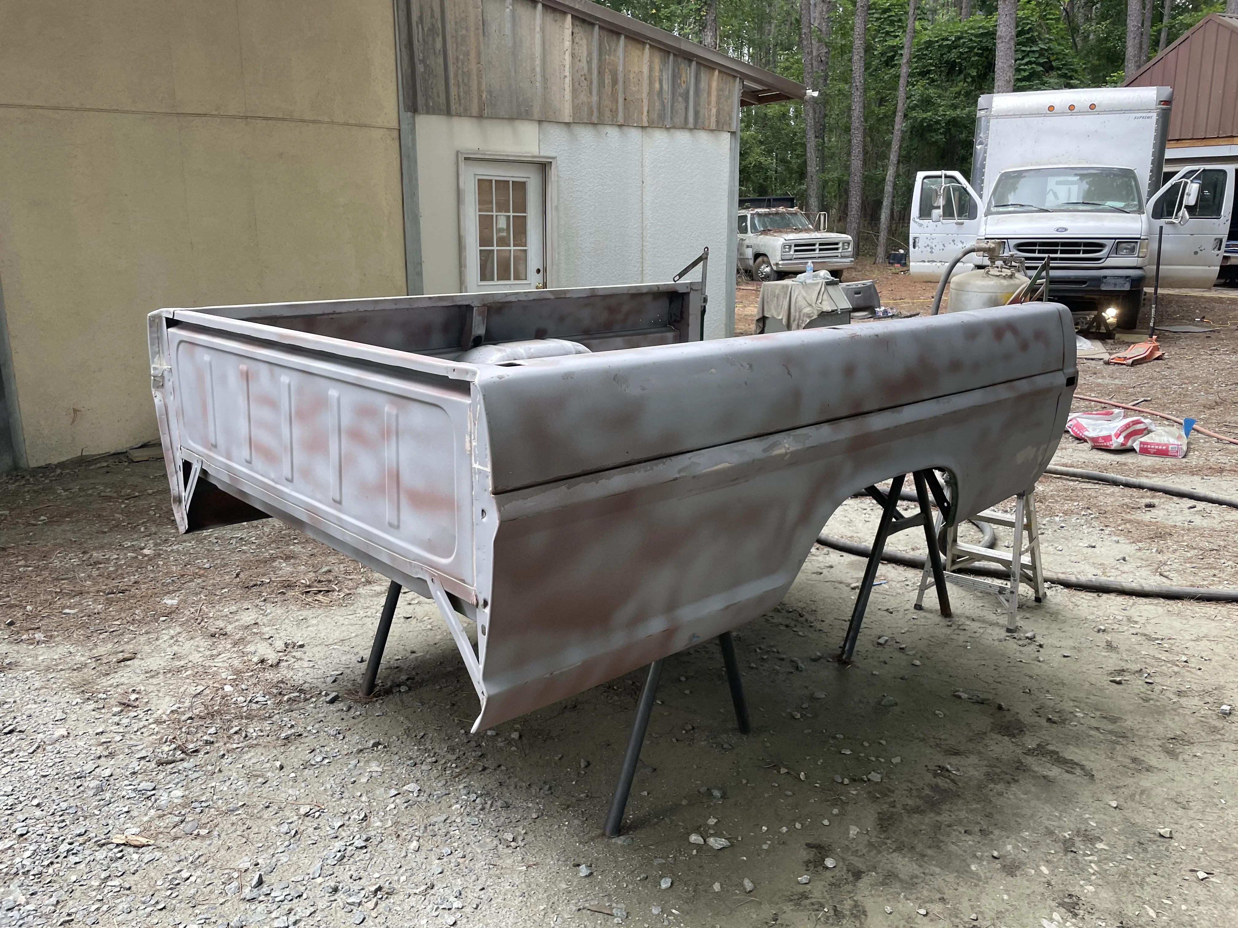

Then trailered it home and quickly got it into some epoxy primer so I don't have to deal with any flash rust.

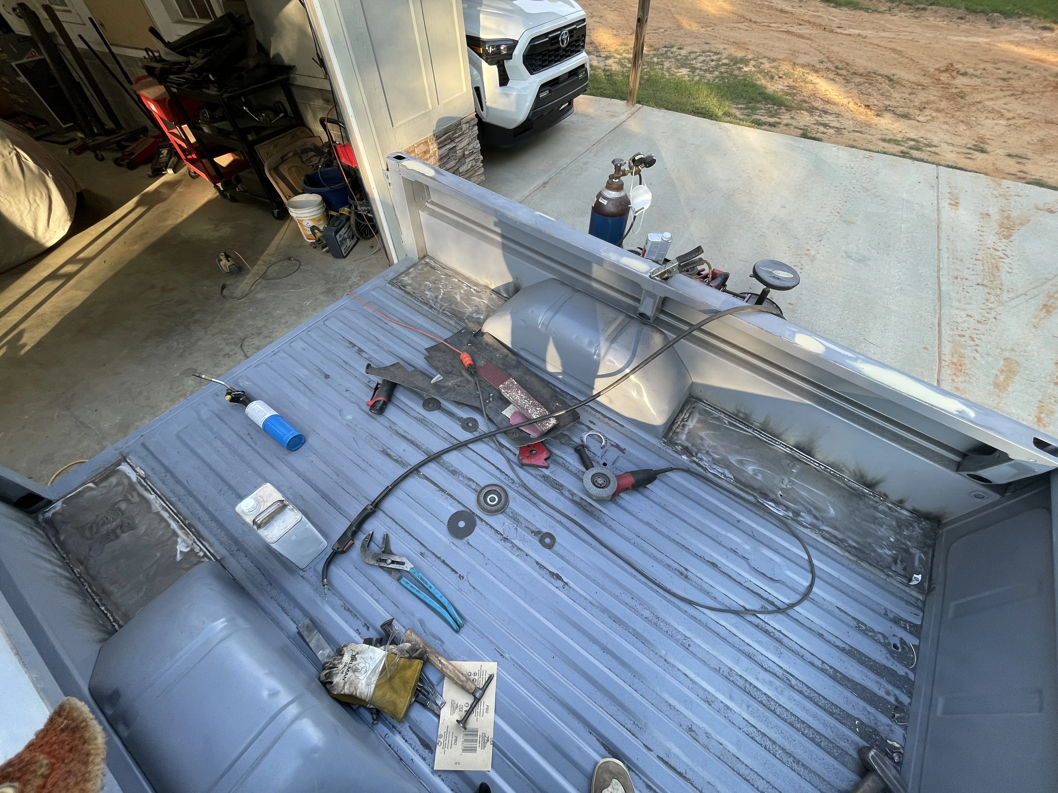

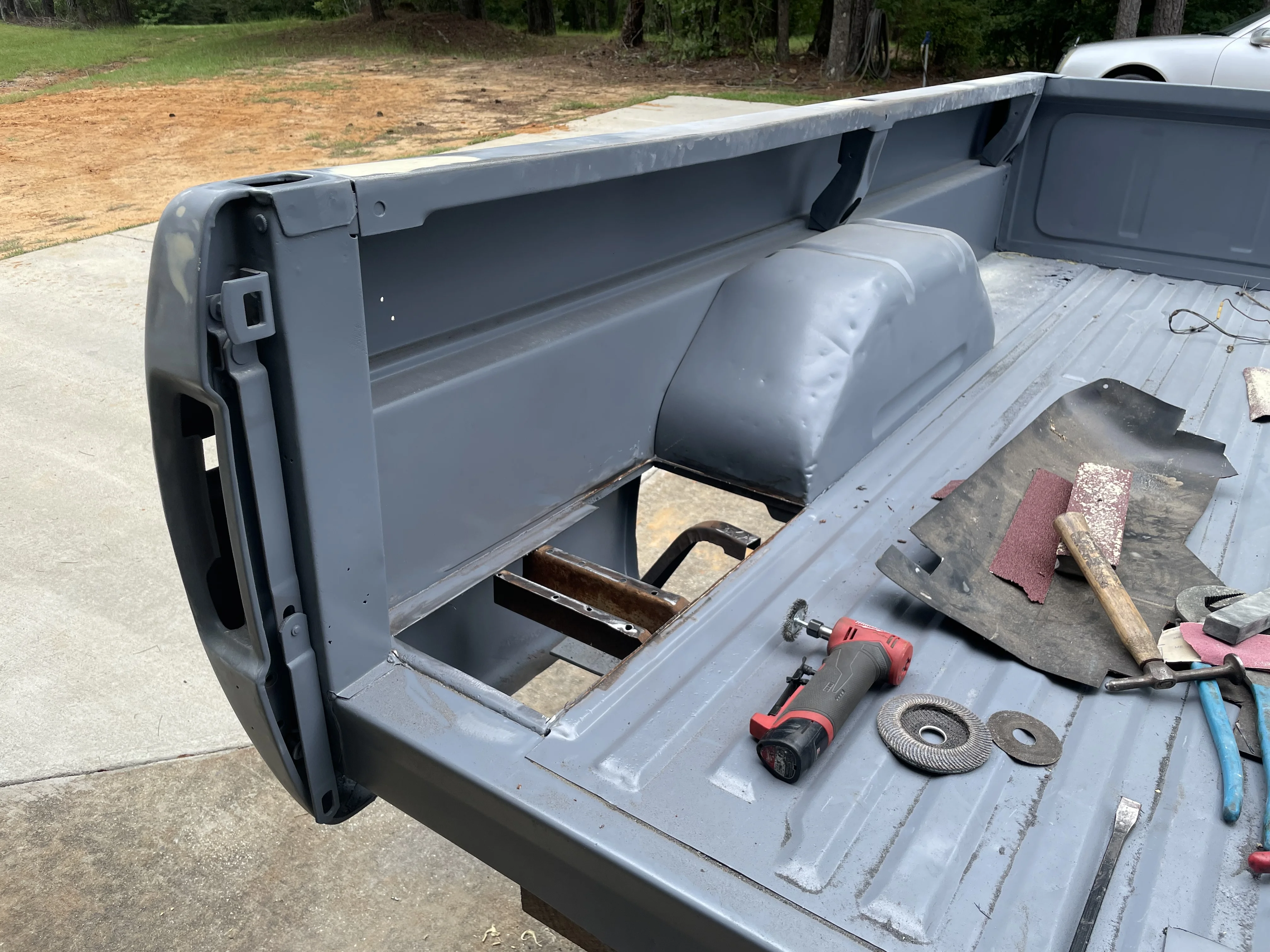

Big weekend for the truck bed. Cut out all four corners as each had some severe pitting or was fully swiss-cheesed. It went OK. Drilling out spot welds from underneath was exhausting and the whole process was not nearly as easy as I'd anticipated (as is often the case). Enjoy some pics of rust patching as well as some filler work that looks more extensive than it actually is:
full
full
All of the seams need fresh seam sealer as the Ford stuff has long since cracked off. Stuck a wire wheel down in each corner and got what little remained out though. Here's the filler work it ended up needing - things are never as straight as the look once you hit it with a sanding block:

Full bed is now in epoxy primer. Will be spraying with a filler primer and then another coat of thinned epoxy primer as a sealer before base coating.

Not perfect but it's a truck bed and in my mind it's just not an effective use of time to hammer and dolly or use body filler on the wheel tubs. The last thing I want is for the truck to not be usable as a truck.

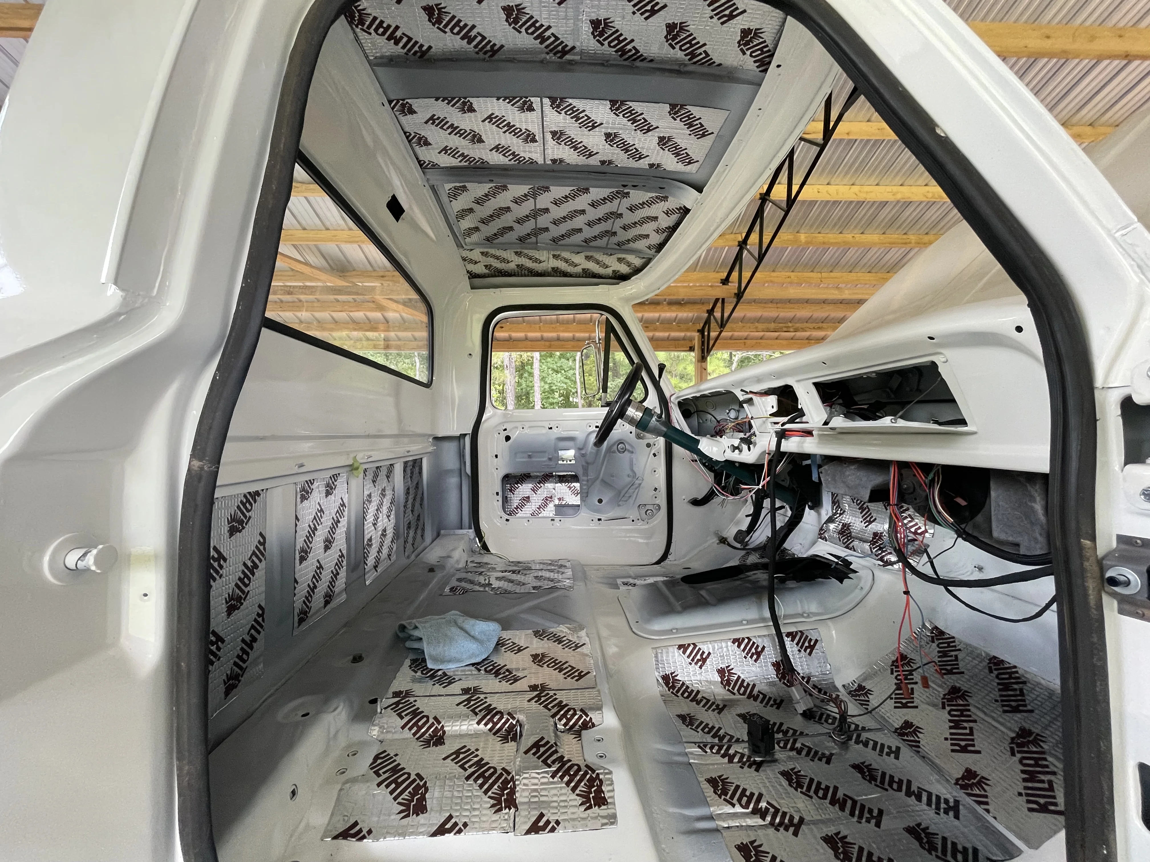

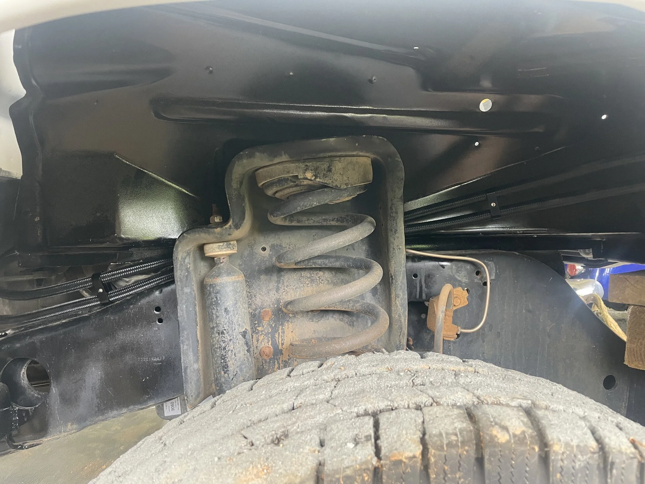

Side project for the weekend was adding some closed cell foam with adhesive backing to the cab/inside of doors. This is just stuck to the reflective butyl insulation installed a few weeks ago. Cab is very quiet now and doesn't have that tinny sound when you tap on it anymore. Doors close like a Mercedes! My focus has been shifted to getting the bed into paint while the weather is still cooperative and warm enough to spray. We'll finish up the wiring after paint is taken care of and then finally get to see it run.

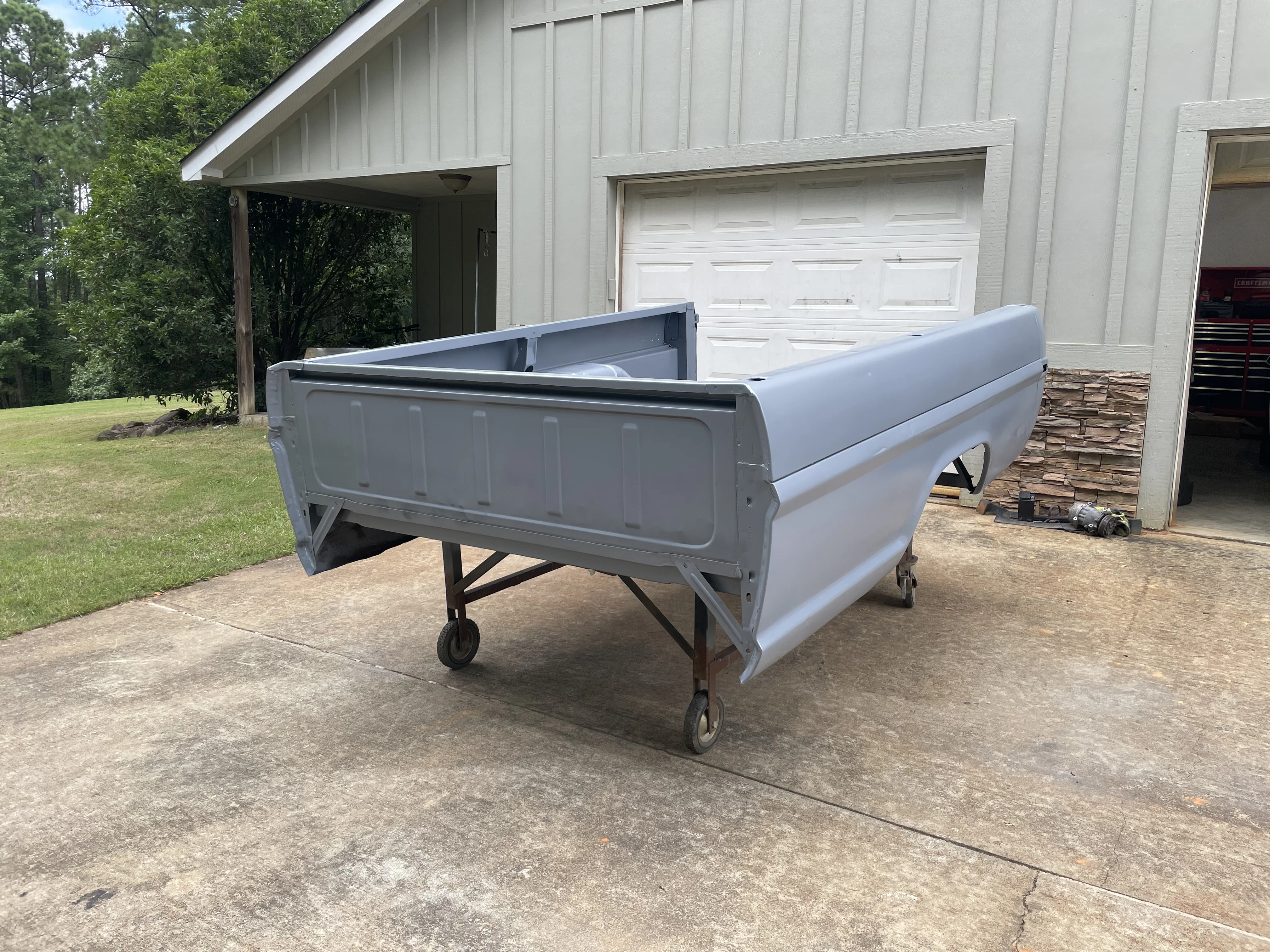

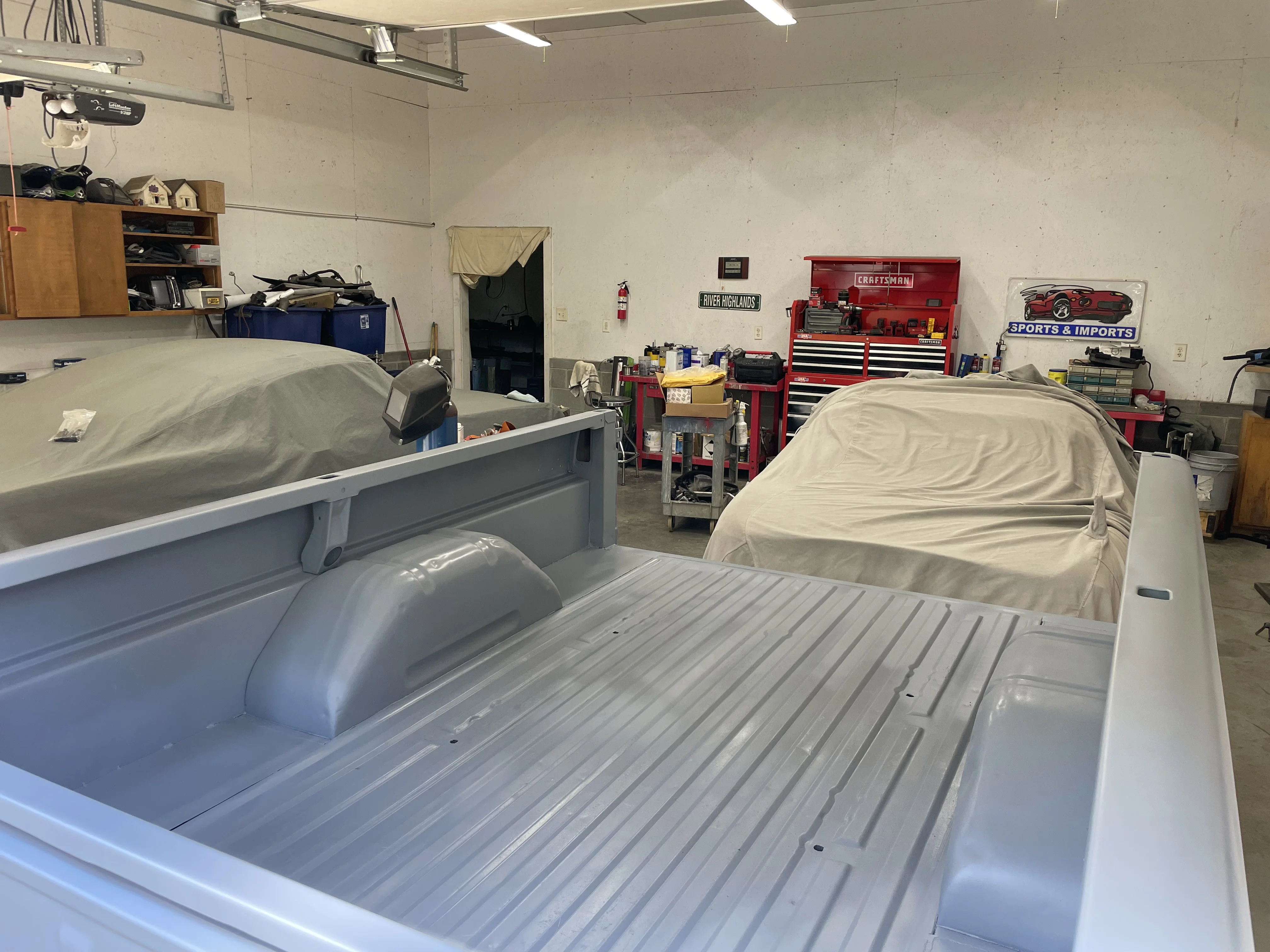

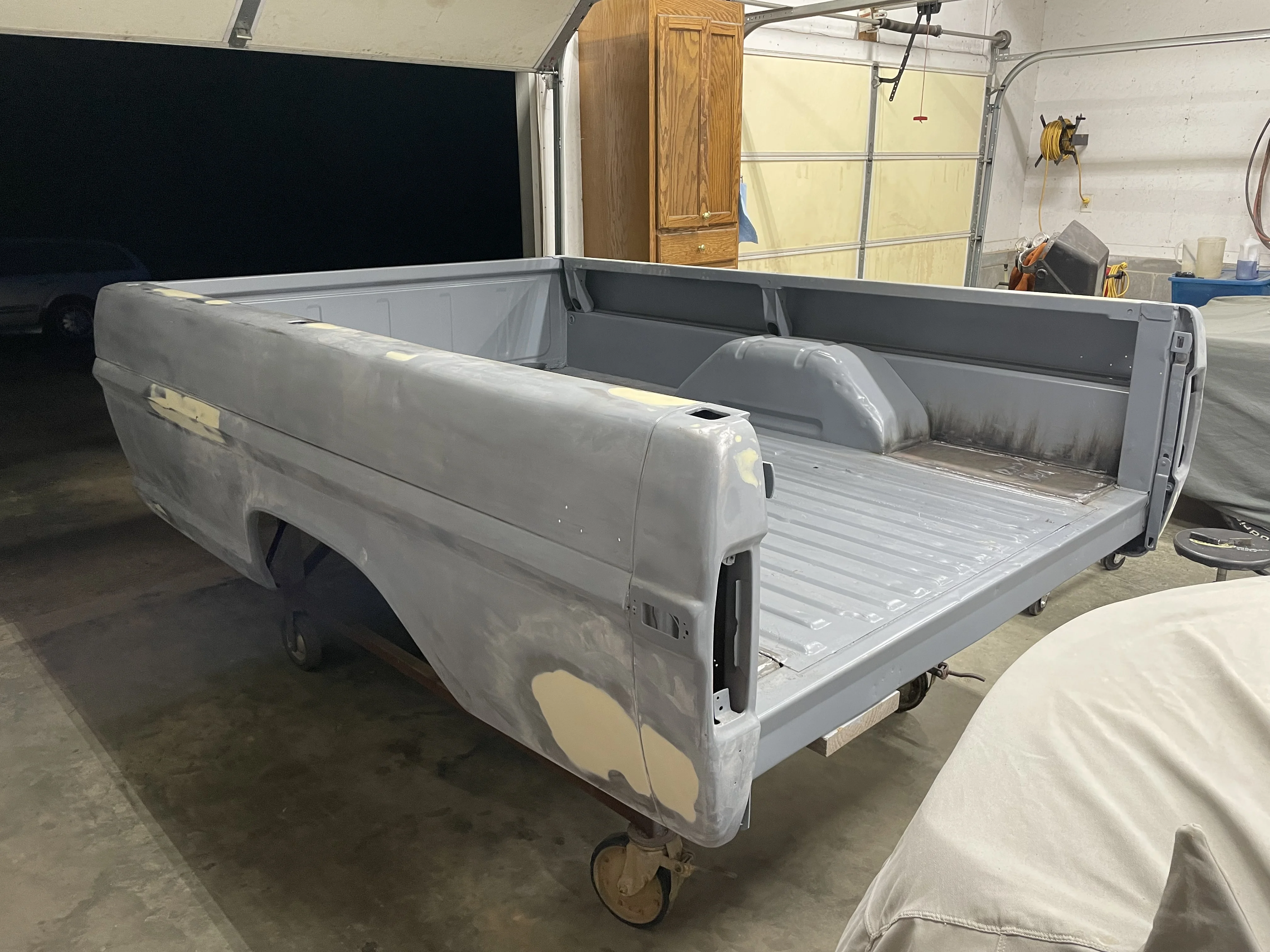

Finished up the bed for the most part this weekend. Sprayed the underside with raptor liner and also decided last minute that I should seam seal the gaps in the panels. No idea if Ford did this from factory but it would have looked terrible if I didn't.
full
full
I also decided to spray some polyester sanding primer and it made a giant mess. ended up blocking the bed for the better part of Saturday but it came out nice!
full
full
tailgate definitely isn't perfect but it's a lot better than it was and also not totally full of filler. I feel like tailgates/beds (if they're going to be used) need as little filler as you can manage. Driver side came out almost as good, but a moth drifted into the paint on the last coat of clear.
