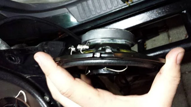

Okie dokie, just did this. Used the pioneer ts-g1644r from amazon, $50+ for all 4. I only got to the fronts tonight though.
I'm not the brightest kid, so I figure that I should share my epiphanies while doing this install. Apologies for any repeated info, I will try to stick to what I hadn't learned in these threads prior to the install. (Everyone probably already knows this stuff, so I'm feeling a bit sheepish, but here goes, just in case there is a shmuck like me who can use it to make his life easier).

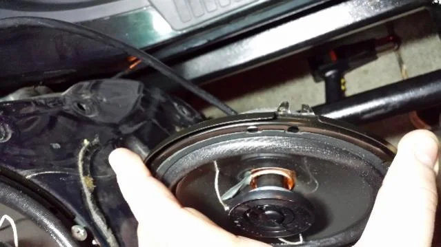

1.) These are NOT 6.5" speakers (contrary to what the box says). They are 5.25" speakers with little extra tabs that would allow you to mount them in 6.5" speaker location. Fortunately for us, we need 5.25" speakers, not 6.5".
2.) I bent the little metal tabs forward (away from door) so they would not hinder a flush mounting of the speaker against the door. This led to the speaker magnet solidly contacting the window channel, preventing a flush mount. So I stand there in my driveway texting and calling my wife, while she is on errands, to pick up some 1/4" spacers from worst buy. They don't have any. Try the stereo install place down the road. They don't have any. I call worst buy, because I have now measured and discovered fact #1 above. They can't find any in the computer so the wife heads back there and calls me and puts a salesman on because she is unsure. "Sir, we have 1" spacers, not 1/2", sorry for the inconvenience." I ask if they are 5.25" or 6.5"? He says 6.5". Blasted! I tell the wife to come home because while on the phone I epiphanize the following:
3.) If you bend the small tab to the rear, towards the door, it will create a built in 1/4" spacer for you. ish. Here I begin to correct my handywork
Voilà
4.) Mounted up driver side. Works brilliantly. Gnat's hair clearance!
(Not sure why pics turn sideways on my s4)
5.) Another thought: while on the phone earlier with the stereo shop discussing the needed spacer, he asks if there is enough clearance within the factory grill/door panel to clear and not interfere/hinder the throw of the speaker. I hadn't really thought about it and spewed out mud gospel "of course there is enough room, I read it on a forum!!" Pshhh. Who's he think he is? Well. I button up my driver door handy work and shine a light around and think it is good to go! However, while doing the passenger side I decide to geek out a little bit and cut away the cardboard door panel about a 1/16" to 1/8" to yield a 1/8" to 1/4" larger diameter hole. Hope it helped cuz it was a pita!
6.) Spoke with a buddy as I was cleaning up and mentioned to him i thought the ps was probably touching the window run. he mentioned I could have disconnected the bottom of the window run and added a washer or two to space the window run the direction I needed it in order to clear the speaker. (I'll do that if/when I get back inside the door, probably sooner rather than later, to add sound deadener.)
Overall, sounds amazing! And that's just with the two fronts!!

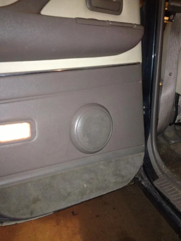

I went with after market grills on the front doors and stock grills on the rear doors. The front speakers are Pionier TS-G1644R and the rears are Alpines SPS-410. The fronts needed spacers and 4 drilled holes so not a whole lot of mods. I like the look of the after market grills.
On the rears I untilized stock speaker plastic mount so that the grill can be mounted in the stock configuration. Needed alot of modifications to the mount such as cutting and grinding so that the 4'' speaker wound fit right. I had to also grind off the 4 mounting tabs on the speaker to get it to sit. A bit of 5 minuet epoxy around the edge and it way read to go into the door. It was a bit more work than I would like to have done but its a love affair i guess...

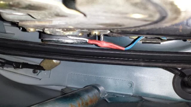

Here's a dumb question: when replacing speakers from the OEM versions, I have to cut the OEM wire and solder on new connectors to the old wires for the new speakers right? Since I don't have a soldering iron and haven't ever done it, I'm just asking (and maybe looking for a decent alternative, but if there isn't I will learn to solder.)
you can crimp - which holds up better to vibrations
but you don't need to cut the stock wiring - the speakers are attached with a two wire plug - just find crimp spade tails at the auto store and crimp those onto the wire ends from your speakers
alternatively, Crutchfield sells adapter harnesses to the stock Toyota wiring - plug in, be done
Voilà

I just desoldered the connectors from the OEM speakers and resoldered them onto hype Pioneers. The OEM speakers are marked +/- so it's pretty easy.
Thx DSRTRDR. I'll take a closer look. I was in the rear door speakers and only saw the wires going right into the speaker. I should've know there was a toyota connector in the door. I'll dig in more.
I love the idea of the crutchfield adaptors; very clean. I'll look into that.
it's a bit more difficult to find the plug on the rear door speakers than the front - I first thought they were soldered on, too, but there's a plug right on the speaker - you have to loosen the speaker out of the door to find it
Found the plug; Crutchfield adaptors ordered. Will learn to solder on something else!

Rears
Pried off the rear speaker grills, Removed the speakers and cut out the mounts (Dremel with drywall bit, jig saw with fine blade would likely also work) to fit the new Pioneers, Caulked them to the mounts and put them back in. Cut wires and crimped on new terminals to fit new speakers. Took about 45 mins from start to finish.
