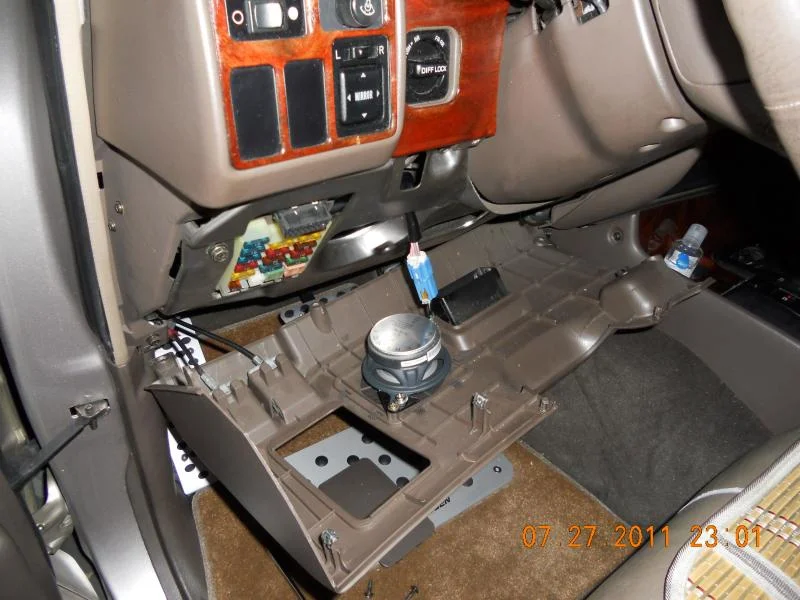

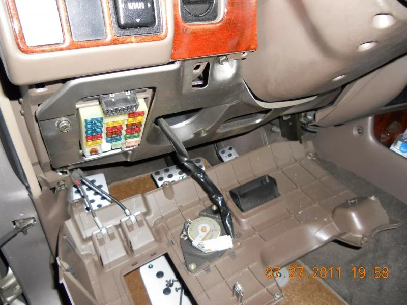

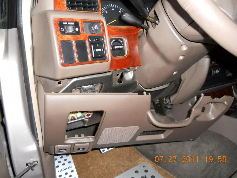

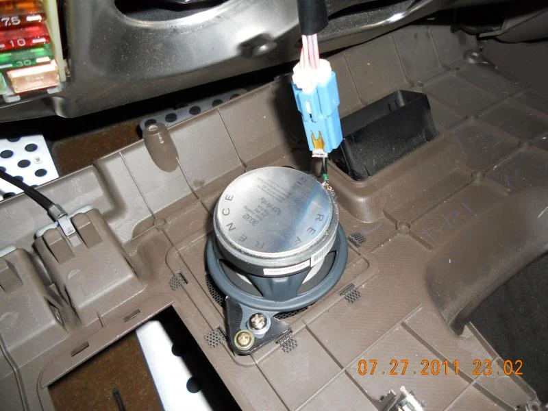

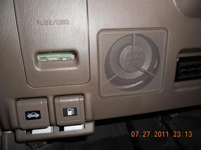

I finished installing the 2 dash speakers last nite.

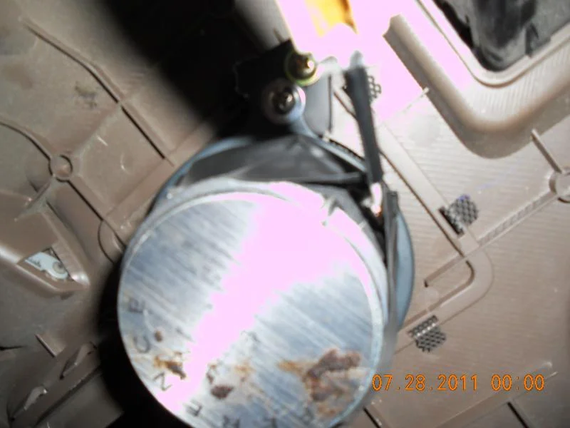

First, at driver side, remove the 4 screws below the dash & pull out the panel. You will see that my dash speaker is one piece unlike others that have separate mounting plates.

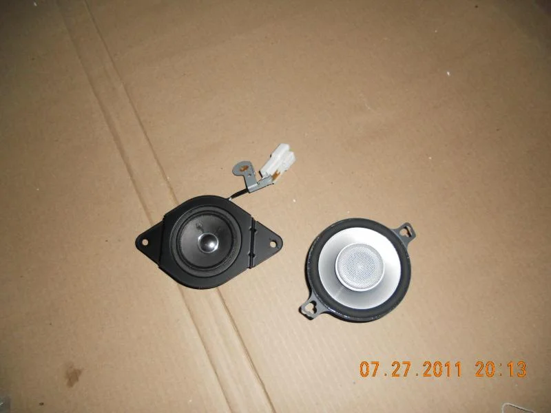

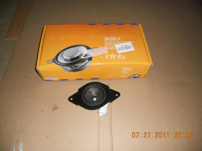

Here is the OEM Pioneer & the NEW Infinity 3.5"

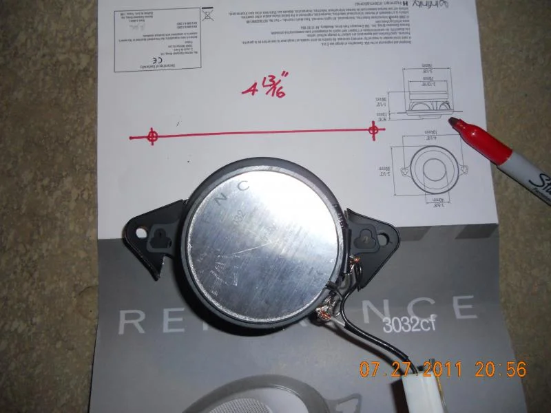

Dash Speakers
The dimension between the mounting holes in the dash is 4-13/16" so I have to cut off the ears of the OEM's speakers & bolted them to the new Infinity's mounting holes to extend the connection.
The next picture showed how it fitted well.:cheers:

One VERY IMportant thing to do is to tape the new speaker's terminal very well to isolate them from touching the steel hole of the dash. IF you don't , it will ground the speakers & sound funny.
I cut off the wires form the OEM's connector & soldered them to the new Infinity's...again Black to black(+ve)!
Voila, It works!

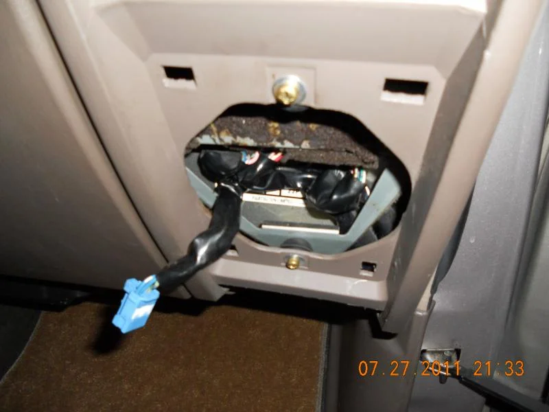

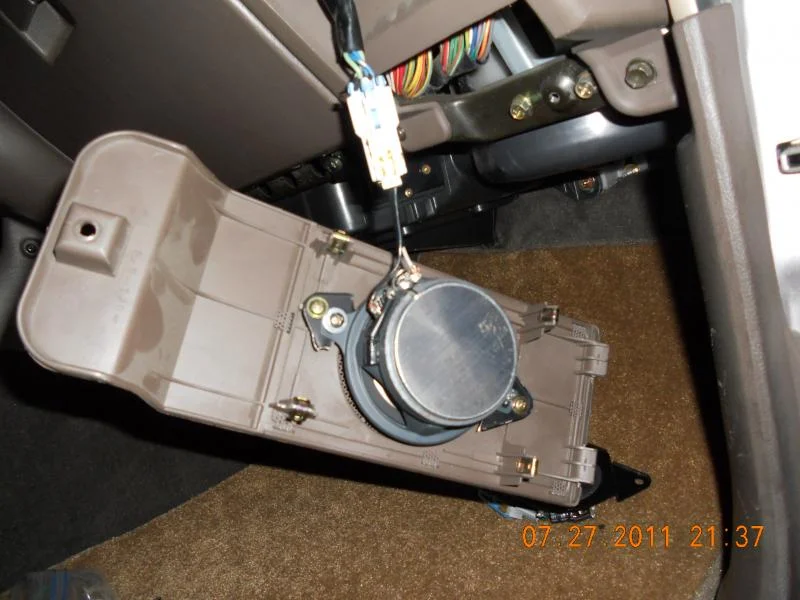

Now the passenger side!
The key is to put a 3/8" to 1/2" spacer (faucet washer will work) and push the OEM amplifier further inward to make room for the new speaker.
Then do the same as the driver side, cut off the ears of the OEM's mounting plate and bolted them to the infinity speakers.
Everything looks great!:popcorn:
P.S. Again, don't forget to connect the supplied inline capacitor in series to the +ve black wire to filter out the mid bass so they can all go to the subwoofer.

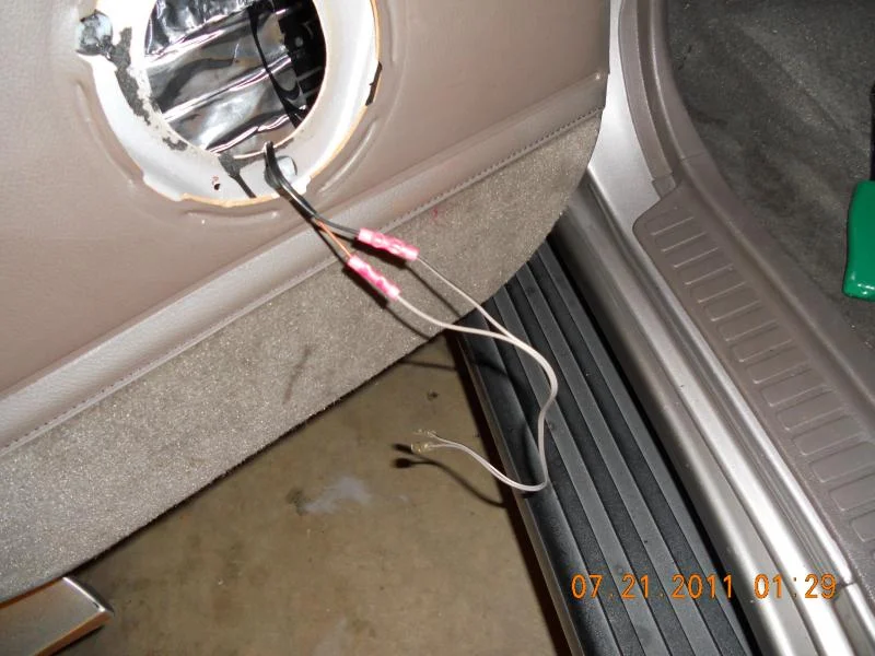

All you need is to cut the wires of the OEM speakers and splice them to the wires of the new speakers with mechanical coupler that you can get from any hardware store or home depot, see the red coupler in the picture below. Some may prefer soldering.

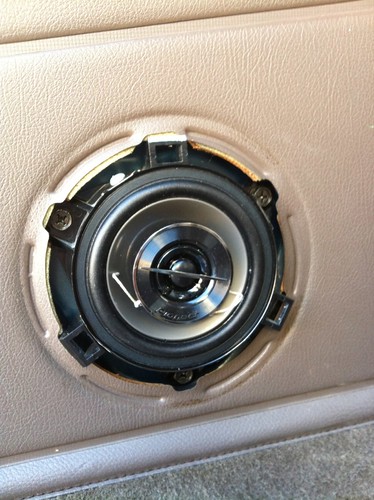

I pulled the wires on the little dash speakers. No biggie. I had an issue with the wiring getting caught on the window motor and disconnecting...FYI... The front speakers fit real good using the oem covers. The speakers fit in the holes good and you will find screws pretty easy to install them. Just don't poke a hole in the speaker like I did my first set...

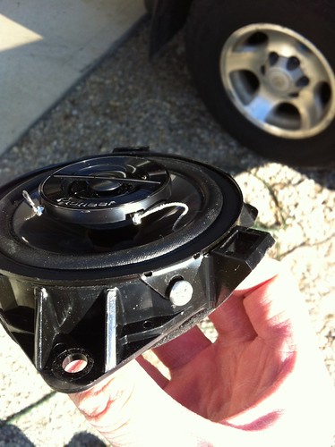

I hadn't even see the latest part of the thread and came up with the bent-tabs and screws (vs JB Weld) for the back speaker pods...
Mounted:

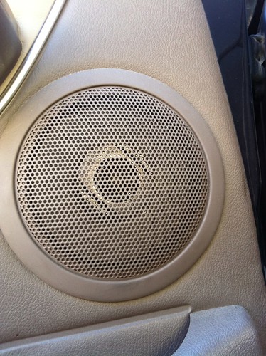

Front speaker at home:
