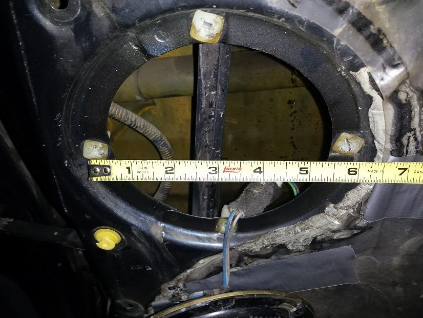

I found a pair of the pioneer speakers the OP made this thread on. Their mounting requires 42mm space.

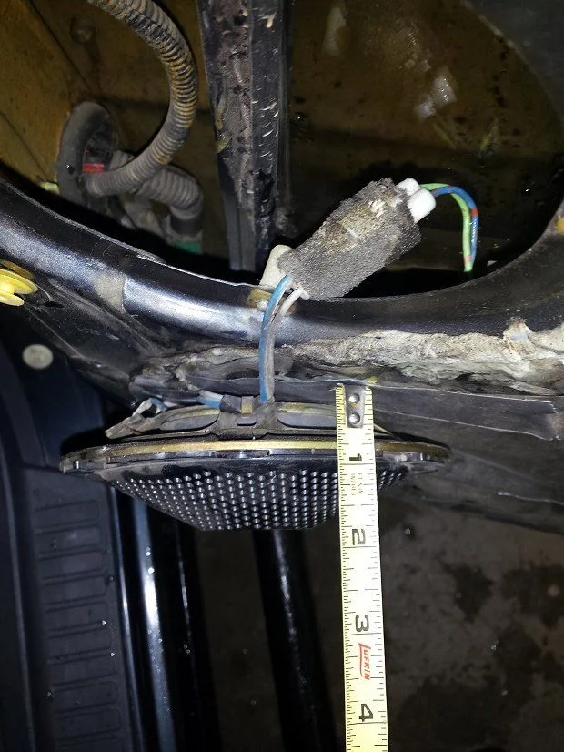

I took my door panels off my 93 hdj81 limited, and measured. Only 38mm (1.5 inch) of space behind the door metal before it would hit the window channel.
Since the oem speakers are inversed, the aftermarket pioneers would actually be shallower in the FRONT, so I am thinking I could use 5mm spacer on them to fit them behind the stock grills.
For those of you with the very limited space in the door do to window channel, is this what you did? By spacing out the pioneers around 5mm do you think the cone will have clearance issues with the factory grills?
Only other option I can think is to put in 4 inch speakers into the front doors instead, which would be smaller.

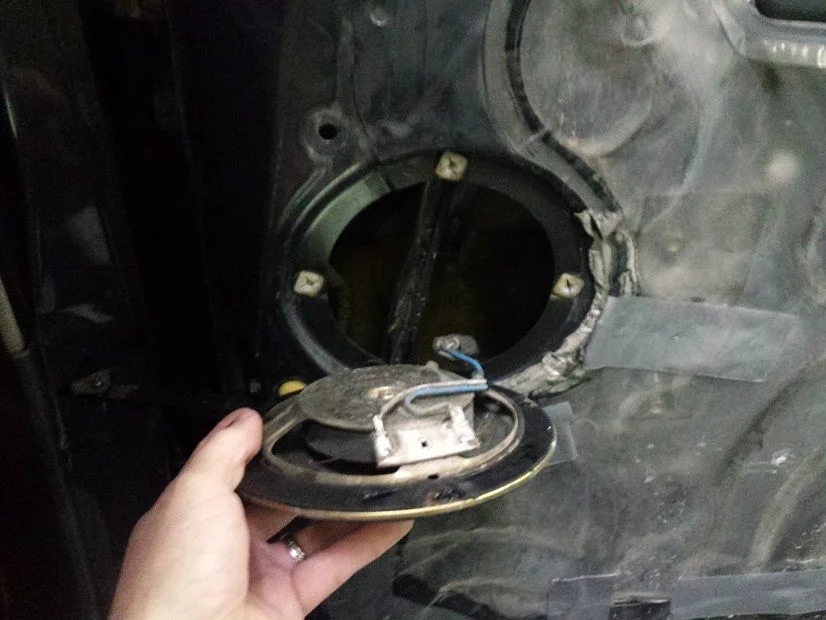

Pics attached.
I basically ended up using foam weather stripping between the door & speaker frame to give it enough clearance off that vertical metal bar. Then I trimmed back parts of the fiberboard to fit the posts in the factory grill, & then glued & siliconed them in place.
