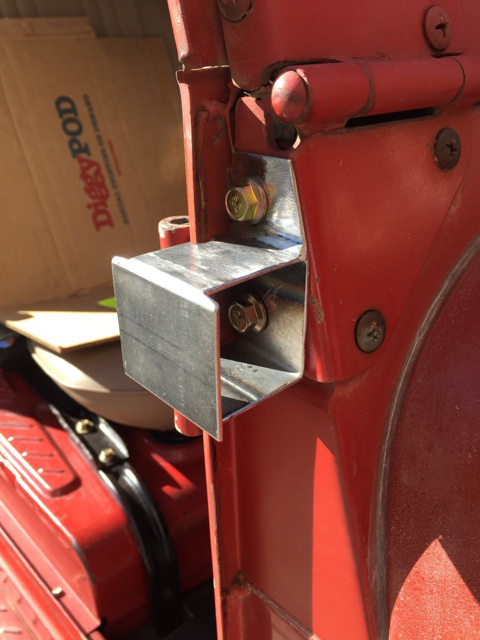

Good memory @Solace in Solitude! Here is mine - very simple actually, the second bolt I’m guessing is probably overkill (but a good backup) and requires welding. If you used thicker gauge 2”x2” steel tube you could probably do one bolt. Would be good to have a cable for backup though. The inner nut needs to be welded nonetheless. Locking bolt is readily available online. I just notched each side of the 2x2 to make the wider section.
