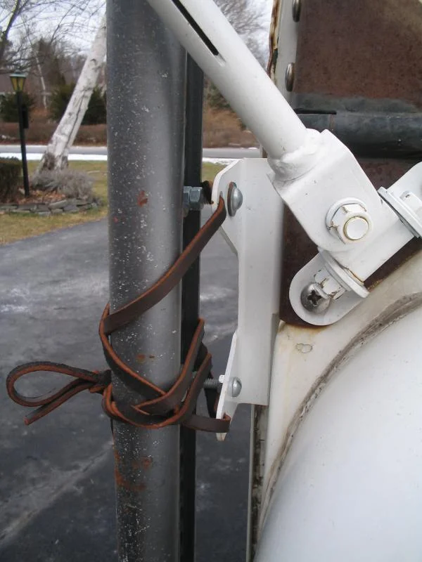

Use a bracket off the windshield hinge

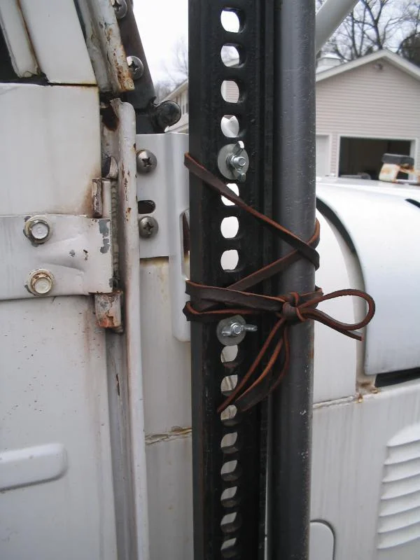

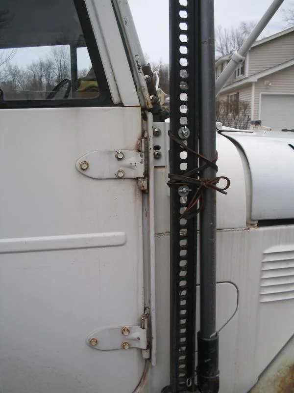

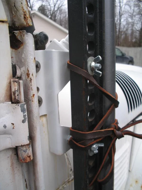

I'm told the thing I have on mine was made by Kaymar.
It attaches to the hinge.
This is good Tech. :)

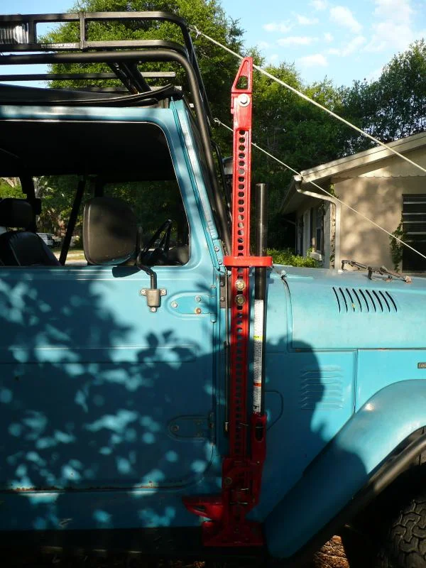

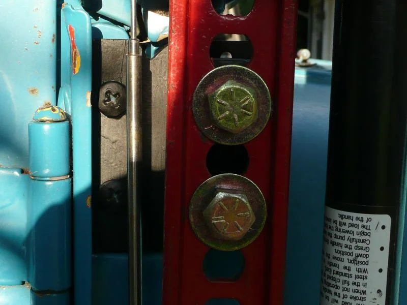

Here's my setup.
Custom bracket fabbed for windshied hinge.
The two pins on the sliders are a set of spring pins (big round head on a threaded shaft, and are threaded right inot the sliders. It works great, they fit right into the holes in the bottom of the jack - no trouble.
Hole drilled in pin allows a small lock - keeps the honest people from stealing the jack, a serious thief would requrie about 1 minute to bust my Master Lock padlock

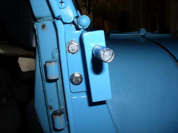

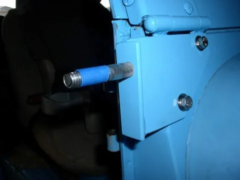

Made up another one for the new FJ.
Since it's got the old-school two-piece running boards, I decided to go for the full bolt-on, no-holes drilled approach.
Baseplate with two pins:
w/s hinge mounted shackle plate [I plan to put a couple of shackle bushings in between the plate and the jack, just didn't get there yet!]:
