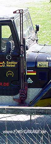

High lift jack mount on side of FJ40
hi lift mount
Here's another one . Saw it on a run out in the Panamint area ( CAlif ) I wish I had got the scoop on it but didn't. The indivual is in the Marines and I think back over in Iraq or else where

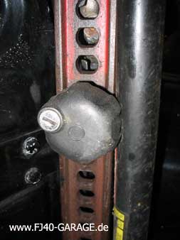

Into the side thread of the window hinge with a lockable screw.;)
This is one of the nicer ones I've seen! looks stable, clean, and most importantly when you need it you can get it without removing a lock, and a whole bunch of SAE bolts with nylock washers.
