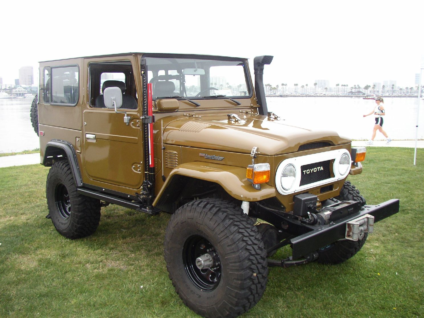

HI-LIFT mount on passenger side
Front mount as well. Can get a little bent in the rocks. I have turned it over since this picture for a little more "clearance".
I think I will be trying the passenger side runing board now though. I'm sure the jacks have a limit to the number of times they will bend.
