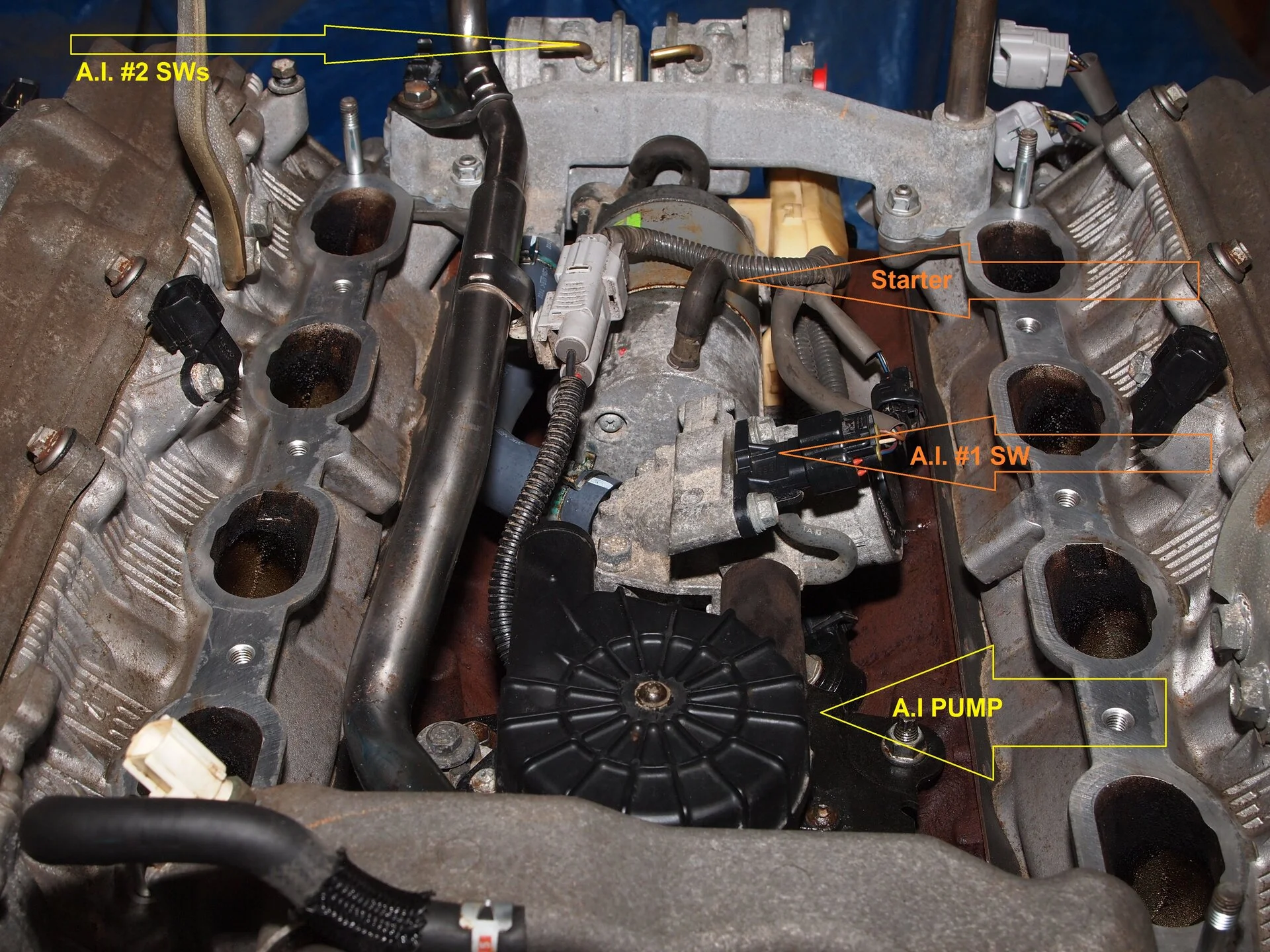

I have seen this installed in LX470 to bypass the secondary air injection mechanism. Does the 100 also have a Secondary Air Injection system?
what is the reason for this air pump, why does it fail, and what happens to vehicle if bypassed?

The primary reason for S.A.I. failure, is its air pump filter failure. Lexus recalled the GX for these same issue. The TSB stated: "Possibly" moisture as the cause of filter failure.

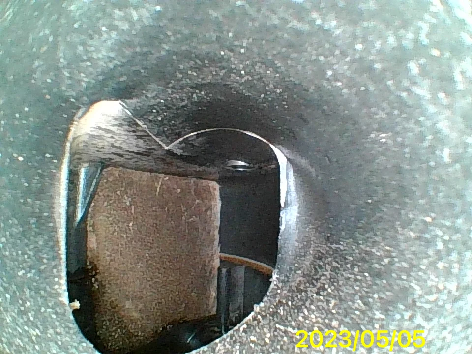

I use a bore scope, to look at filter in the Air Pump under the intake manifold.
This S.A.I. filter is still good:

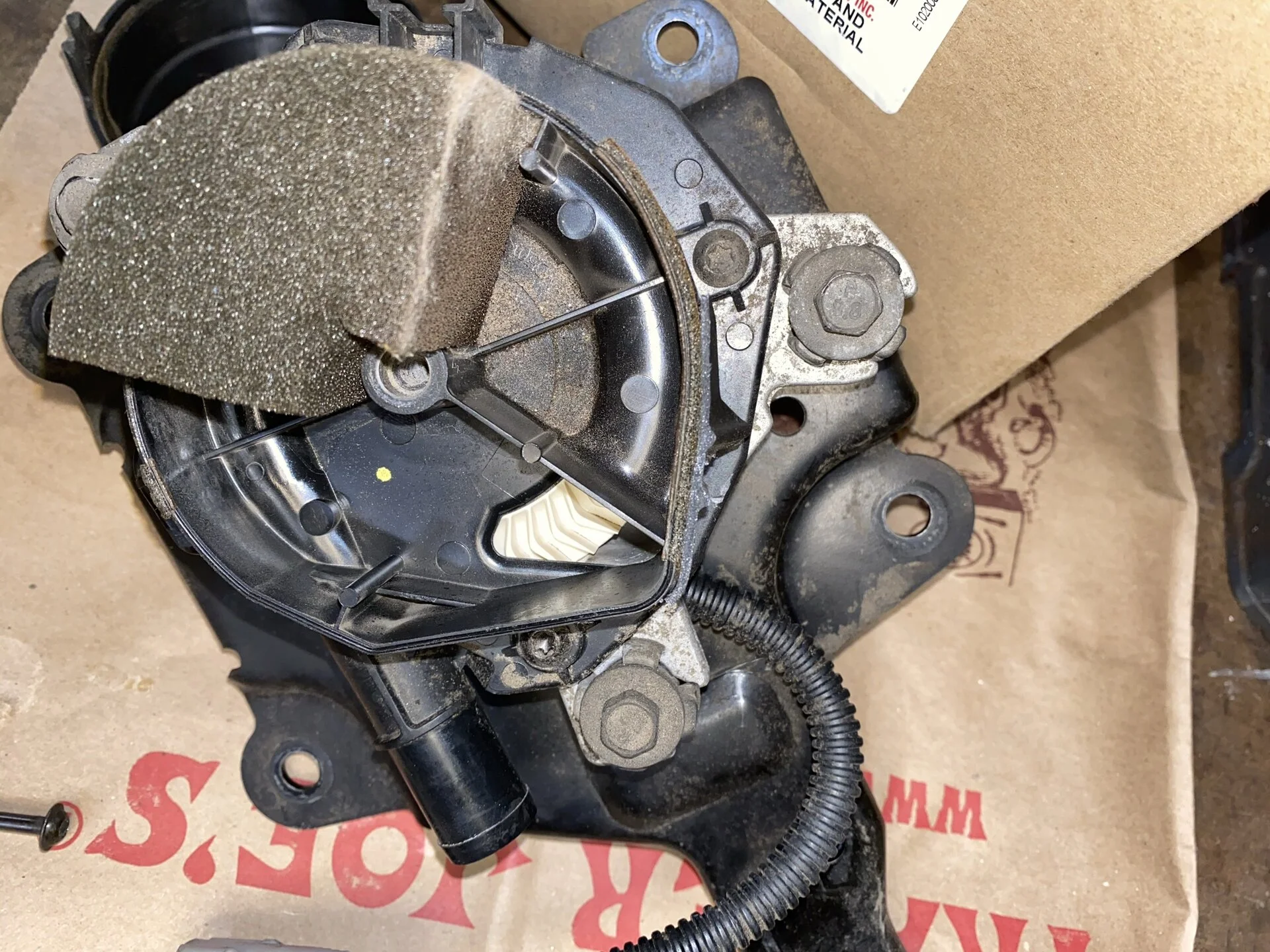

This filter failed (disintegrated),
This filter is still good..
