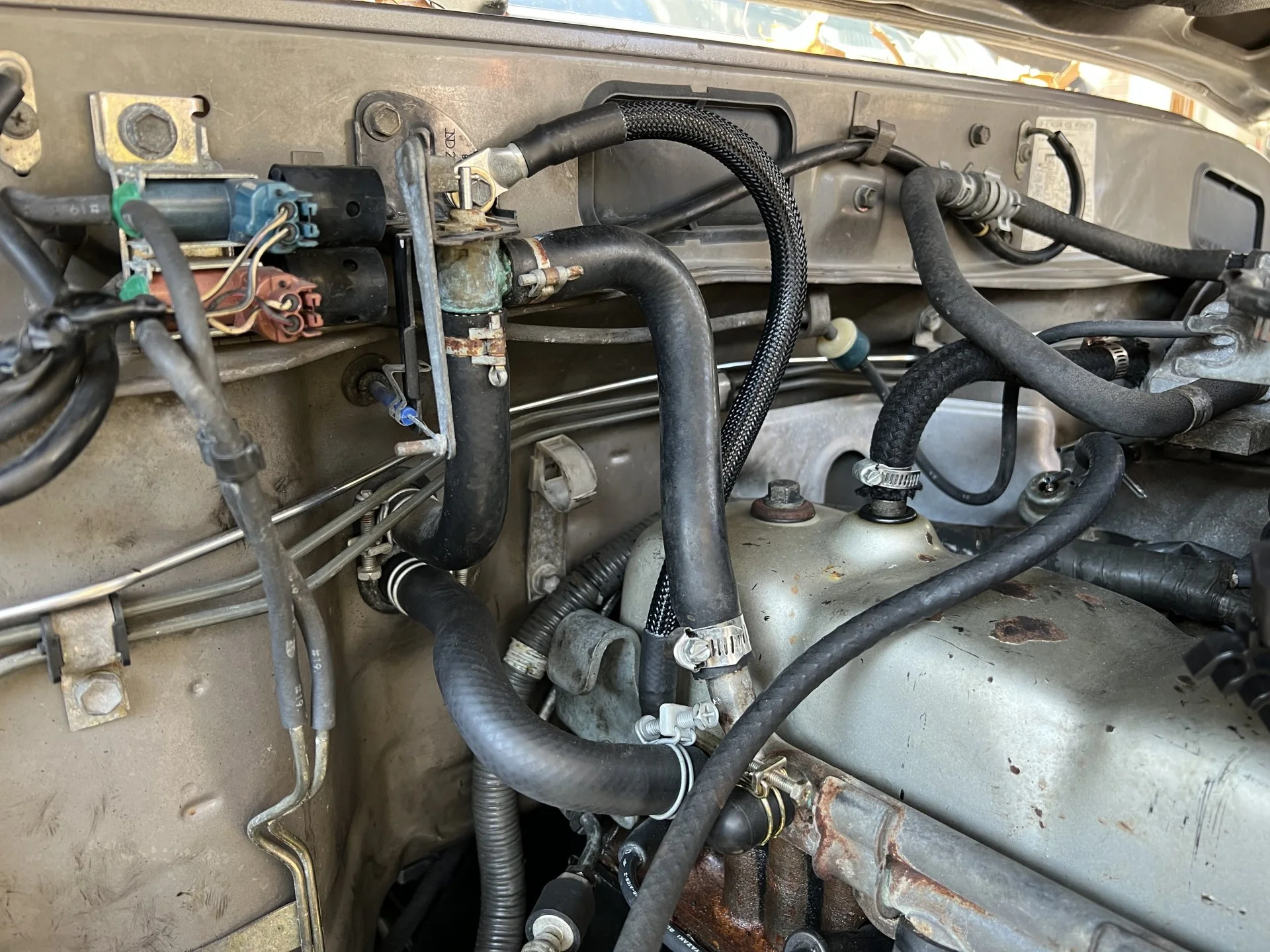

  • Vacuum system shows good vacuum (verified by @cruisermatt ): New Intake hoses, and pulling vacuum to make sure that was unlikely an issue

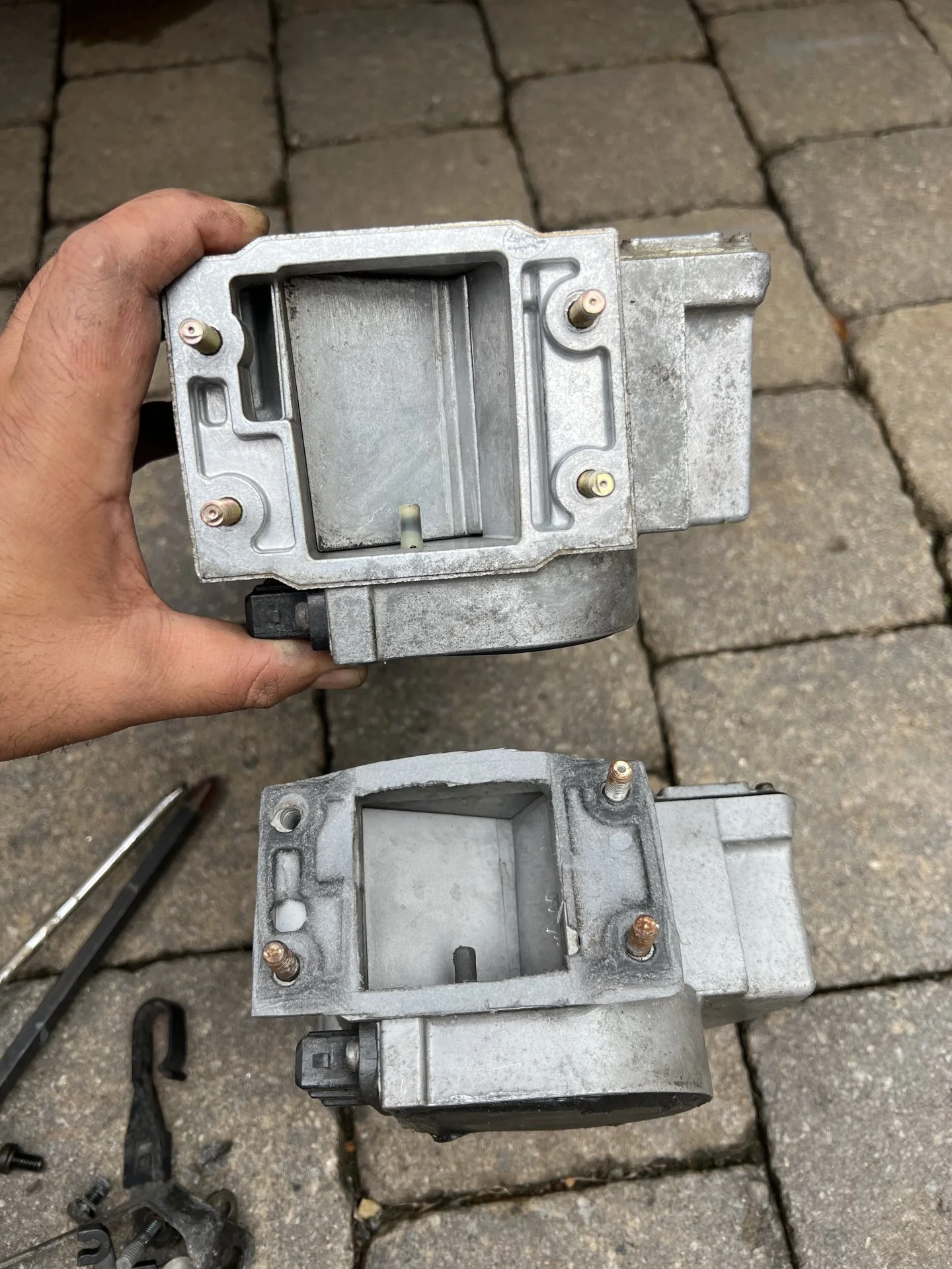

  • AFM has been checked based on FSM and passed all tests. It is not OEM FJ62, not sure what it’s from, but it was also on the rig prior to the engine rebuild (my understanding) and there wasn’t an issue with it. I do have a 1993 Toyota Camry AFM that I am going to be cleaning up and popping in to see if that helps (got it from a local Pull-a-part)

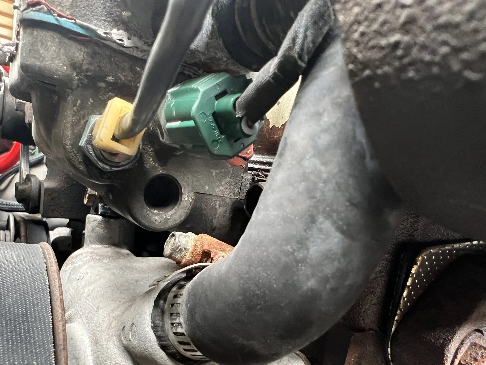

  • I see new-ish sensors on the Thermostat housing, and I will assume they were replaced during the engine rebuild but I have not run any tests on them.

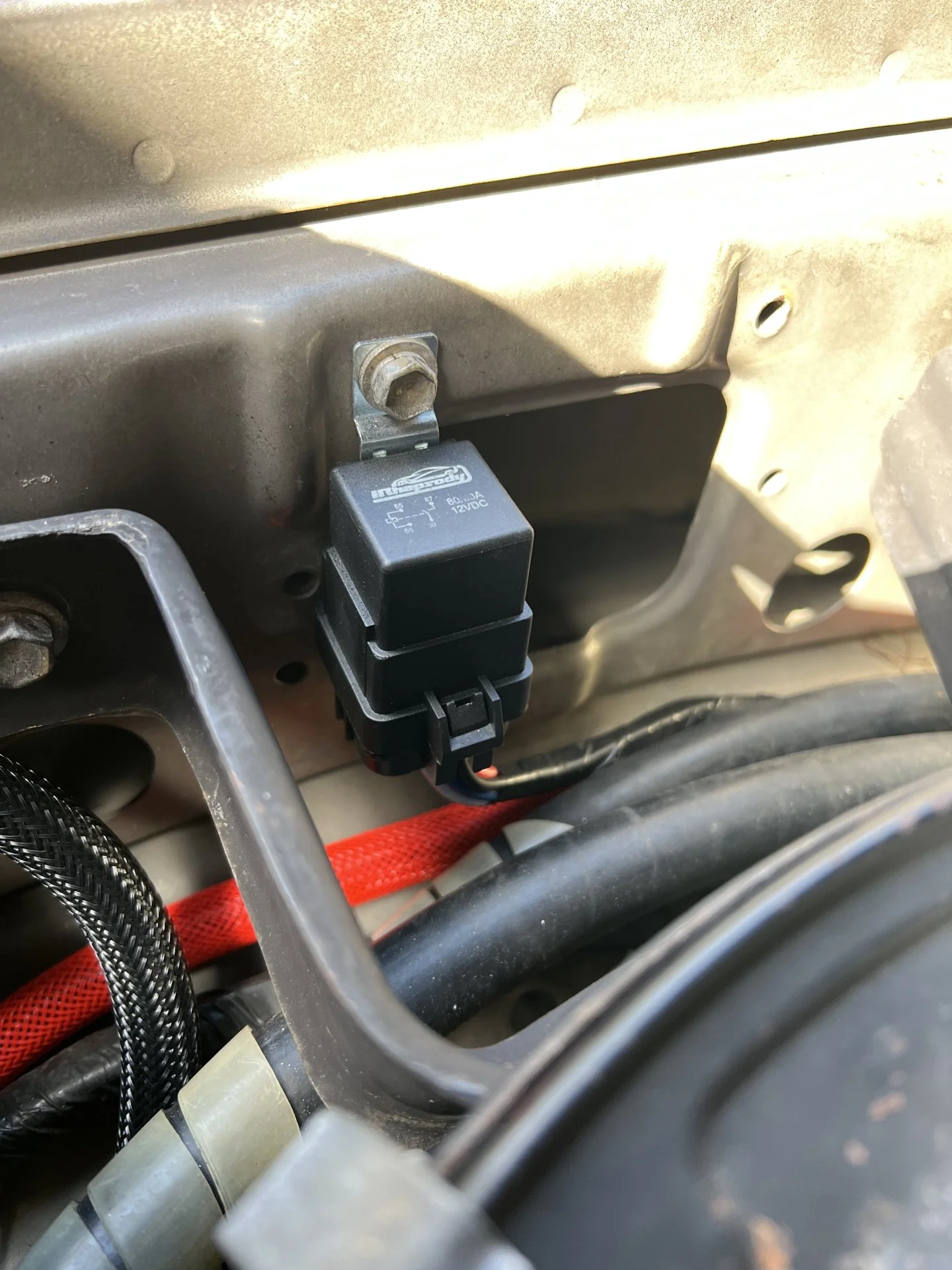

Also EFI Relay was replaced and fuel pump relay under passenger side dash has been replaced.
Major vacuum leak like the intake manifold bolts are loose? You mentioned head work.
Vacuum is strong and consistent… last person to verify that and the fuel pressure being great was @cruisermatt last week before it left his place. He also experienced some of the hesitation / stumbling. He mentioned that during one of his drives, when it started doing it, he pulled off into a field and bounced around a bit and it stopped doing the hesitation… that along with the video of me revving in neutral are more anecdotal and not necessarily repeatable, but just notes to help frame the issue…

  4. Test and possibly Replace the EFI relay that we installed in lieu of the NLA EFI relay

I had the AFM sitting here already so I went ahead and did that this AM
The "stealer" suggested I replace the AFM. I did, but it turned out to be the TPS. Throttle Position Sensor. Fixed everything.

Check/test temp sensor on thermostat housing per FSM.
I had one go bad on me, similar behavior.
New unit fixed it right up.
Beware, there are different part numbers for this part between the FJ62 3FE, and the early 80 series 3FE, if I recall correctly.
