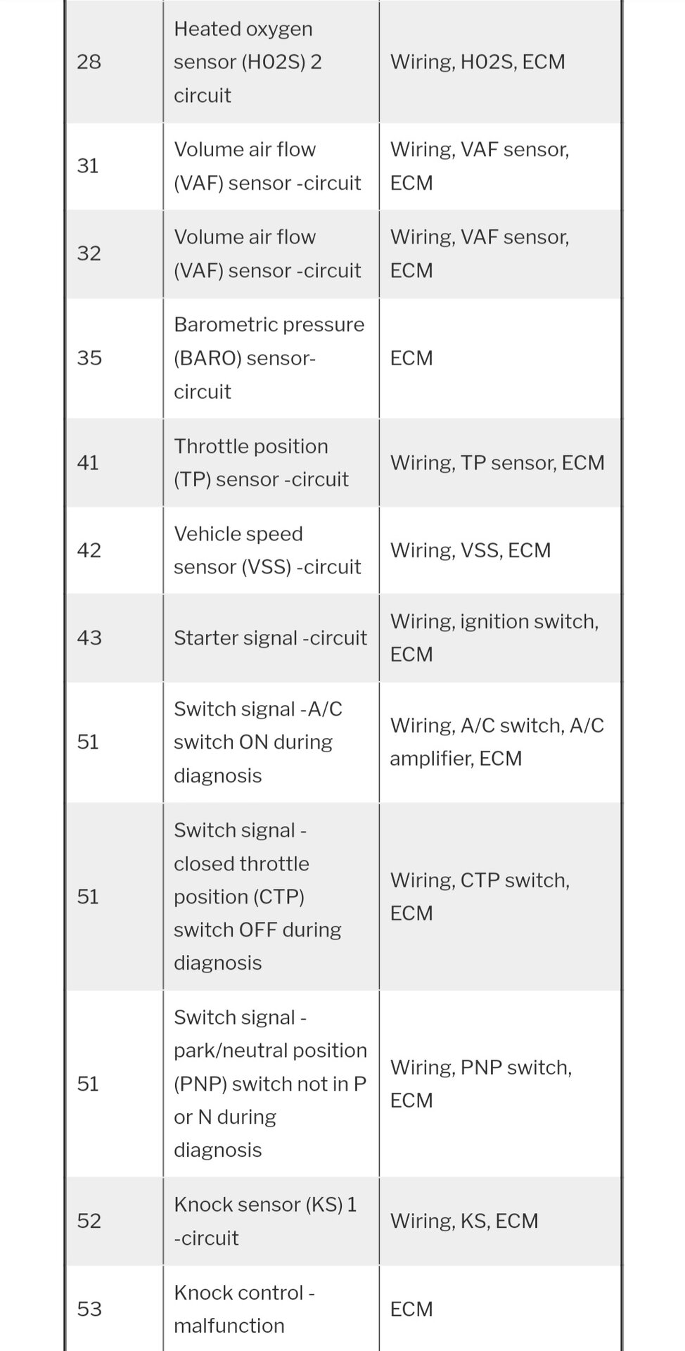

Is this a 17 code? I have this list of codes and I wonder if its 17 or 71? I'm confused. Isn't the first blink a "10" and the rest units? TIA
I tried to upload a video but somehow it didn't let me. Anyway, it blinks once then stops and after that 7 times.

Thanks for the reply. There is a blink and then a second delay, after that 7 consecutive blinks non stop. I did it several times and same result. I will try to upload the video
There is no symptoms, just the light turned on and I want to know why. Finally its a 1992 Land cruiser 3FE engine. It runs good without issues.

I did a quick search and didn't find any corroborating info for a code 17. A code 71 is fairly common. I did find the above info on a post from a very knowledgeable member and I would try it to see if the code is a hard code or transitory.
It looks as though you already know the procedures but here is my synopsis of what the FSM (download from resources section) says for pulling codes.
When the check engine light shows up in your 1990-95 Toyota vehicle, the quickest way to get the code is to access the diagnostic connector in the engine compartment (sits on the passenger firewall). Connect a jumper wire between terminals TE1 and E1 terminals and by turning the key on, it will start flashing the codes in your dash.
If there are no codes, the check engine light will flash 2 times per second CONSTANTLY with no patterns or pauses. If there are any codes, it will be shown in 2 digits codes. Example: code 24 is shown as 2 flashes, a 1.5 sec pause followed by 4 flashes. If there are mode codes, the next one will transmitted after 2.5 seconds. When finished reading the codes, turn the key off and remove the jumper wire.

The 3FE ecu has no code 17.
I posted the codes and yeah no 17 which led me to think it was a 71 but just for a reference to others it only makes sense to be a 71 although the cruiser runs good even if the light on.
Now to the fix. I guess I can start by checking all hoses for leaks but any of you guys have had to fix the code 7, it'd be great to know what you did to fix it. TIA
