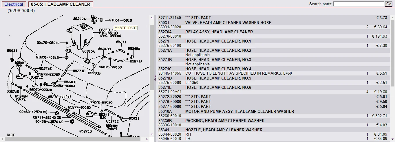

I read here and searched here all the posts relevant and in the end i ordered the Valve
but when i popped the hod i discoverd the PO conecter the washer pump to the front window sprinklers
ALL THE REST IS MISING
i canot find a diagram of the system with had lights, front and tail sprinklers
I love the Rig as OEM as possible
Many of us have found that the diverted valve fails after 20 years or so. It is cheap and easy to bypass it and only wash the front glass. I do not care about washing my rear glass.
I have seen this scheme, but what I don't understand is is this a separate water tank? or connected to the same tank as the rest of system?
so when i oprate the front window the hadlights get water too
Yes there is but one tank, and I get snow and ice I like a rear window washer
